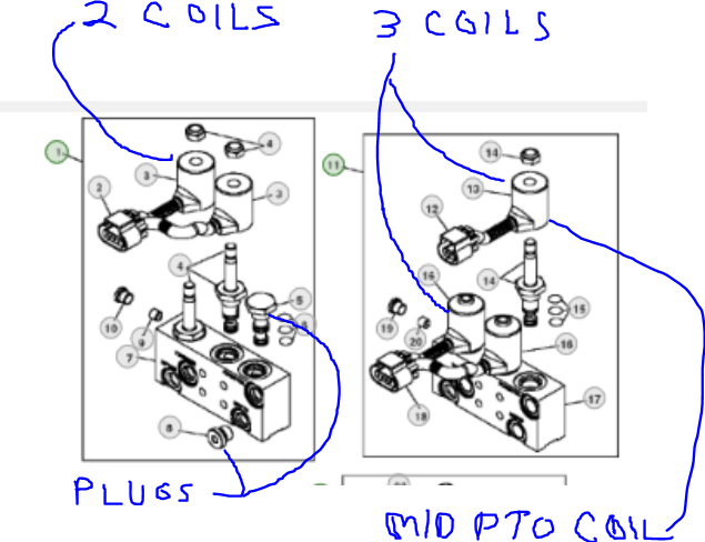

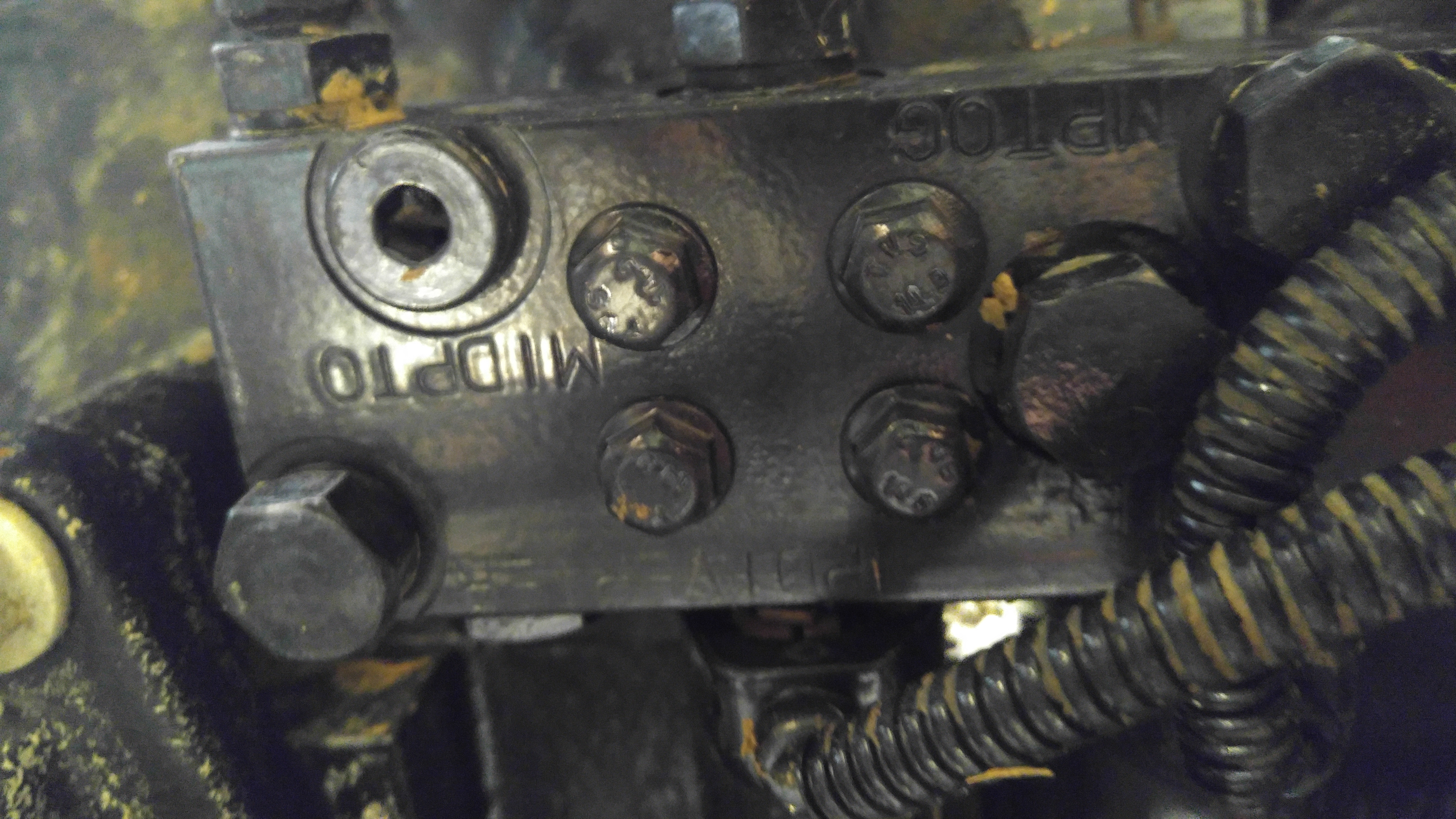

If the tractor does not have a MID PTO, I am not sure why they have the "MID PTO" written shown on the photo below? is that an option you can add or no? Why is the "MID PTO" Labeled on the block?
That same manifold is used whether or not you have mid PTO. Also if you did not have 4wd, that section of the manifold would be blank. Left drawing has two coils, one for Main PTO (rear) and MFWD (mechanical front wheel drive) Right drawing has third coil for Mid PTO. Also notice plugs in left drawing since no Mid PTO
Drawings are from JDparts.com, they can be great resource!
