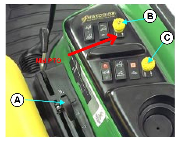

Back on the mid PTO question I will add a couple of photos that may help you determine if you have it or not.
Tractors with the Mid PTO option will have two PTO switches on the console.
Underneath the tractor you should see a splined shaft facing forward.

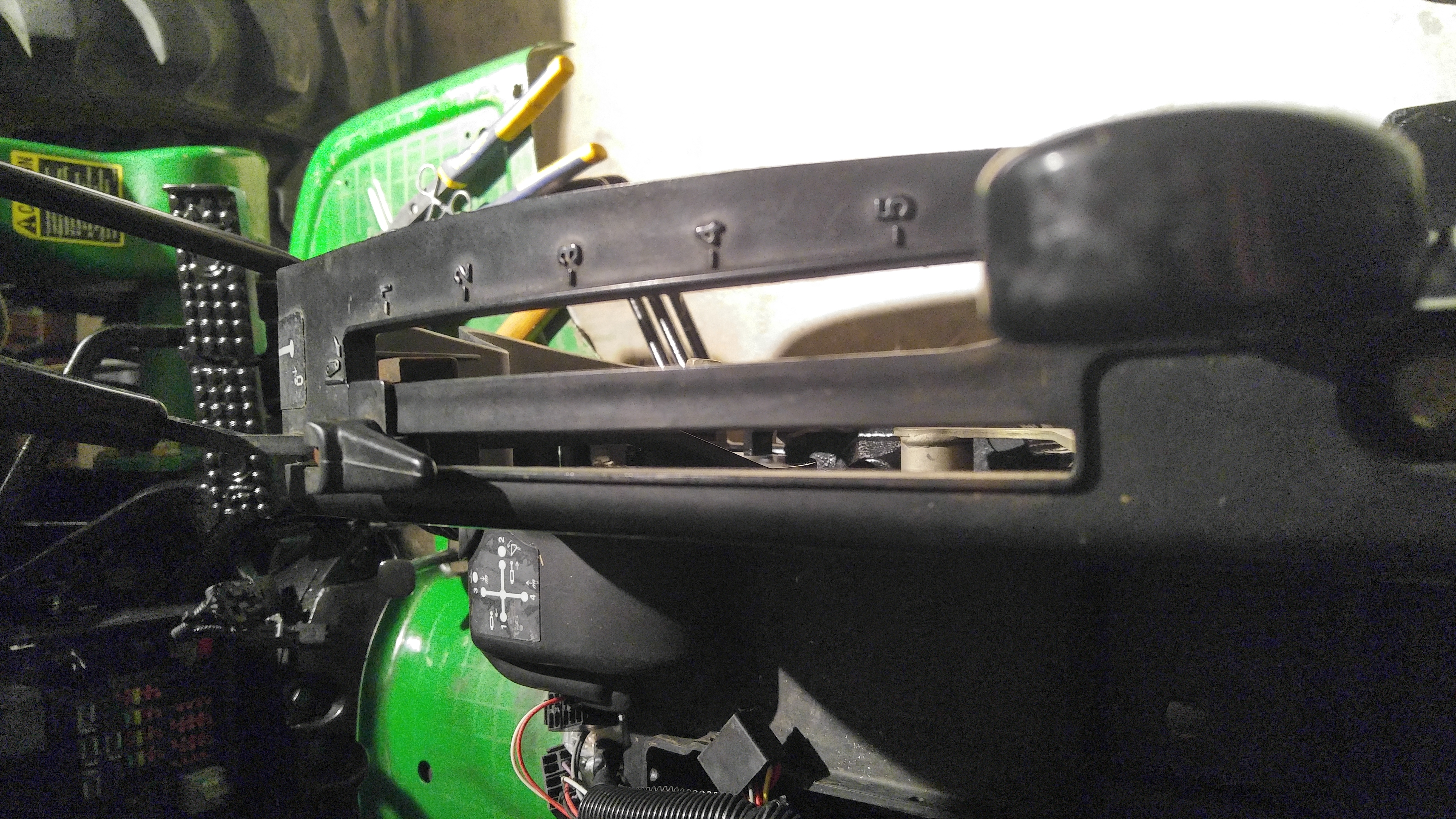

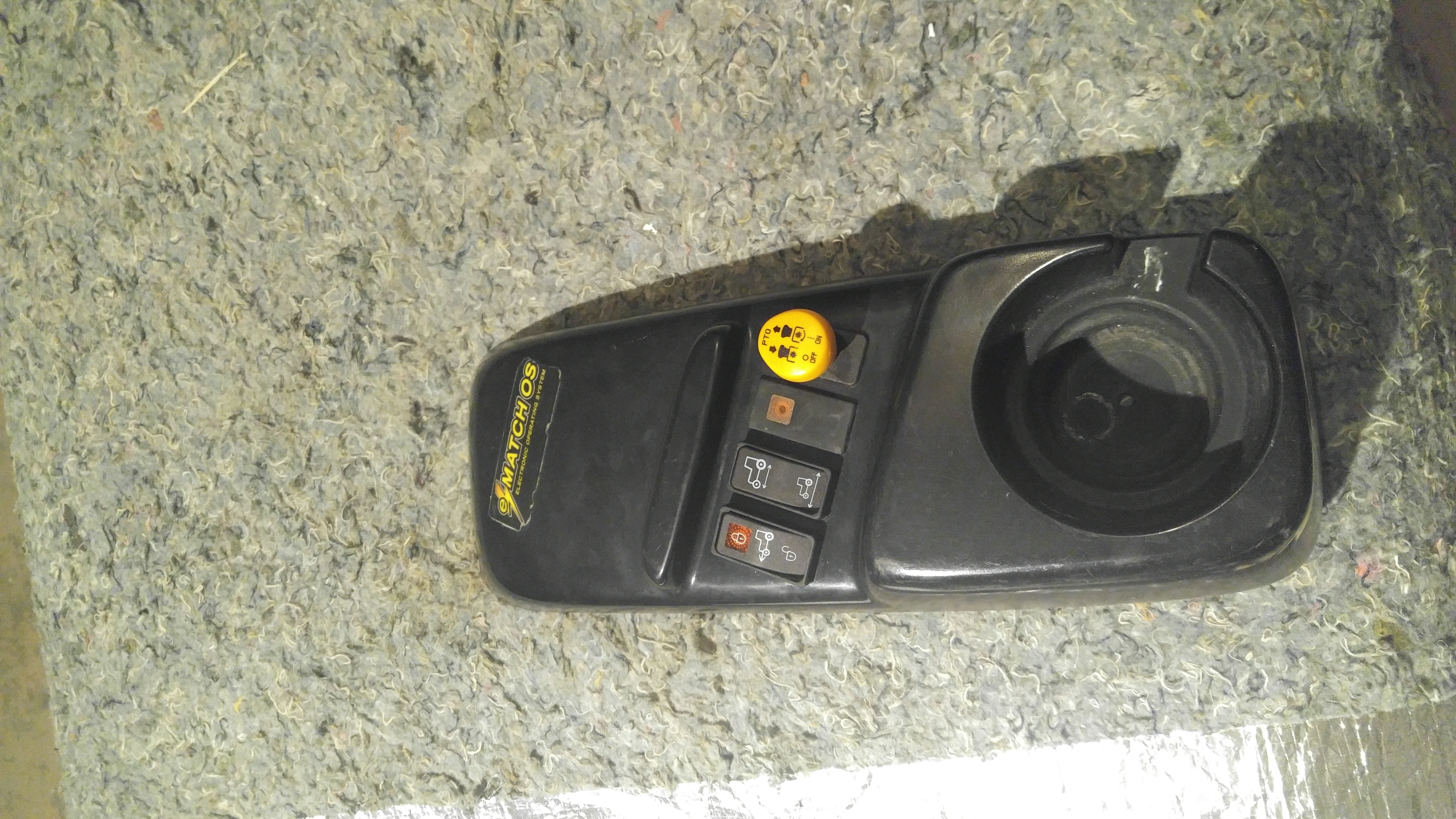

This is what our console looks like with only the top row of switches. Also the additional photo of the lever.

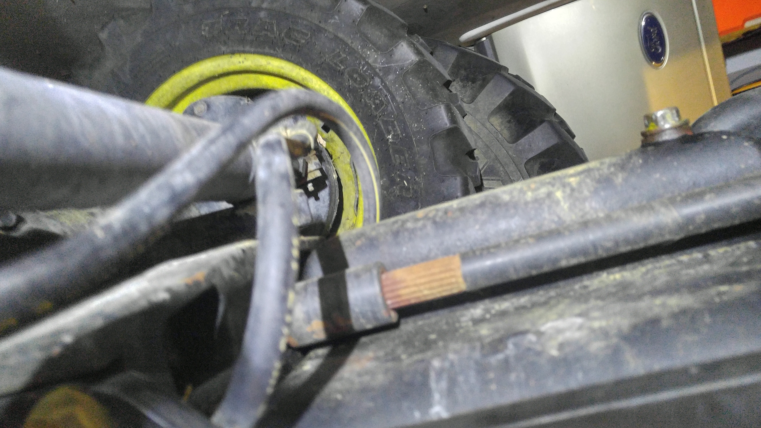

I am not sure regarding the splined shaft. This was the only thing I could seem to find, which I am not sure what it is
That shaft drives the front wheels for the 4wd..
You likely have no mid PTO now. Are you needing a mid PTO?

Just to let you know the top 2 switches on JD855guy's picture is the speed control. It is a cheap and easy option to add. It is useful when cutting grass.
   / John Deere 4310 spool valve & top-Tilt, Power Beyond kit #27
I think the OP has a shuttle trans. Cruise Control is just on the eHydro.

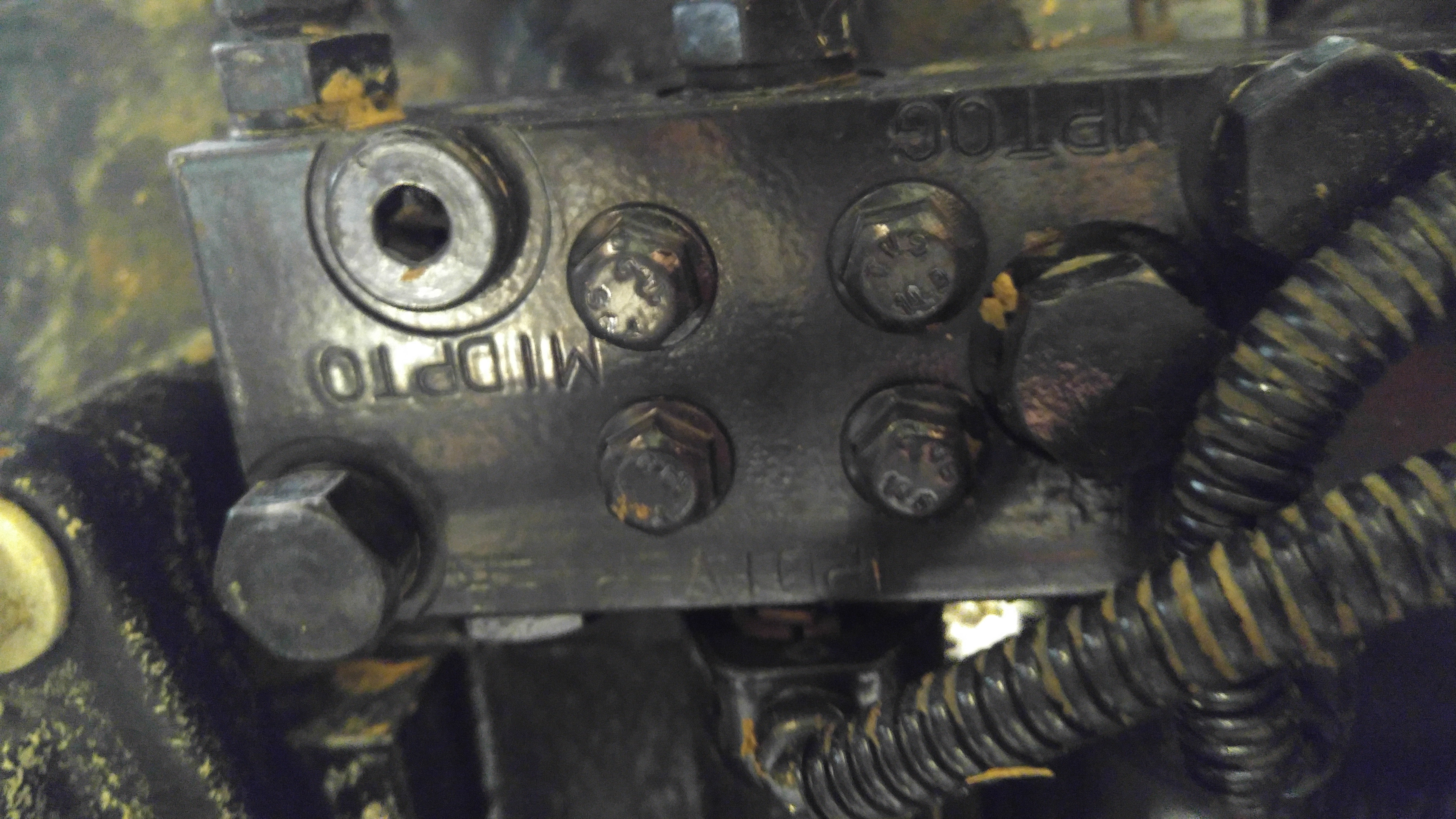

Looks like your tractor was not fitted with the optional mid PTO. John Deere has substituted 3 different kit numbers from the original kit #LVB25291. About $2550 for the parts.
Interesting that JD put the extra PTO switch under the panel. Bet mine has one there too. I was reading in the operator manual that the rear PTO is always on when using the mid PTO on this model. Makes me wonder why they even had a second switch.
If the tractor does not have a MID PTO, I am not sure why they have the "MID PTO" written shown on the photo below? is that an option you can add or no? Why is the "MID PTO" Labeled on the block?
