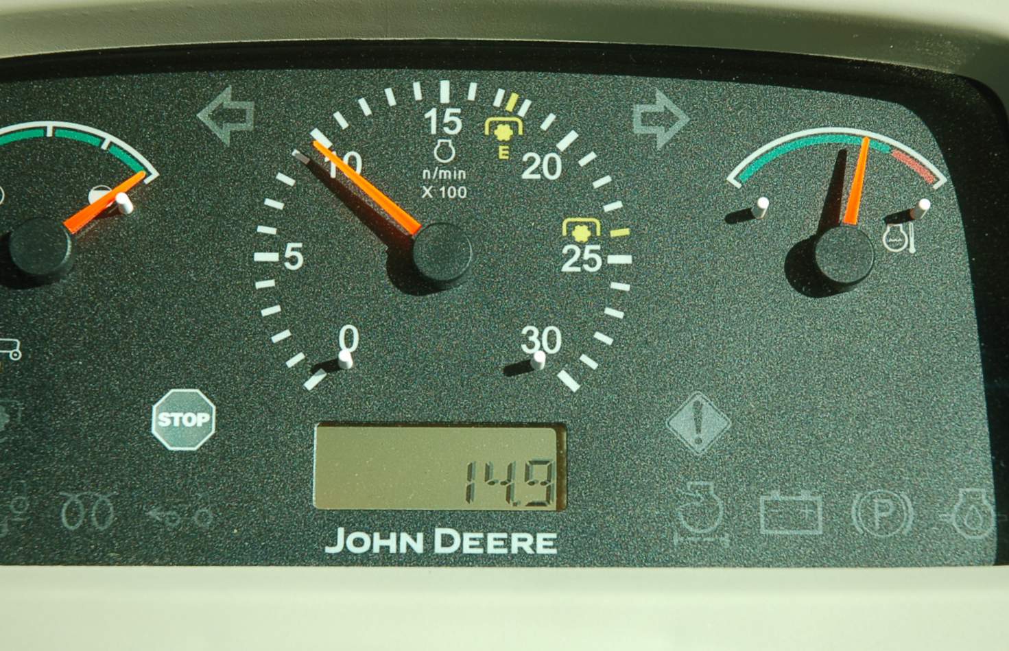

Just took delivery of a new John Deere 4720 cab tractor. Nice tractor although it came from the factory with two issues. 1. the temperature gauge in the instrument panel shows a consistent hot temperature reading, very close to the red zone. After thorough testing by the dealer, indicating that the motor is not really running hot, and the dealer noting that other 4720's have the same issue, the official response was "just run it and don't worry." Still, it's disconcerting to view the gauge always running so close to the red line.

Following is the official response to my query from John Deere's customer service department:
Per our discussion earlier today it is normal for the temperature gauge to read above the 1/2 mark, this is considered normal operation for your 4720. There are some tests your dealer can perform to ensure your unit is operating properly, but I believe you said the dealer has done these test and stated your unit is working as designed. If that is not the case please let me know I will give your dealer a call.

Needless to say I am very dissapointed in JD's customer service and this trite response. Take a look at the attached photo of the temp gauge. Does this look "NORMAL" to anyone?

Looks normal to me, from your description in the first post I expected to see a higher visual reading. The response from Deere seemed alright too
/ John Deere 4720 temperature gauge problem #8
I have a 4520 that runs in the same temperature range on the gauge. Same dealer response as they gave you. I used a IR thermometer to check various temperatures, particularly looking for hot spots. Found no problems, so I have "just been running it."
/ John Deere 4720 temperature gauge problem #9
I was thinking it was pegged. That's where my fathers 4720 runs at. Now that that's outta the way, what's up with the ac?
/ John Deere 4720 temperature gauge problem #10
Same here; my 4520 runs the same way. My dealer told me upfront that this would happen. I believe he stated that the PowerTech engine needs to run hotter for the Interim Tier IV emissions control and it will not harm the engine.

It would be of concern to me also. A few minutes of hard work and the needle will then be in the red, then what?
/ John Deere 4720 temperature gauge problem #13
Not necessarily, I have worked my 4520 pretty hard and the temperature guage holds steady.

Well, I guess it's time for me to throw in the towel on this one. It's just that I've never had a machine that ran past the half way mark, ever, in 50 years of buying anything on two, three, or four wheels. This is a first. Everything else about the machine I like, now that the AC is fixed. My trade in was a good running 4710 JD, and it's temp gauge never went above the 1/4 mark. I think that difference is what really surprised me when I took the wheel of the new 4720. Thanks everyone for your input. What a great resource you are !

My new 4120 runs in that range which concerned me at first as my old 3320 ran about 1/4 on the temp gauge. Was told the powertech deere engines are designed to run hotter than the yanmar engines found on the 3000 series. Anyway, love the tractor so far and have had no issues the turbo really provides a lot of grunt on these engines.

Your 4710 had a Yanmar engine and the 4720 has a Deere engine so I wouldn't expect the reading to be the same.

I too was expecting the gauge to show higher. It looks like mine did on my 4720. I think everything looks fine.
