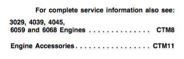

OK, I now have a PDF of the TM1520 manual.
But why, on the very first page, does it indicate that CTM8 is the correct engine manual, and not the CTM125?

Charles, I'm not at home, so I can't read it, but I have the CTM8, it should be on the way to you. I can send it, just can't read it to see. Hope it helps
Joe
