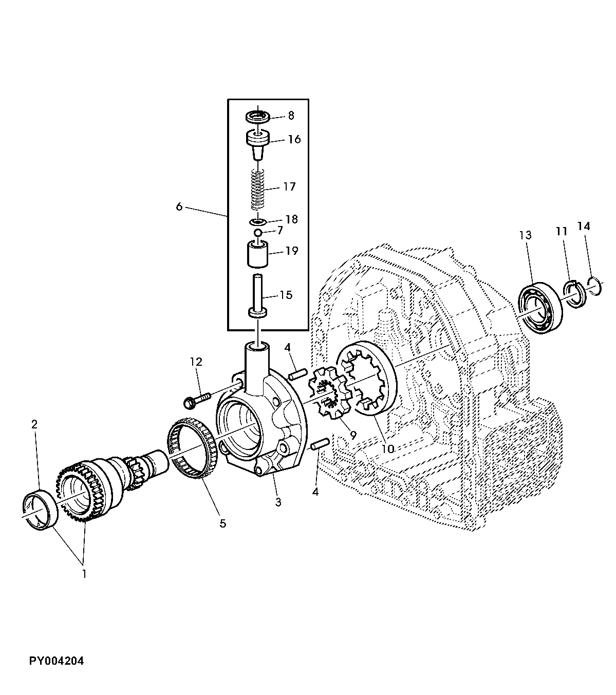

I pulled the relief valve out. Looked ok. Spring free length measured fine. Started tractor for a second and fluid came out. Put back in and still no lube pressure. I may have turned shaft in wrong direction when tightening bolts. But manual does not say that is not ok. I'm thinking the front needs to come off.
   / John Deere 6410 won't move #29
From jdparts drawing key 6 is called out as "pump repair kit" This is the trans pump for the power quad trans
   / John Deere 6410 won't move #30
That pump repair kit is not for the oil pump. The trans pump is actually a double pump. The gears pump oil for transmission pressure. The plunger assembly in that kit pumps air. There is a plastic line that connects the front housing to the rear housing. The air pump pushes air pressure to the rear housing to push oil out of the rear housing to prevent excess oil churning in planetary gears.
