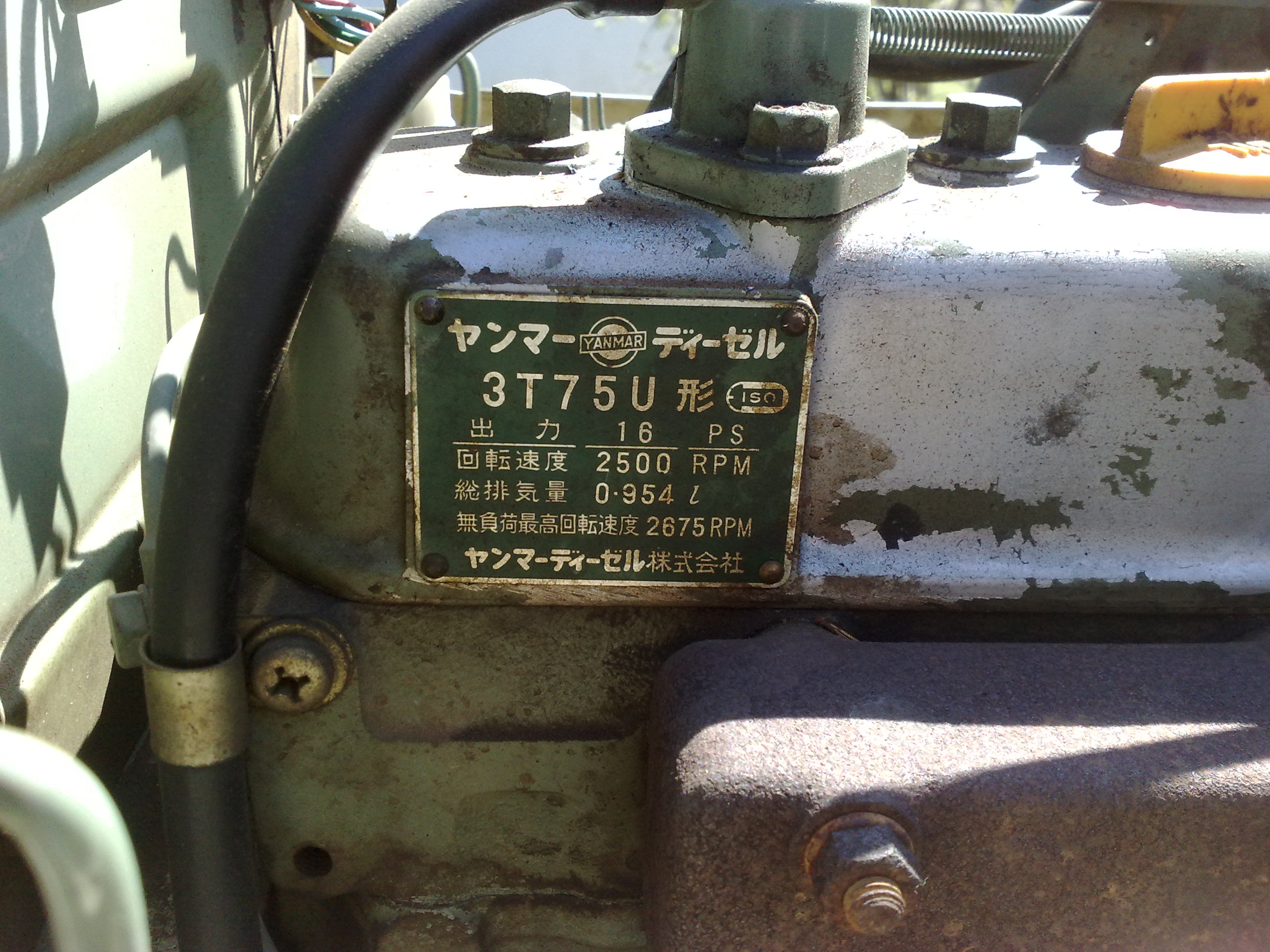

Look at this! it is from my 1610D.
The 3T75U in the Yanmar has 954 ccm. If you have a John Deere with a yanmar Engine there is a "J" behind.
Originally Posted by winston1
jlinn1, The john deere 750 has a 3t80uj engine, 78.2 ci, 1281 cc. I think your 1610 has a 3t75u engine, don't know cubic inch.
Stefan

   / John Deere 750/850 vs. Yanmar 1610D 1820D eg. #40
i dont think the letters at the end of the engine model is the engine bore in MM's. Maybe the last number ie. 80 is the bore in mm's
You're right...I transposed letters to numbers so, whoops. The last two numbers ARE bore size.
