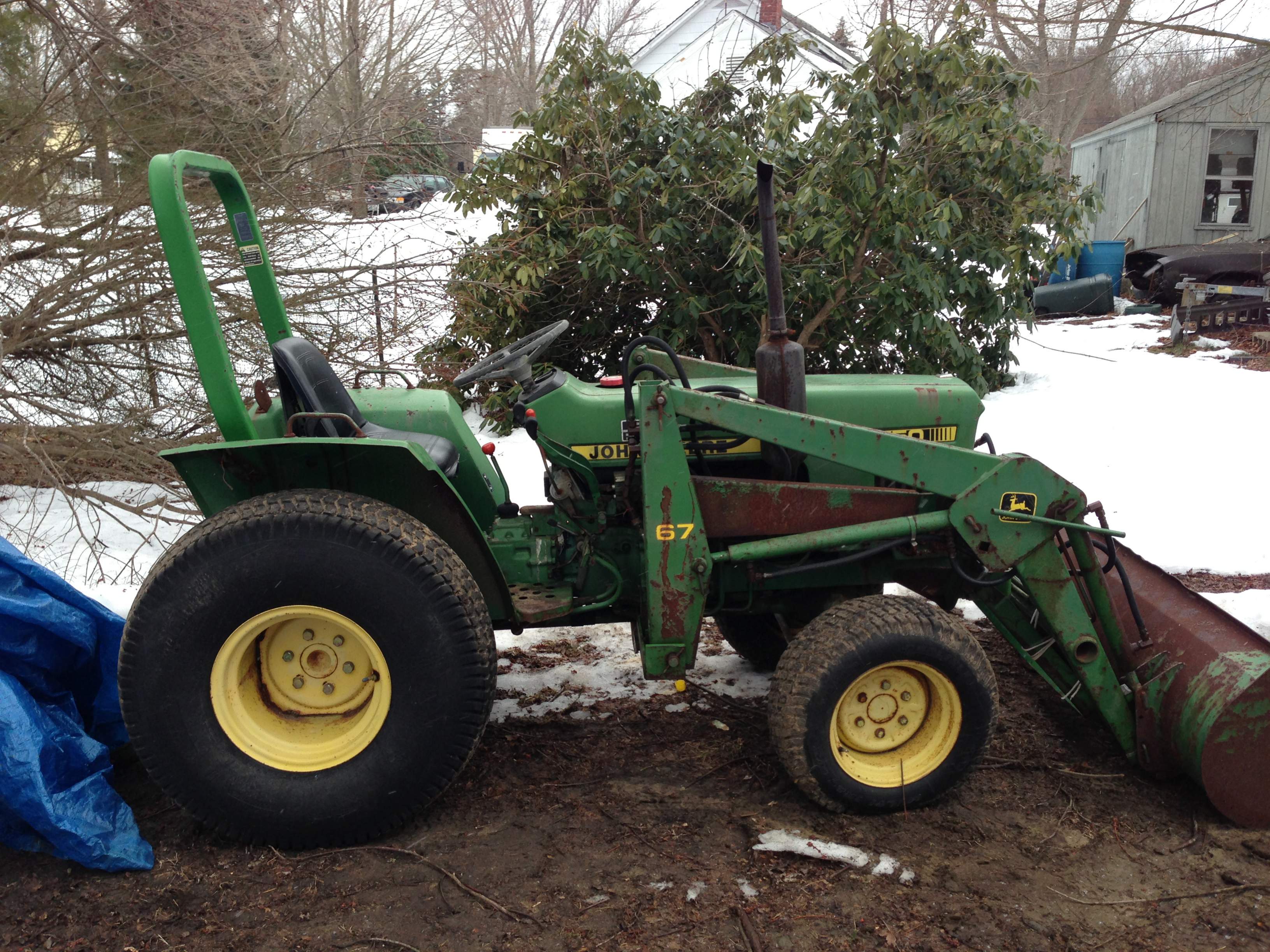

I have an opportunity to buy a 750 4wd with low hours for $2500. Hydraulics on the lift running really slow. new turf tires. I'm thinking it's a great deal for the price. What do you guys think?

I've seen these with no loader for 6K and good ones with loader for $7900. Slow hydraulics could be a myriad of things from too little fluid (leak) to dirty or clogged filters and screens, to bad pumps. You are buying it low enough to fix anything as long as parts are available.
/ John Deere 750 with loader #6
I owed a JD 750 for a number of years and if memory servers me correctly only units with the optional power steering came equiped with a hydrualic filter. All the others relied on a screen which can become clogged and thereby restrict flow. That is a really low price, so even if a bit of work is needed you should be still ahead of the game.

FYI... When it was cold (<30F) out the hydraulics on my JD750 4x4 with P/S were extremely slow. After it warmed up for 5-10 minutes everything would run as normal. Looking back I might have been wise to change the hydraulic fluid to some of the newer synthetic ones that flow better at lower temperatures. For the record only tractor supply brand (Travelers?) fluid was used in it. Perhaps it is just suffering the same fate.

I bought the tractor and I was able to get bush hog, a post hole digger, and a box blade for a REALLY good price. Now I need to get the hydraulics figured out. It does have power steering but not workind since it has no hydraulics power at all. I checked the fluid level, the filter and fluid was changed in the summer (according to the pervious owner) and the screen cleaned. what can I check next? How do I check to see if the pump is working? the stop valve is rusted in place so I can't turn it on/off. I know when I take the dipstick out to check hydraulic fluid level, it makes a sound of sucking air like it's breaking a seal. Like a vacuum was created and i'm releasing the pressure. The loader does not move up or down. Any suggestion would be great.

Given hydraulic fliuid for this tractor is relatively cheap, I'd drain the fluid and doube check the screen and purchase a new hydraulic filter just to verify everything is clean and OK. Maybe the wrong fluid was used (this would be a very long shot, and more likely if it was hydostatics issue,but yours is gear drive). For the record I never remember mine making a sucking noise when the yellow fill plug was removed while running. Is the fluid level correct?
Does the power steering work? Mine seemed to be overly boosted meaning it was very easy to turn. I would have liked it to be a little less, so more fluid would be routed to the FEL or 3-pt hydraulics. Perhaps the diverter valve located on the starter side of the firewall is the issue. Since PS and FEL hydraulics are shared the diverter valve seperates the flow proportionally between the two hydraulic circuits. I personally think this i a very long shot though...
The manual is well worth the cost. It has very detailed photos for each major step and contains color coded schematics of the hydraulic circuits. I gave mine away when I sold the tractor.
How about checking hydraulic pressure to see if it is OK. Perhaps the relief valve is stuck open and simply bypassing most of the fluid back to the reservoir. Maybe run a flow test by timing how long it takes to pump a gallon or so. (be very careful with high pressure fluid)

After talking to a JD service shop and him telling me that it cost $70 an hour to diagnose the problem, I decided to go and check out the screen. To my suprise, the guy had never cleaned it. It was full of gunk! I replaced the fluid, filter, and cleaned the screen and the hydraulics are working perfectly. Thanks for everyones help.
