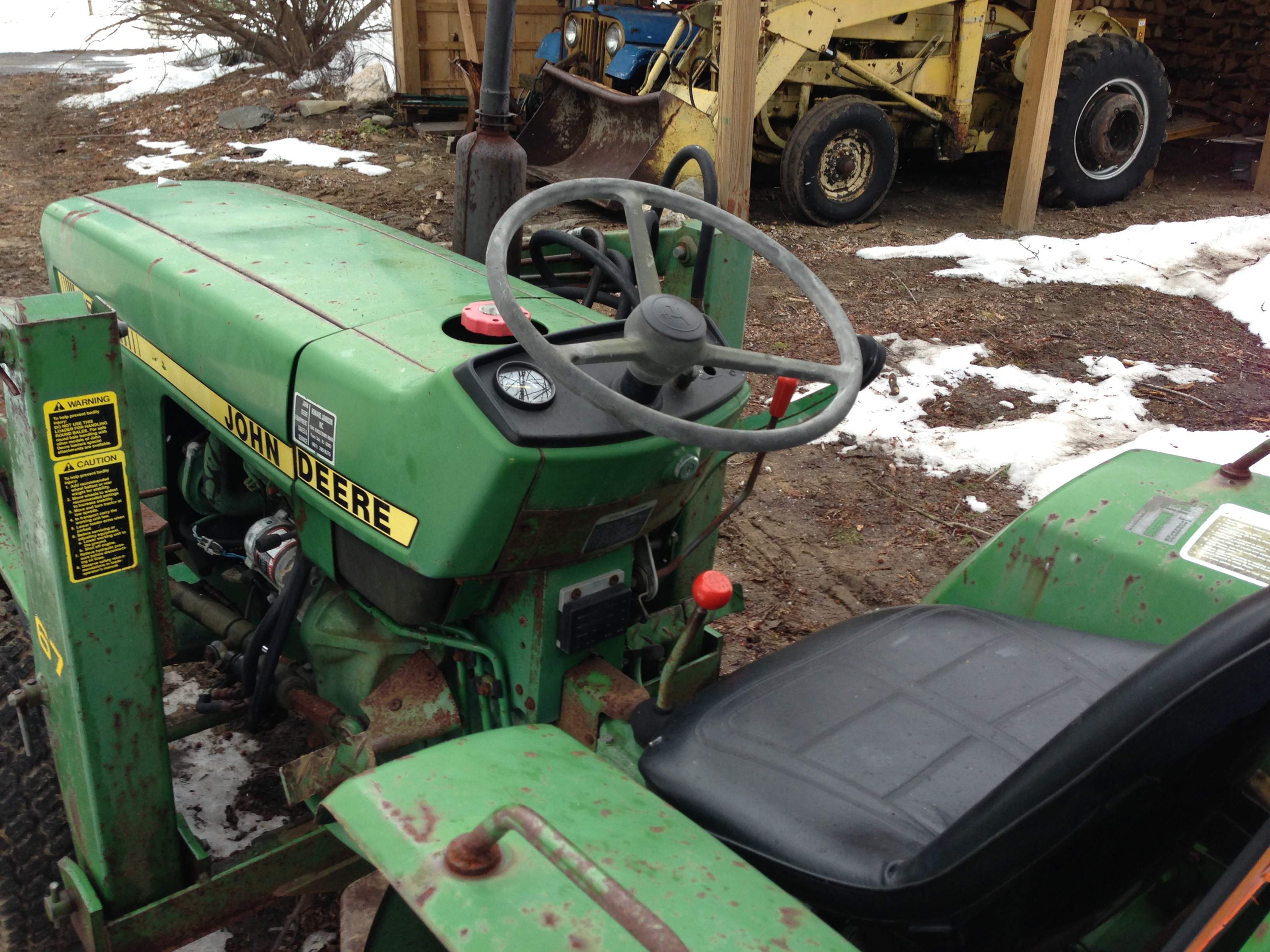

I bought the tractor and I was able to get bush hog, a post hole digger, and a box blade for a REALLY good price. Now I need to get the hydraulics figured out. It does have power steering but not workind since it has no hydraulics power at all. I checked the fluid level, the filter and fluid was changed in the summer (according to the pervious owner) and the screen cleaned. what can I check next? How do I check to see if the pump is working? the stop valve is rusted in place so I can't turn it on/off. I know when I take the dipstick out to check hydraulic fluid level, it makes a sound of sucking air like it's breaking a seal. Like a vacuum was created and i'm releasing the pressure. The loader does not move up or down. Any suggestion would be great.

After talking to a JD service shop and him telling me that it cost $70 an hour to diagnose the problem, I decided to go and check out the screen. To my suprise, the guy had never cleaned it. It was full of gunk! I replaced the fluid, filter, and cleaned the screen and the hydraulics are working perfectly. Thanks for everyones help.
