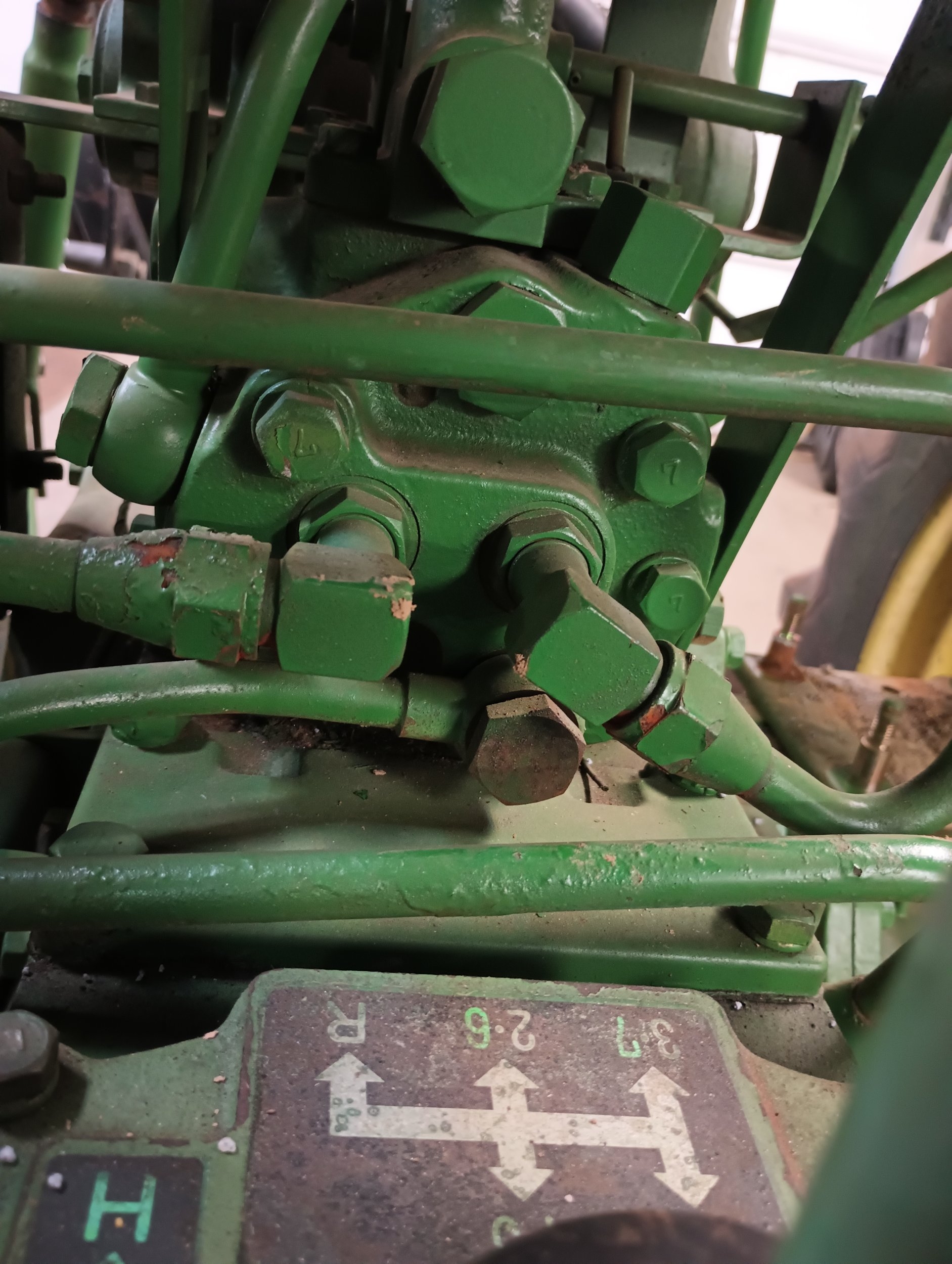

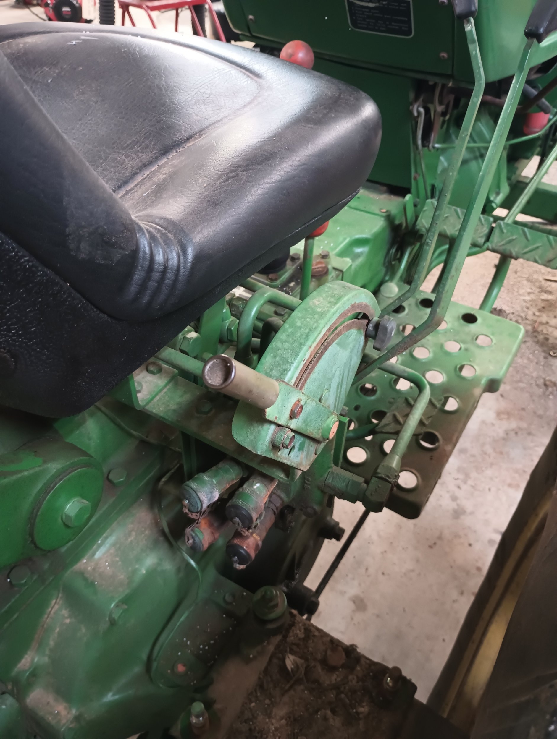

I recently purchased an 850 with factory dual remotes. I'm a large person and the levers hit my leg. Additionally, both valve bodies are leaking. I want to delete the remotes completely. I only run a mower and have other machines with loader.
I've found the replacement "cap" that has no ports. This deletes 2 of 3 lines. The line on the left side gets plugged. Is there anything I'm missing? I might sell the kit and I want to be sure the next guy gets what he needs.

Are you big and tall too? It might be best to raise the seat some.
The Yanmar YM2500 is the same machine as the JD850. One is red, the other green.
Here is a person who is big and tall. His solution was to raise the seat.
WHY mess with pipes and fittings over 40 years old? The chances of having forever leaks gets higher.
Then burping out all of the trapped air pockets is a real pain on these machines.

Thanks for the reply. I like that idea for pedal room but does that Yanmar machine have remote levers? Maybe its an optical illusion but I only see a lift lever. Mine looks like this. Note the location of the left lever.
Anyway, I'm already leaking from both valves so I'll take my chances on removing some lines.

The Yanmar lift-lever is just like the Deere 850/950/1050 traveling on the top of the curve. It's worse for the seat. Your lift-lever is on the side of the swing. Having the seat a tad higher would keep the lift-lever as-is and a tad longer to reach.
