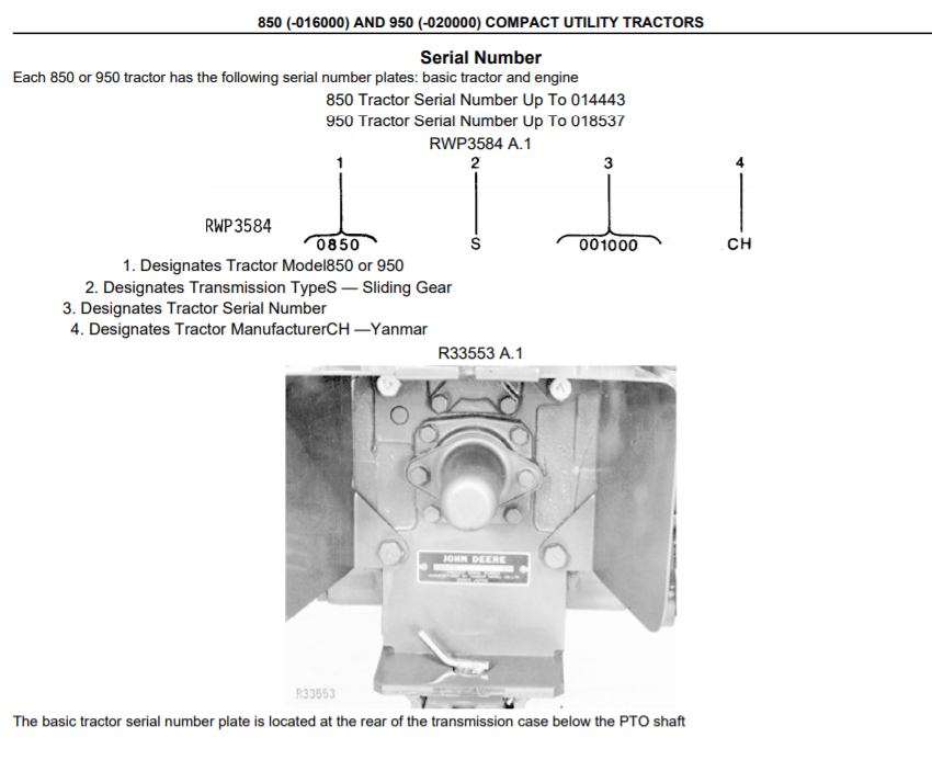

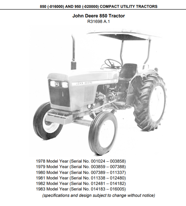

OK! Thanks for the info. any idea where the serial # is located on these tractors?
   / John Deere 850 PTO question #4
According to JD 850 parts catalog serial # tag is below rear pto shaft.
