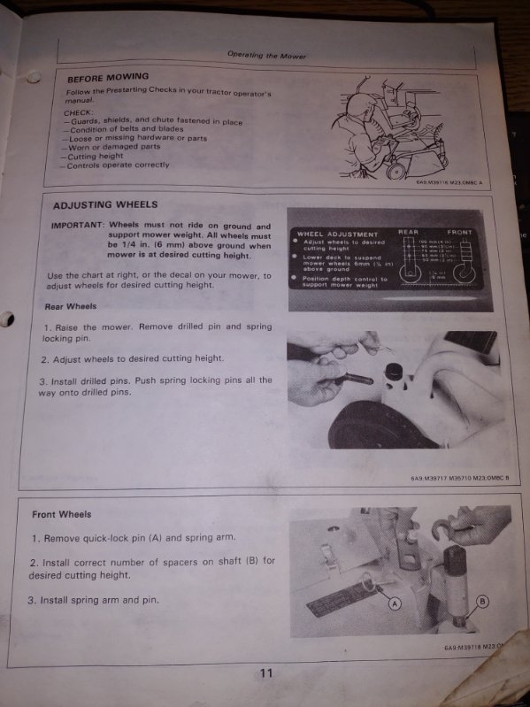

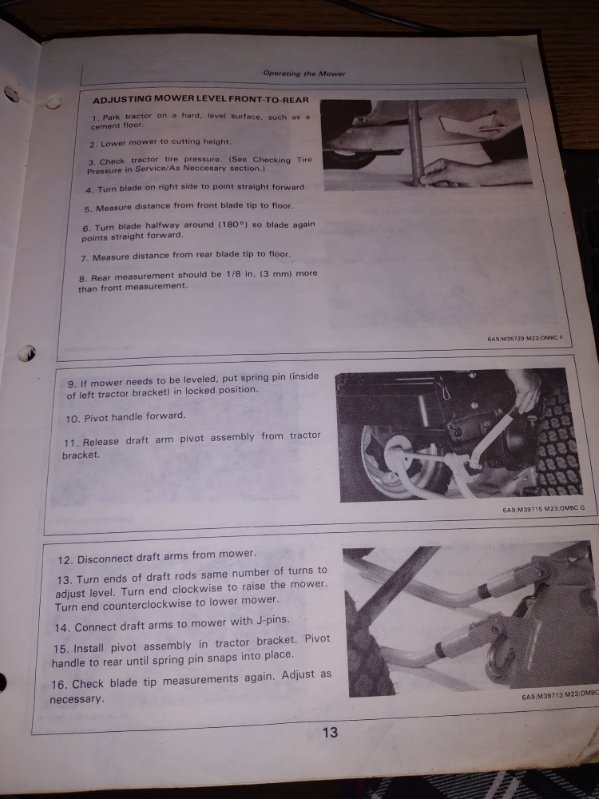

Hi. I have an 855 (love it) and also the 60" mid mower deck. The deck has been off and in a shed since I bought a green zero turn mower a few years ago. I also have the mower Operator's Manual you need. It has a part #OM-M91324 if you can find one. I don't have a scanner, so I took these pics of the pages for the wheels/leveling. I hope you can read them. Let me know if you need clarification. As I said, I don't use the mower any longer, but I can maybe help some...

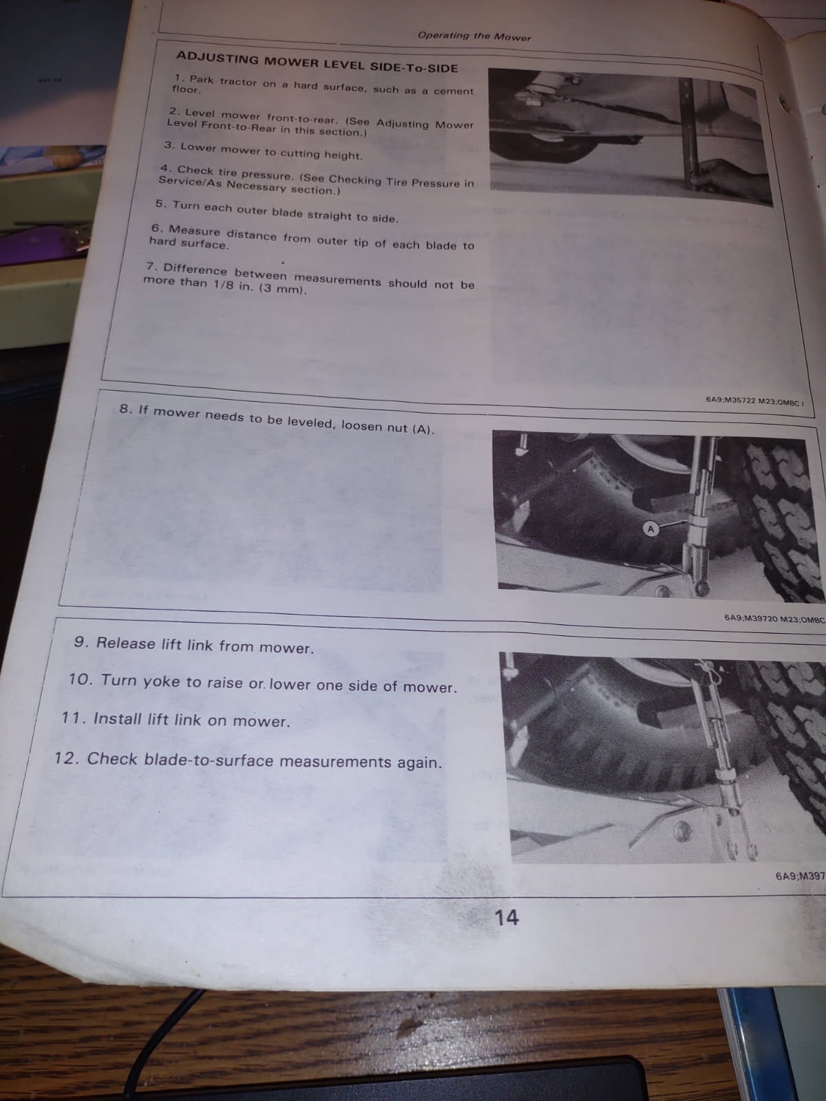

Thank you. But it seems they only cover front-to-back levelling and not side-to-side, which I what I am after. Perhaps, that is simply because it is assumed you simply adjust the connector struts running from the back of the deck to the lift arms, which is my plan for today. We'll see but thanks again.
   / John Deere 855 belly mower lift #26
Page 14 has that covered. Sorry, I posted two dups and not this page. You loosen the lock nut and turn the yoke on the lift link. ;)

THANK YOU!!! That is exactly what my plan is. Except the links installed now cannot be adjusted (turned) because the previous owner welded them into a solid link. If swapping them side-to-side doesn't resolve the "lean", I can easily replace those links to make them adjustable again. Thanks again!!

Yeah, I also noticed the front supports (that adjust the front-to-back angles) were also welded, but not as big a deal since it is level enough for me and only using this mower for our 9 acre hay field. Like you, I purchased a zero-turn to handle the bulk of my everyday mowing that I care more about.
No worries about the manual. There's really not much to it - it's just a mowing deck (no rocket science needed) and I was on the correct path already for this problem. But correctly identifying the parts when needed is crucial so I'll likely pick one up eventually.
