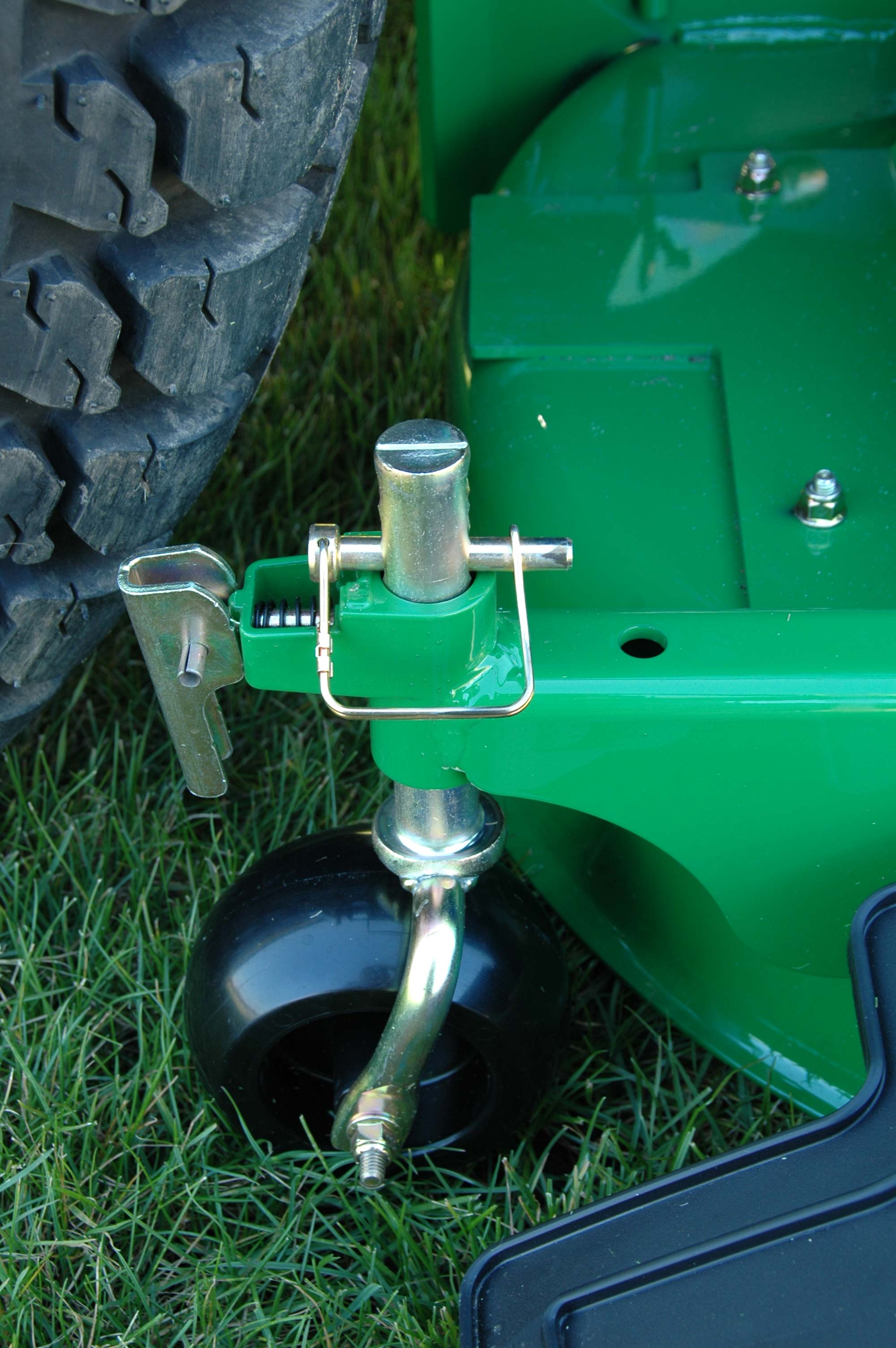

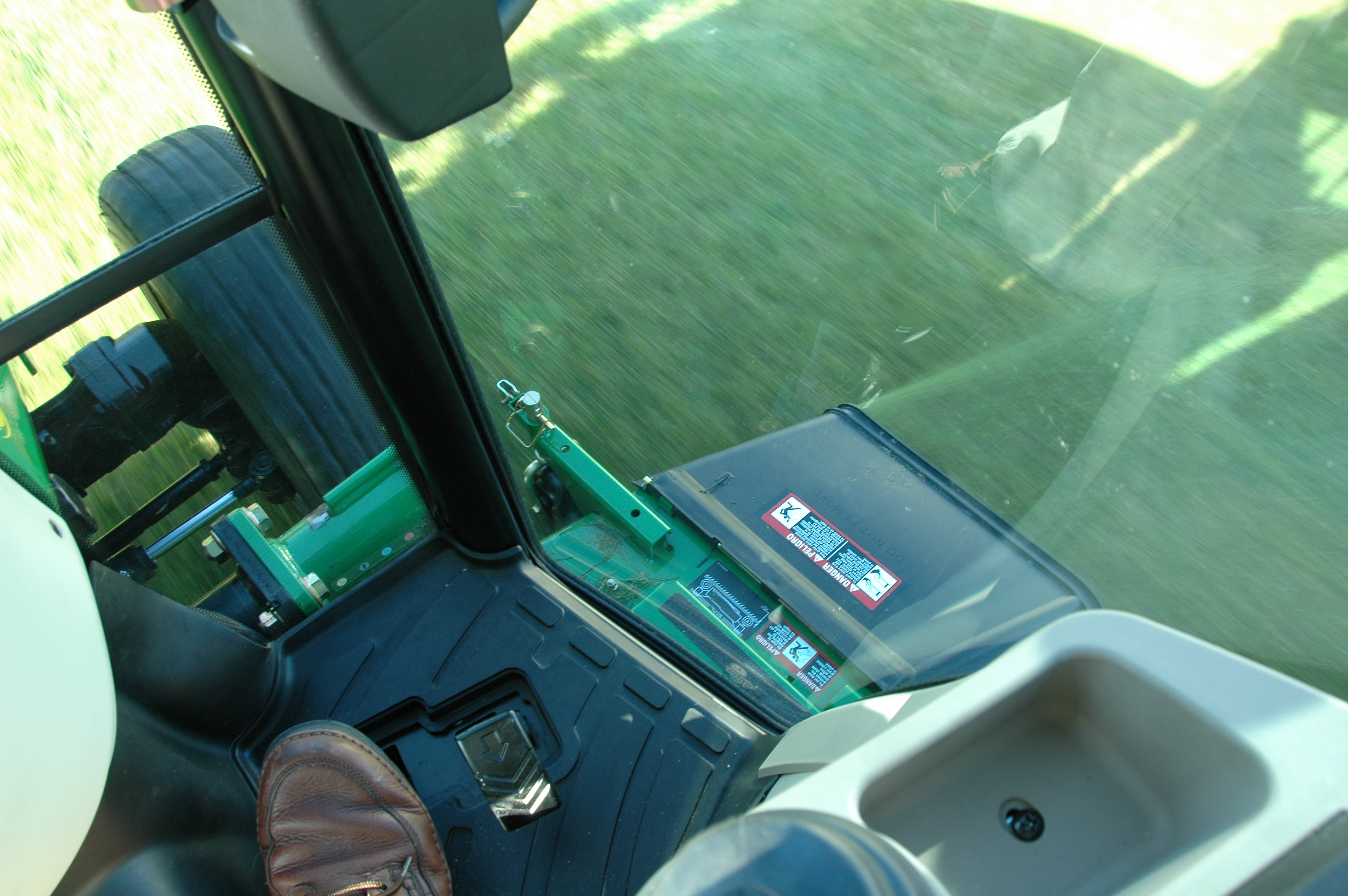

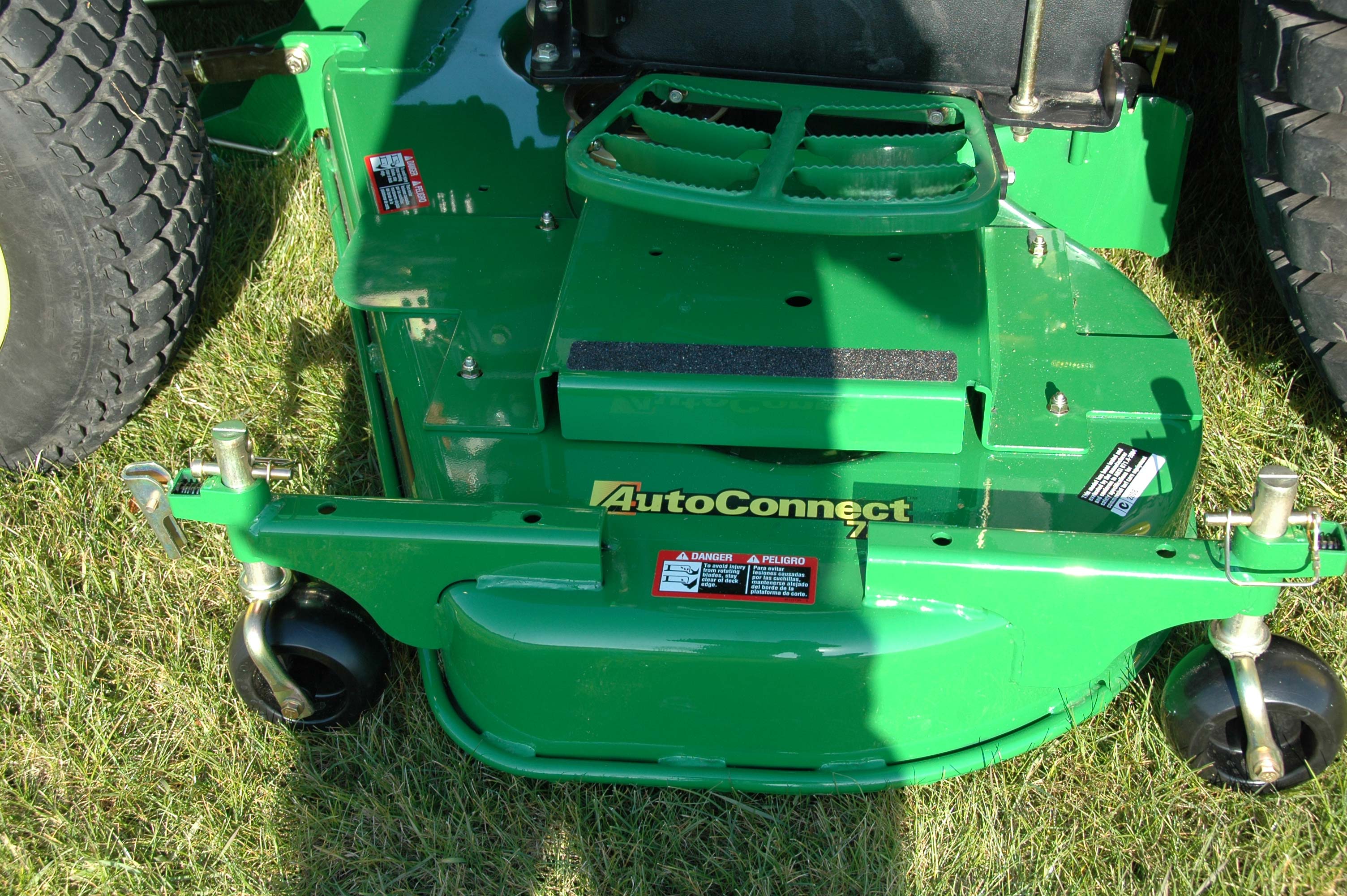

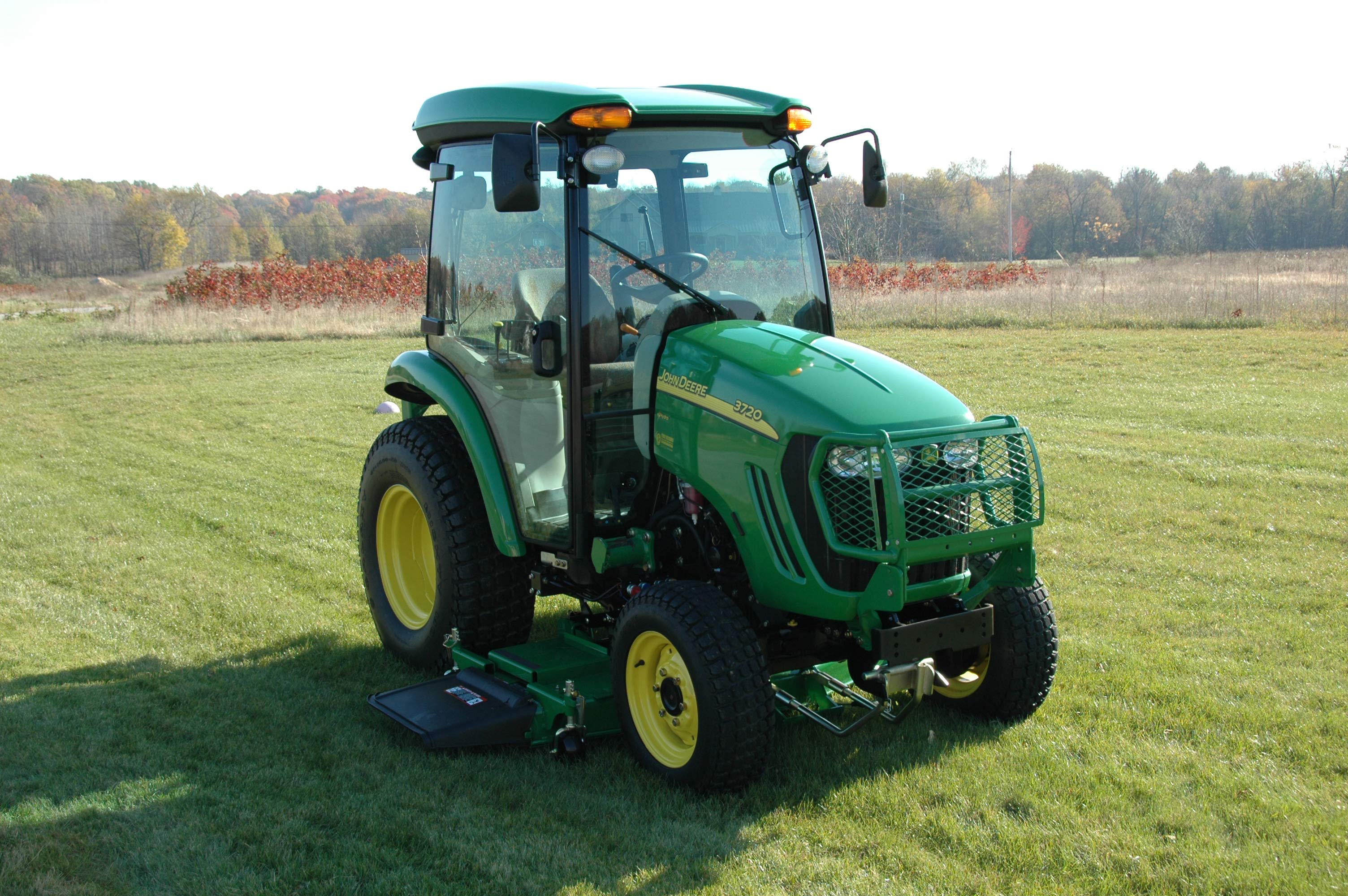

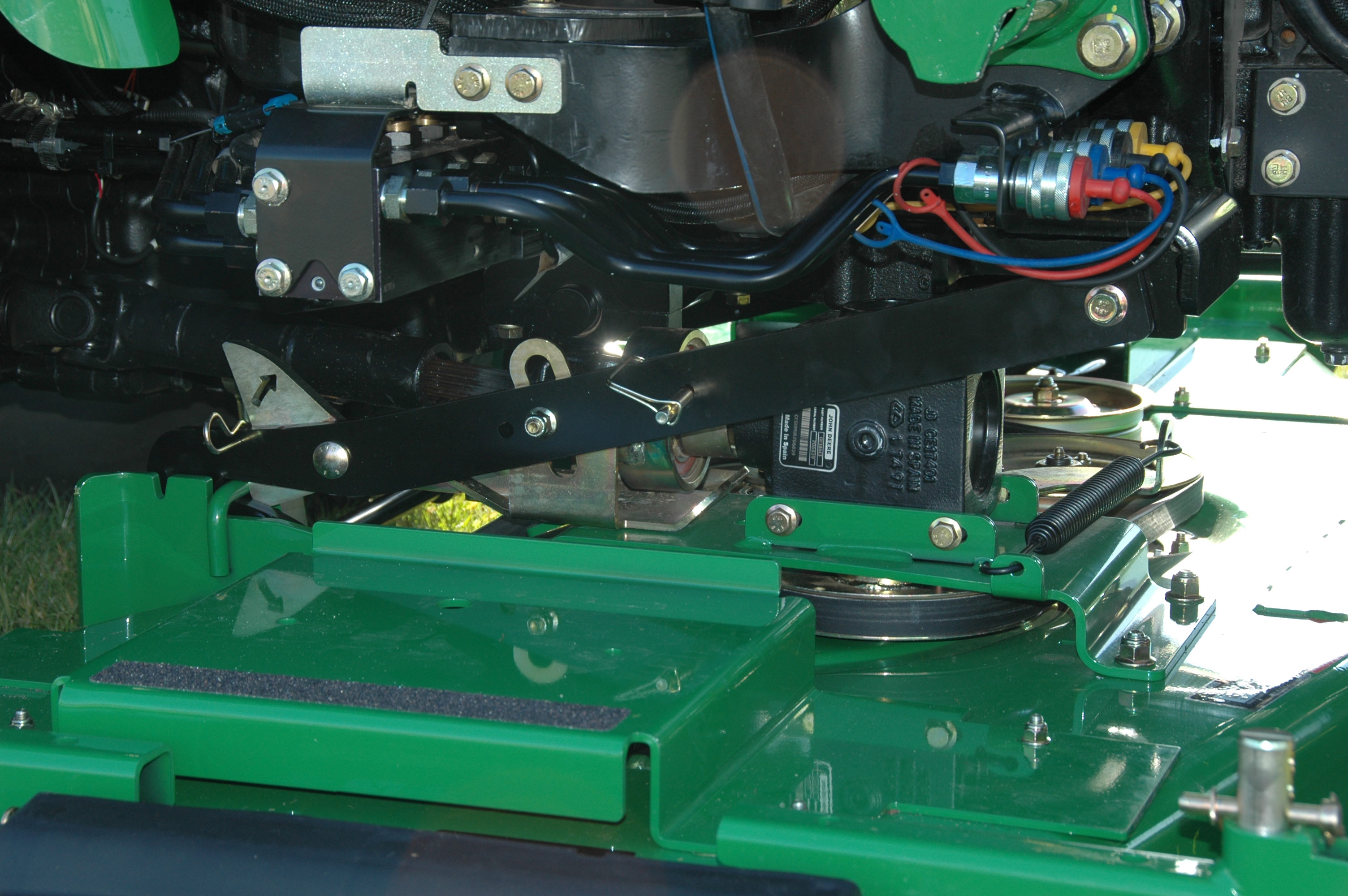

Got my New MMM on Friday. Thought I'd share some pictures. Dealer also fixed the tranny. It would occasionally pop out of reverse in B range. They also found a small leak in the front axle seal and fixed that as well. After installing the mower deck they noticed the deck was dropping too fast so they added an orifice to the hydraulic line to slow down it descent. They also found a slow leak in the front tire and tubed it. It's running like a top now. Thanks Jim and Jason. It's great to do business with people who care about the work they put out.:D

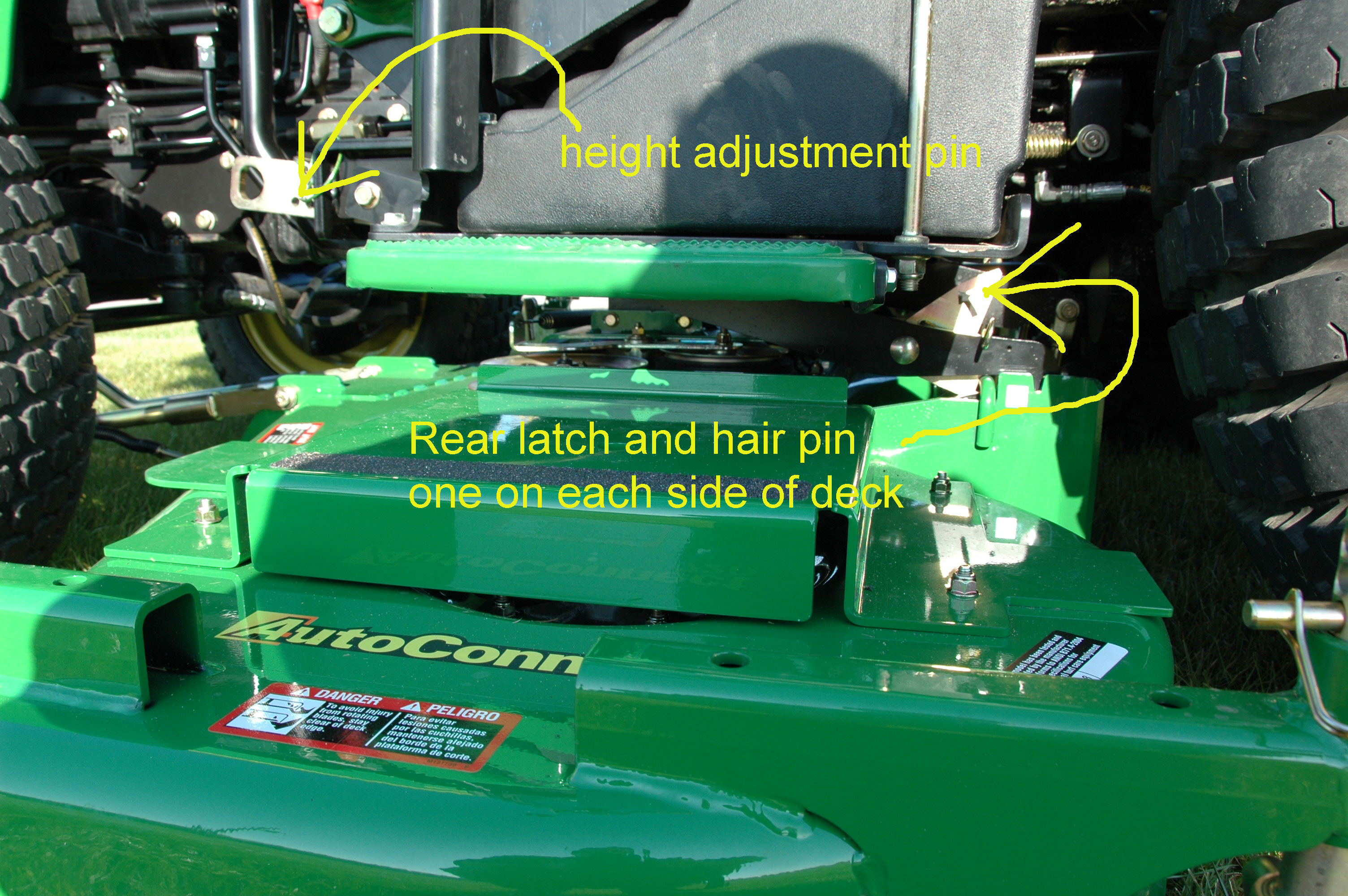

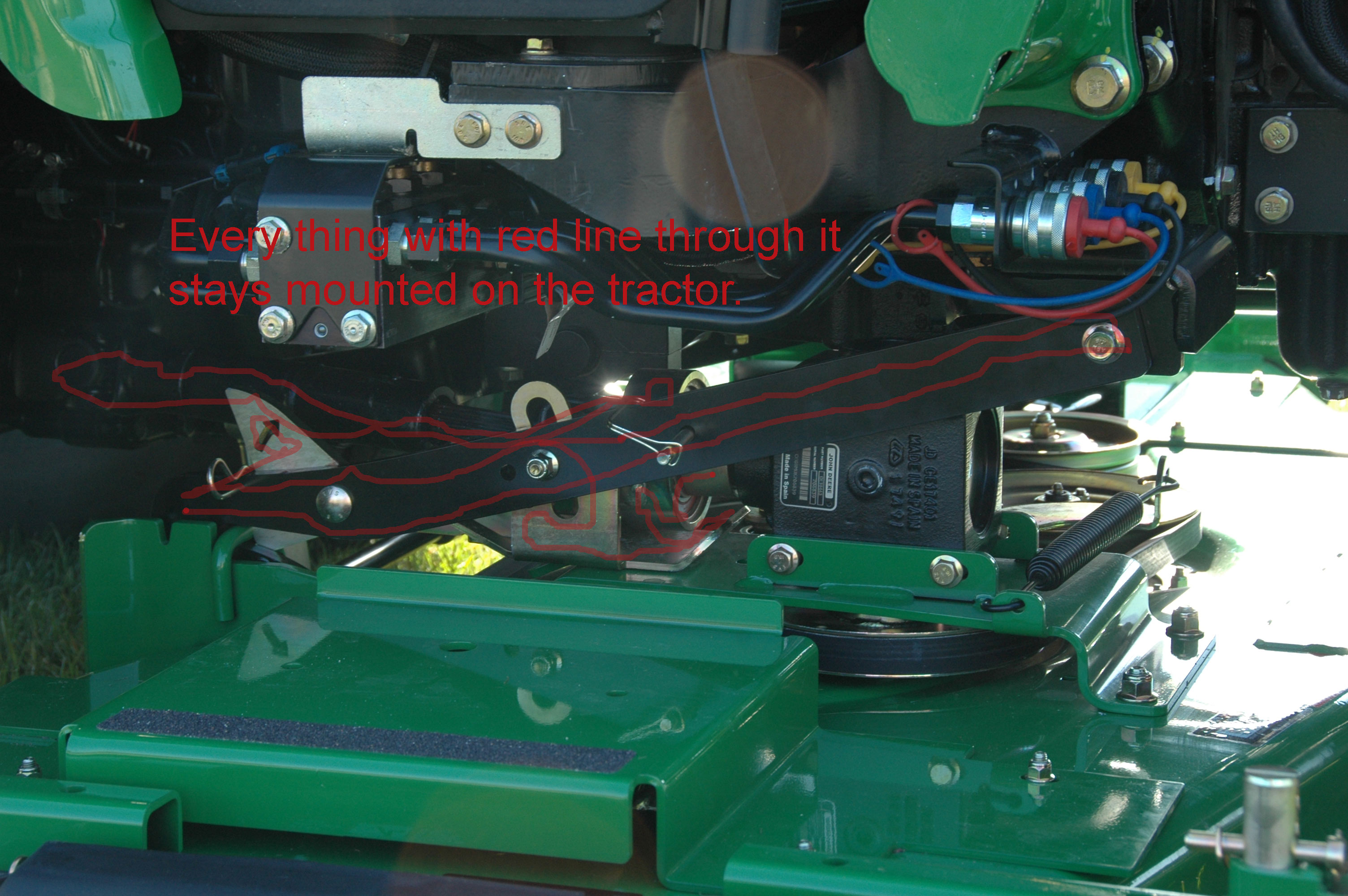

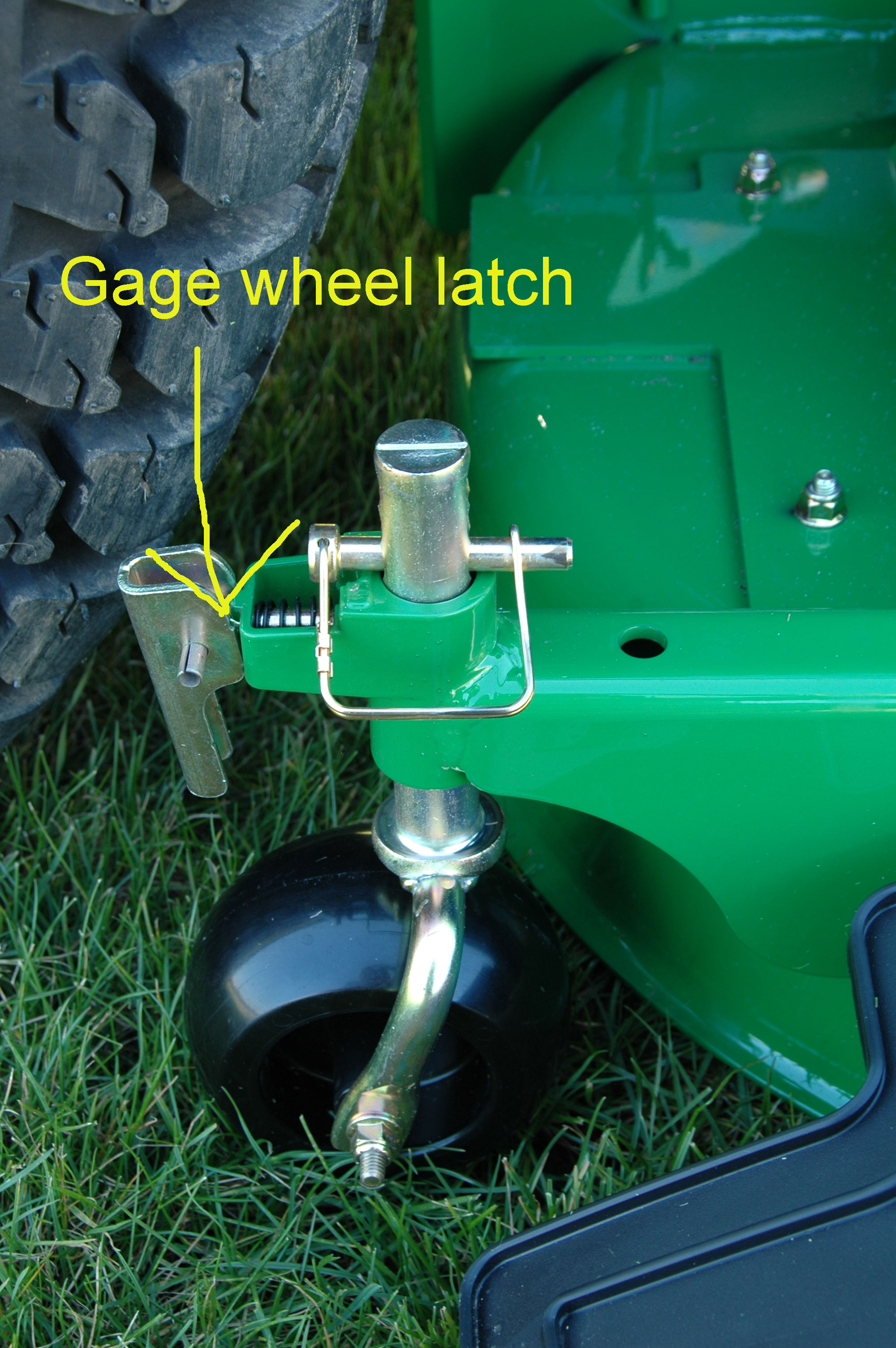

So far I really like it. It seems to work as advertised with no hang ups. Cuts very nice and works great for blowing the leaves off the lawn.
To connect
1. remove the height lock pin if it's in the storage position and lower lift system.
2. Make sure hair pins on the lift system latches are in storage position.
3. make sure the front link on the mower deck is folded forward from it's storage position and gage wheels are in the unlocked position so the deck is flat on the ground.
4. Put tractor in A range four wheel drive.
5. drive tractor over the mower deck until the mower deck begins to be moved forward. At this point the pto is engaged and the front mount and rear latches are connected. lift mower.
6. Install safety hair pins in rear latches and install pin in height adjustment link. Flip latches on the four gage wheels to allow them to drop down.
7. Go mow.
To remove
1. Park on level ground.
2. Remove height adjustment pin and the latches on the four gage wheels.
3. Lower the deck to the ground.
4. Remove safety hair pins on the rear latches and flip them forward to release.
5. With tractor in A range four wheel drive back over the mower deck.
6. Raise the lift system and place height adjustment pin in the storage position.
It may seem like a lot, but I can probably connect/remove the deck in about two minutes. I went slow the first few times getting out to check alignment of everything so I wouldn't tweak it. One time while connecting I forgot to lower the lift system so the front engaged but the back didn't. No problem I just backed back off and lowered it. Drove forward and everything connected. So far it's a pretty slick system.

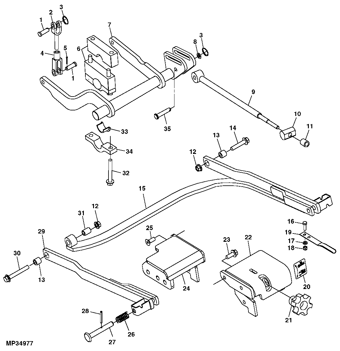

I had been waiting to get a report on the new 72D deck. Nice. Had an interest in the new HOC (Height of Cut) adjustment. When I got the 72 deck for my 4410 the height control was not a very good design. The adjustment knob would spin on its own and change the HOC. Contacted dealer who contacted Deere. They said they were aware of it and would let me know if they could come up with some design change. Never happened. I ended up taking off the height knob and using double nuts to secure the height and carry two boxed wrenched if I ever need to adjust.
After seeing this new 72D with redesigned HOC I compared parts diagrams for the 72 and 72D. Attached the pixs. I was wondering if one could swap in the LH bracket and link height adjustment and gain the new height control. Parts total over $200 from the parts page. I have a message into my dealer to see if they could find out. From the pixs it looks like it was worth asking.

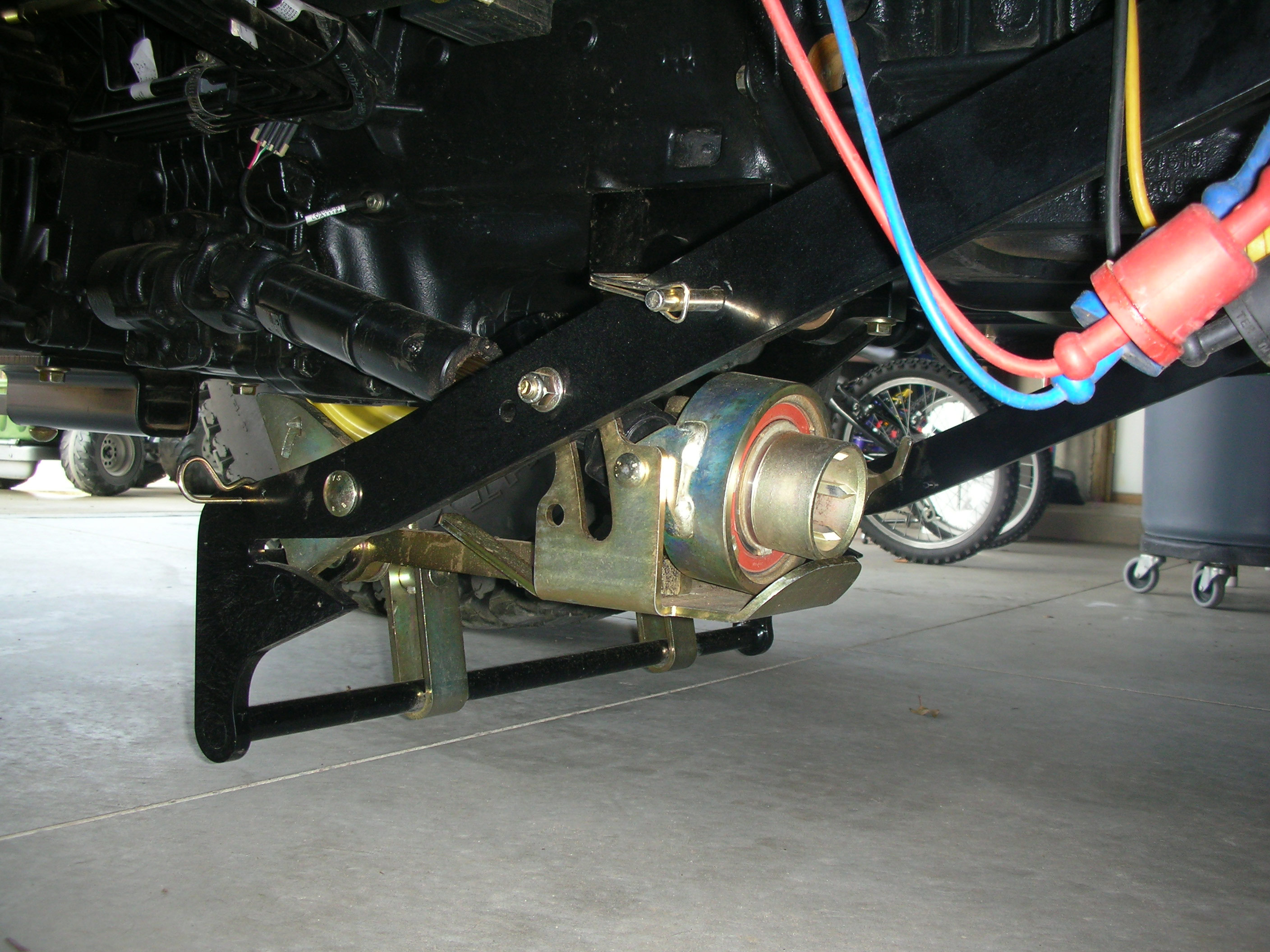

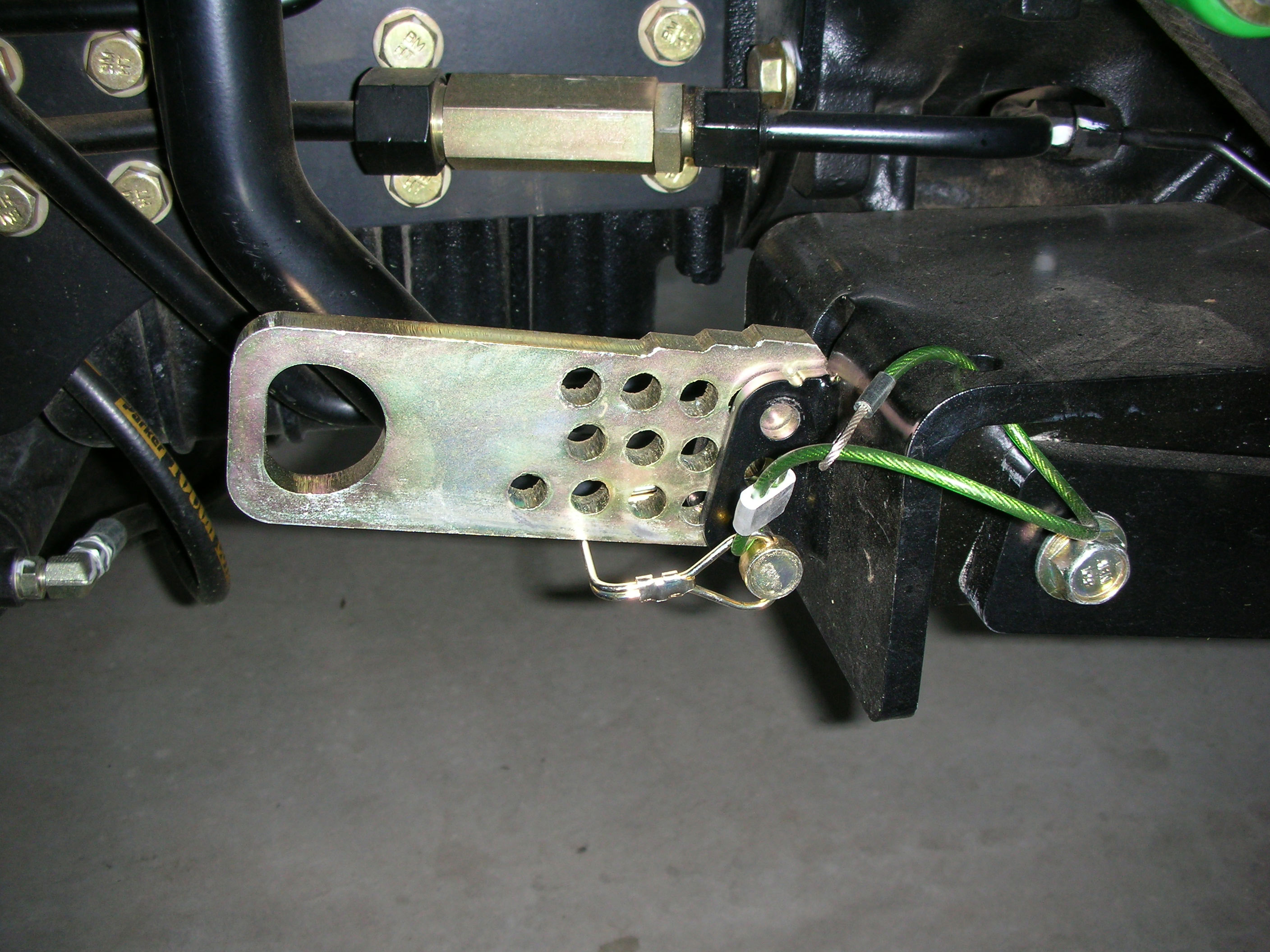

Here are some more pictures of the height selector and the pto hook up underneath. At this point the height selector seems very simple to adjust and because it uses a simple pin it should stay where you want it.

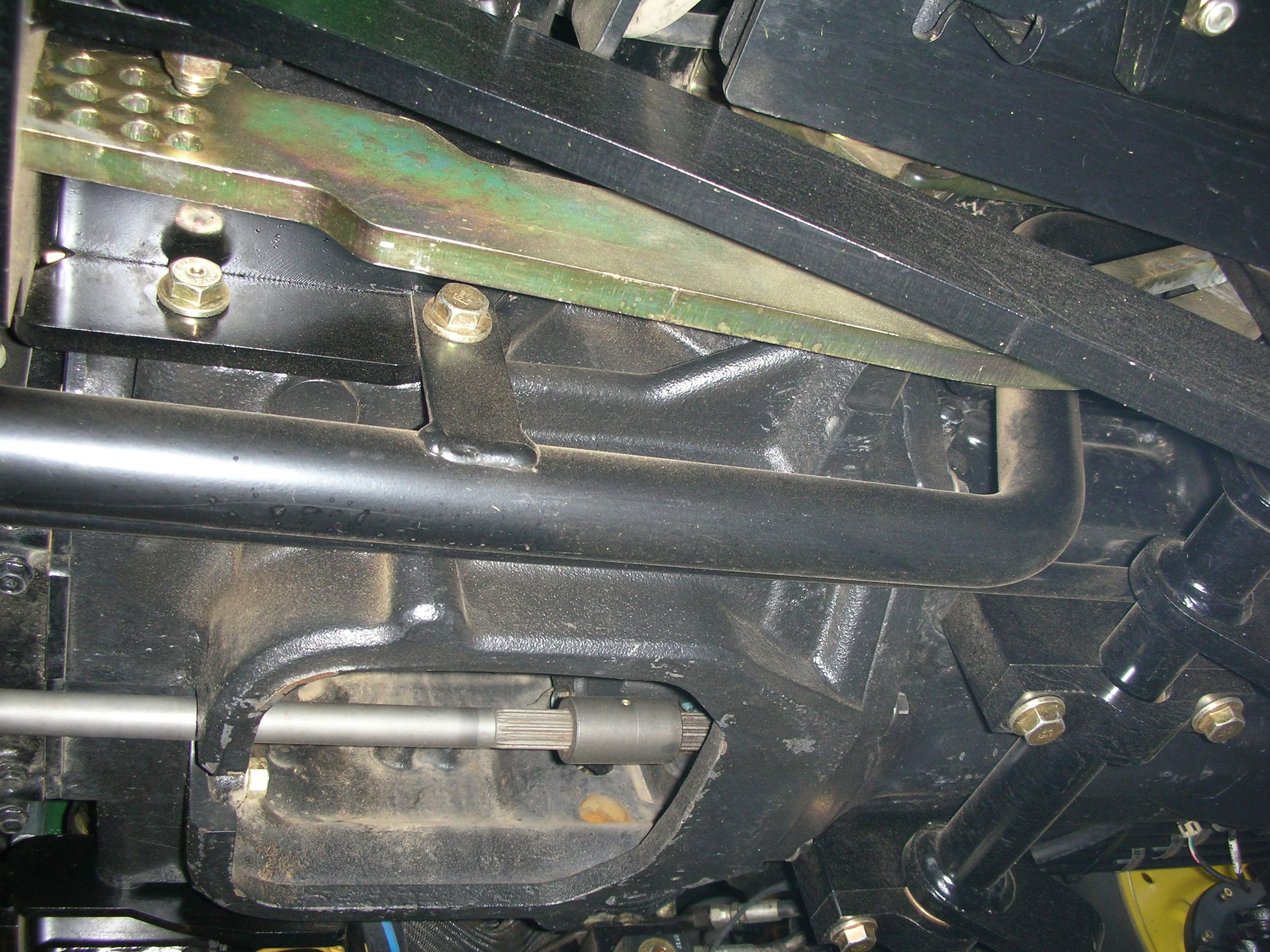

Two minutes isn't bad, still looks like about the same amount of steps as most mowers. How low is the PTO on the tractor?
   / John Deere Auto Connect 72" MMM
#12
PTO up and down pics. I think they did a good job of getting up out of the way considering the amount of space under the tractor. You could easily remove the lift mechanism. It's just 2 bolts and 2 pins.
