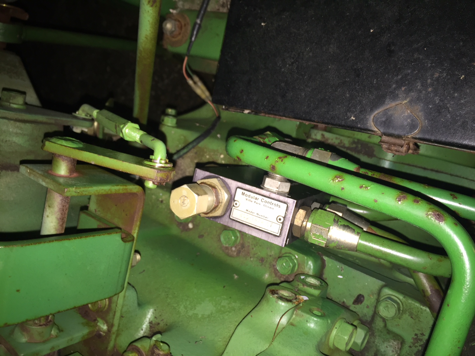

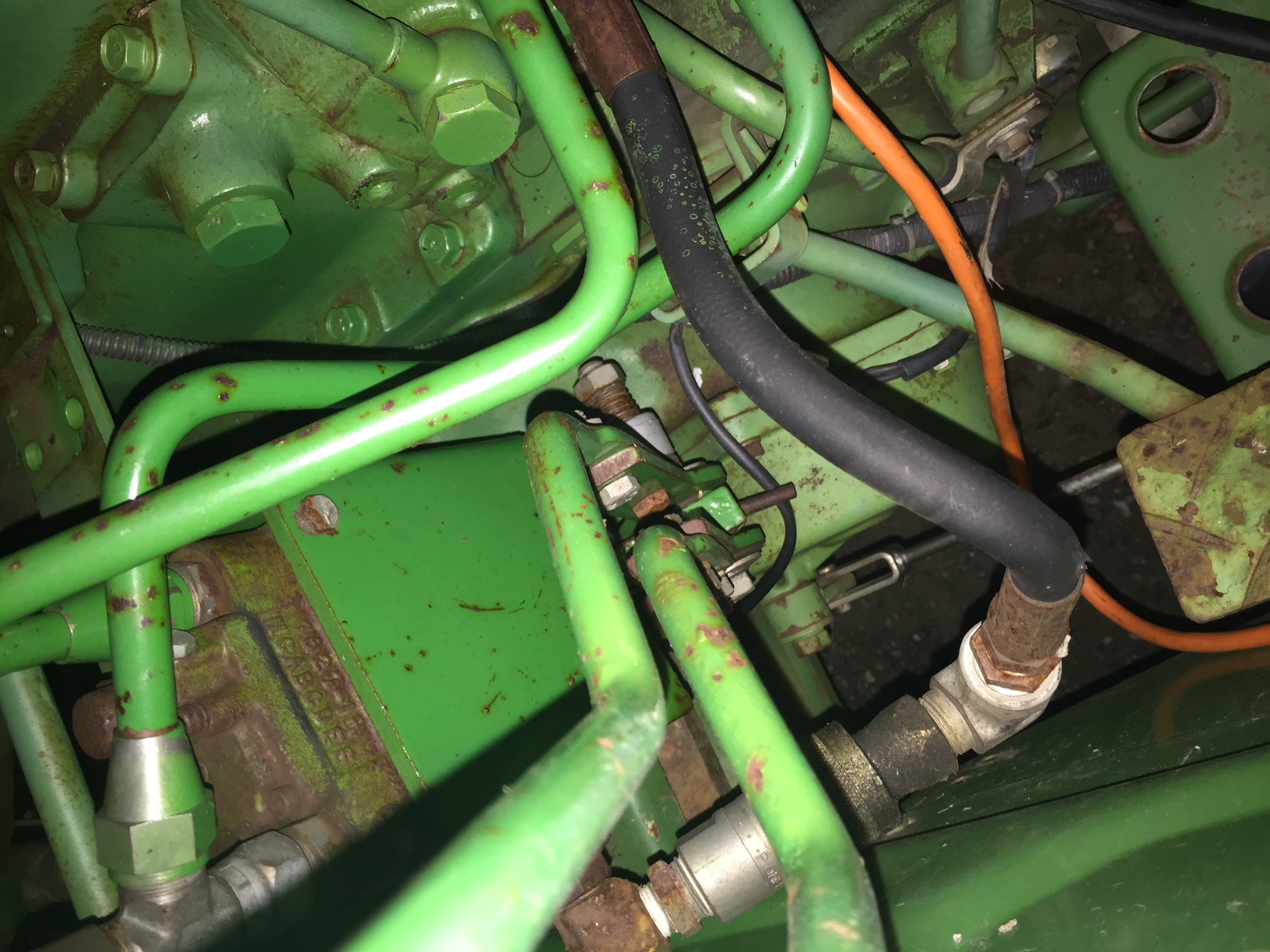

Re: John Deere 850 Power Beyond / 3PT hitch Questions
I have a new to me John Deere 850 with power steering and power beyond factory installed. I have the seat removed and am attempting to trouble shoot the 3PT hitch raising itself. I believe a relief is dirty or damaged and is bypassing. 850 H looking from above 1.jpg850 H looking from above right selector valve 4.jpg850 H looking from above 2.jpg. I have not changed the hydraulic filter or cleaned the screen yet that is tonight's project. I would appreciate any guidance as to which valve may be suspect. I would like to remove the power beyond selector valve completely since I do not need it and it has not been used for many years. Any help with tying the pressure line and relief line back in would be helpful. I have the technical manual ( thanks to Joe C ) I have attached a few photo's ( at least I hope I did ) thanks much for any help in advance. To you hydraulic experts I am a gasfitter by trade and am familiar with troubleshooting using gauges but do not have gauges for troubleshooting hydraulic systems and would appreciate any recommendations as to where to purchase .
Thanks in advance
Jack
