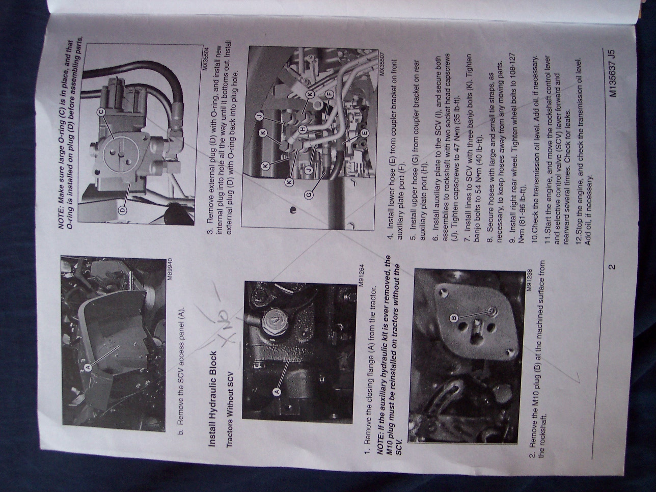

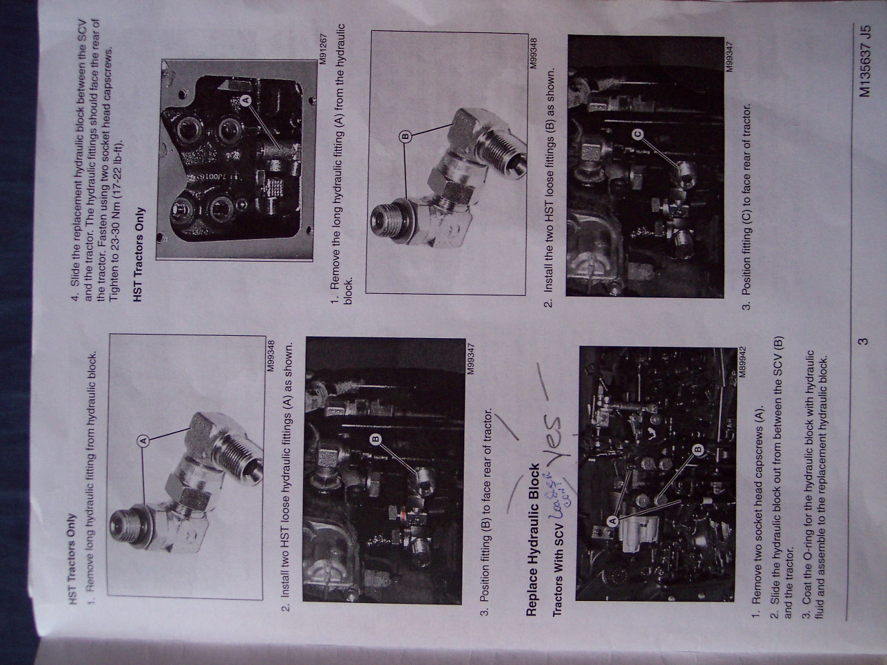

Goodmornin, I looked at the directions again for the 10 bizzilionth time. You mentioned a screw?? I see what you mean but the directions are split into 2 parts. #1 "Installing" Hydraulic Block, tractors without SCV. Like a front end loader which I have. In that section they want you to insert a new internal plug and replacing a cap with an O-ring in the replacement block. now in #2 "Replacing" Hydraulic Block, it dosn't want you to do that, ya just put the new block in as supplied. Trust me it's still driving me nuts but it seems clear as mud in the directions that it dosn't mention the screw, plug in the replacement block. I just wish I hade someother att for the power beyond system to hook up and test just to put to rest the screw job issue. Well thanks and I'am still messing with it waiting for the new valve from the splitter co.

Look at the picture below, You have to install the screw (#17) in the block that's between the valve and the tranny. It blocks the flow of oil back to the tranny case and diverts it into the OUT port of your PB lines. When this is not in place, your two valves (on the splitter and FEL) are in parallel and neither will operate correctly.
I see what your talking about but the directions don't tell ya to put it in when you have a SCV. As I installed the block the tractor is working fine, loader and 3pt hitch. I'll try and put the 2 pages of the directions on for you to see. Thanks 102_2241.JPG

RJ, I have the instructions...I know they don't tell you-I am trying to!. That is why I wrote this in my other reply:
The plug ( "C") is NOT what I am referring to. The directions do not really address the one I am talking about. It is installed in the block that mounts between the SCV and the tranny.
Do you have the screw (plug) in your leftover parts?
The block they gave you in the kit is IDENTICAL to the one you removed and you MUST install the screw!
I went through the same thing with mine when I installed the PB kit and had to take it back apart to install it.
Once again I ask: Do you have the screw in with the leftover parts?
