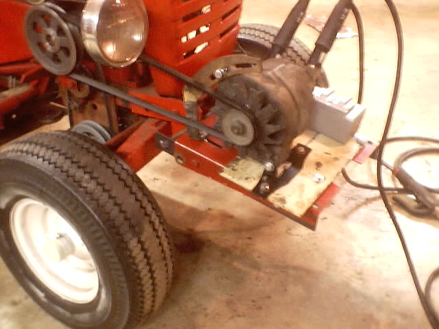

This is a closer shot. The adj bracket came off of a late 70's Bronco while the alt is off of a Buick. Talk about your integration /forums/images/graemlins/grin.gif
The weight of the rig keeps tension on the belt. The adj bracket is more for stability than adjusting.

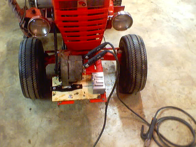

A front shot. Those welding lead quick connects ran me $10 apiece! I had the weatherproof outlet box laying around and the mounting plate is for a later model Wheelhorse seat mount I got off of ebay. Since it wouldn't fit my 856 it's made a very nice front mount platform /forums/images/graemlins/grin.gif
I've got some 15 amp rated rheostats coming and I'm going to use one to adj the field voltage to control the output. I'm also looking for a cheap, err ahhh, inexpensive 0 - 150 volt DC voltmeter too.
I've run a drill, hand grinder, sawsall, electric hedge clippers and std light bulbs off of it.

Left side shot. Once my sorry welding skills improve, I may add some sort of brackets to hold the leads.
I added the later model Wheelhorse front quick-attach mount for projects like this. I can easily mount or dismount the entire rig in a minute or so without useing any tools. When I originally wired in the head lights I used barrel type connectors so I could easily unplug the lights whenever I removed the hood. Those same barrel connectors is where I picked up the 12vDC for my field input. I may have to add an ammeter to the tractor to see what kind of draw I'm putting on the tractors starter/generator. It's seems to be handling it OK though.
Thanks for posting your project Guidster. I had often thought of useing an alt for an AC generator but modifying one to be a small stick welder was new to me and is an OUTSTANDING idea /forums/images/graemlins/grin.gif

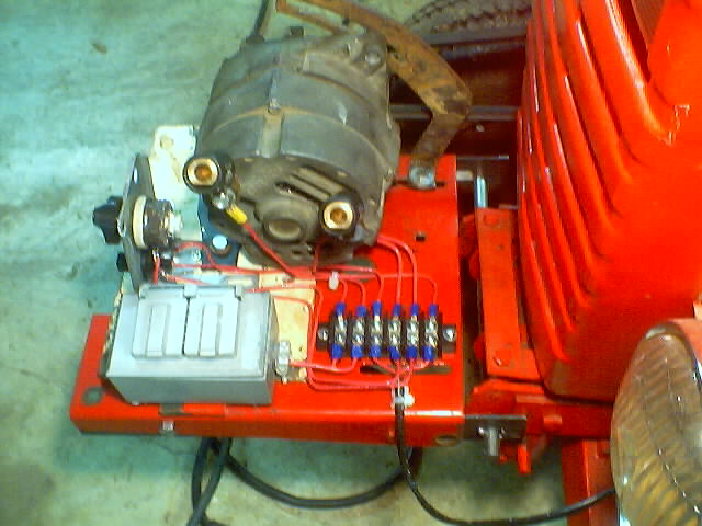

Good luck on the solution your seeking. I've come up with an ultra-simple control. I've put a 0 to 10 ohm 3 amp rheostat in series with the field input. At approx 3600 RPM I can vary the output voltage from a minimum of around 40vDC all the way up to 130vDC. I don't have an ammeter on it but I'd say the current adjusts along with the voltage. As for the cycles, I doubt they hold constant. You figure out how to keep a constant frequency at differening voltages d I'll be interested in that as I still have thoughts on makeing an AC generator to be powered off the Wheel Horse in the same way the welder is.
In the pic is a screw terminal strip I added to clean up the wireing, the 10 amp fuse to protect the tractors electrics and the 0 - 10 ohm rheostat to control of the alt's output. I hope to add a DC voltmeter.

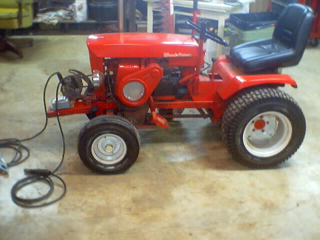

A front shot.
My welding is terrible. I'm experimenting on which setting is good with which rod and on which metal/thickness.
I've already figured out that the setting is too high when I burn through the metal /forums/images/graemlins/crazy.gif
It's getting that "right" setting where that nice flowing bead result's. I've yet too find it yet /forums/images/graemlins/confused.gif /forums/images/graemlins/grin.gif
