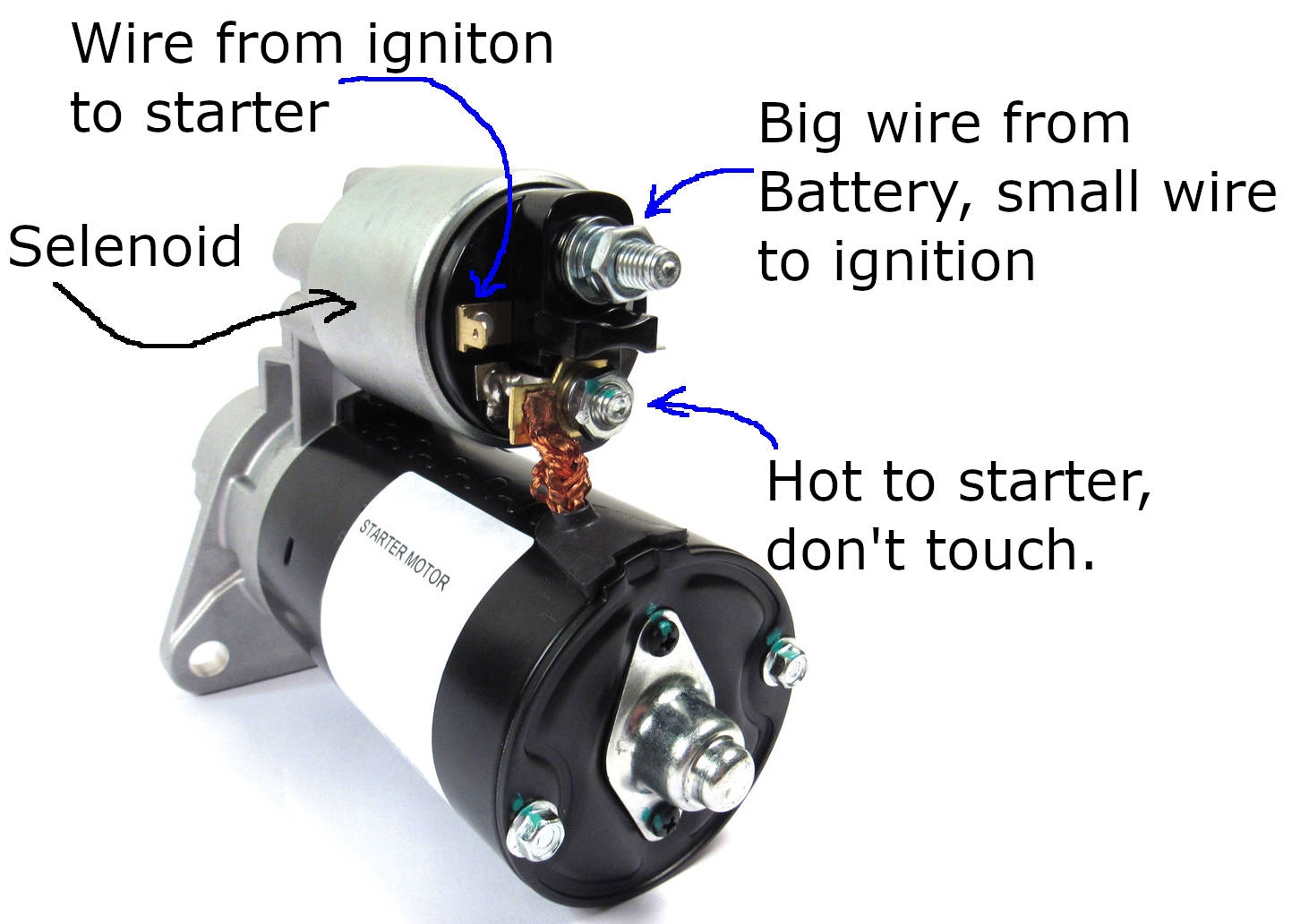

One thing that I like to do is to turn the ignition on, then jump across the starter solenoid.
startermarked-jpg.831346
Sometimes just a screwdriver to go from the "hot" to the ignition contact. Or, sometimes a wire from the battery hot to the ignition terminal.
If that fails, then go through and check all the main cables from the battery to the starter, and from the battery to the ground.
