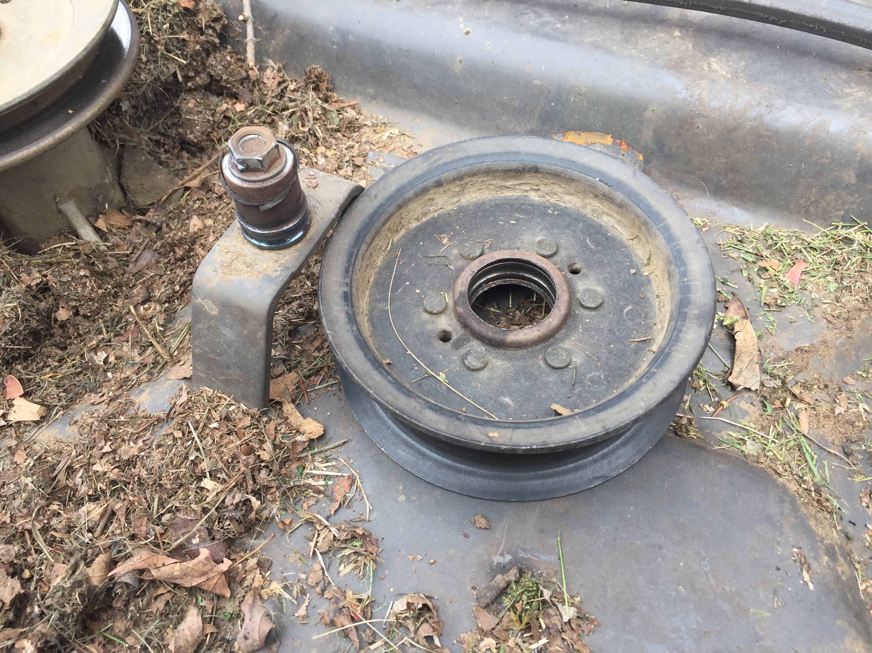

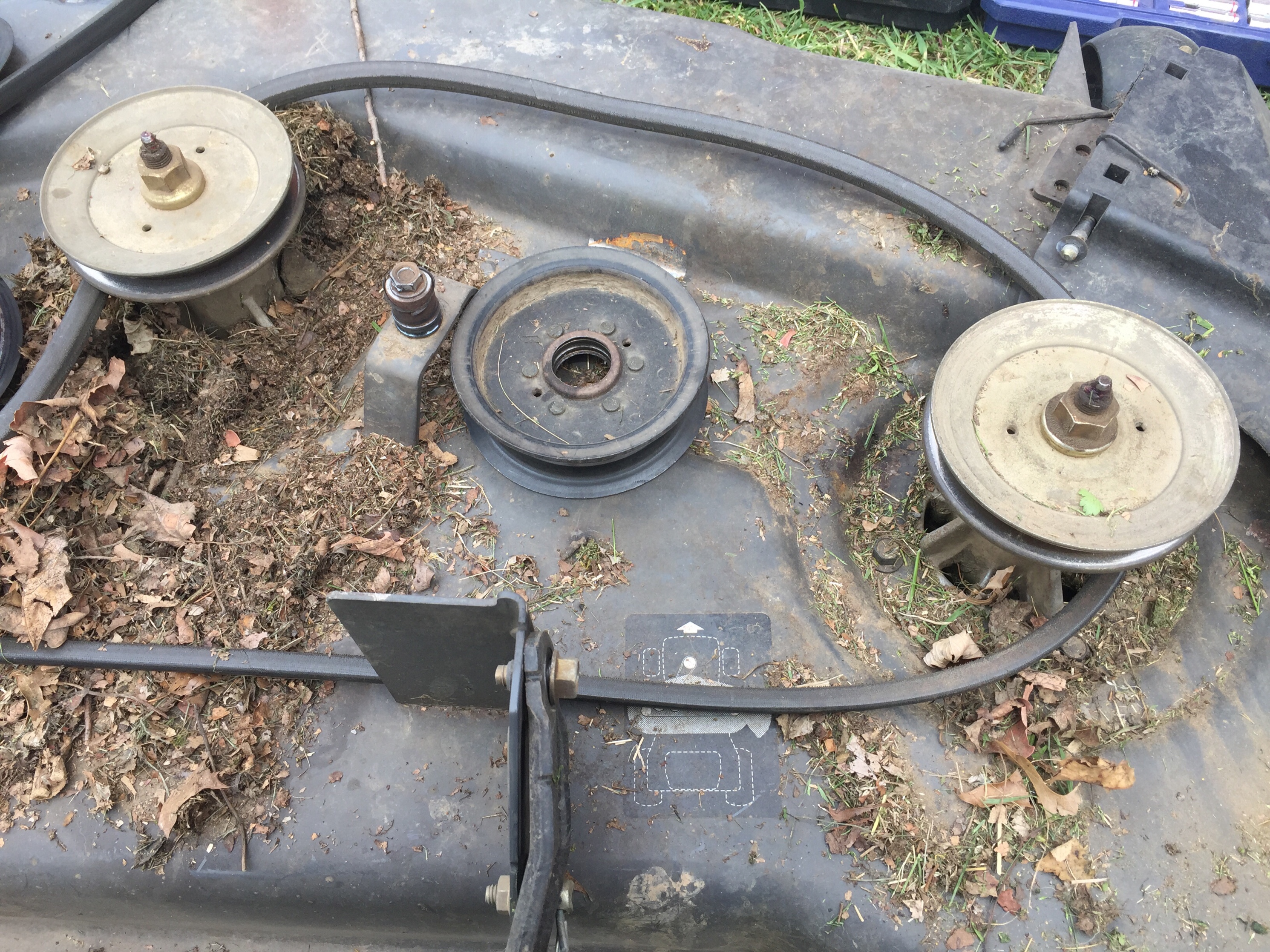

I posted this on another thread but will here as well.
I had to use the manual today lmao. I got most of all my mowing done, just a little left on back by the pasture but a pulley idler bearing gave out on me. $15 a pop, I ordered 2 off Amazon along with a spare stationary idler.
Total $67 to the door for x2: 532 19 61-06 (Pully Idler), x1: 532 19 61-04 (Stationary Pully Idler). I'm just gonna replace all the non grease able pullys and have 2 used pullys as a spare.
I'll re pack what I can. Deck was super easy to take off, just 5 clips, needle nose pliers is all I needed. Less than 5 mins and it was out.
I still don't see where the grease zerk is for the steering gears, the gears on mine is exposed and I don't see where they can be greased.
I think I might repaint my deck since I have it off, it's got some paint peeling. She has 241.3 hours on her now.
I'm super happy with the availability of parts on this mower, so far I have bought everything off Amazon with free shipping. Parts are crazy cheap also. New blades ($32 shipped to the front door) cut like a dream, my grass is literally perfect lol, still super pleased with the husky.
But I believe I have the cheaper husky, I thought I saw a lowes sticker on it somewhere but I looked just now and didn't see one. But my deck discharge I would say is 4-5 feet, nothing that impressive, not like the guys who bought there's from a dealer has been saying.
