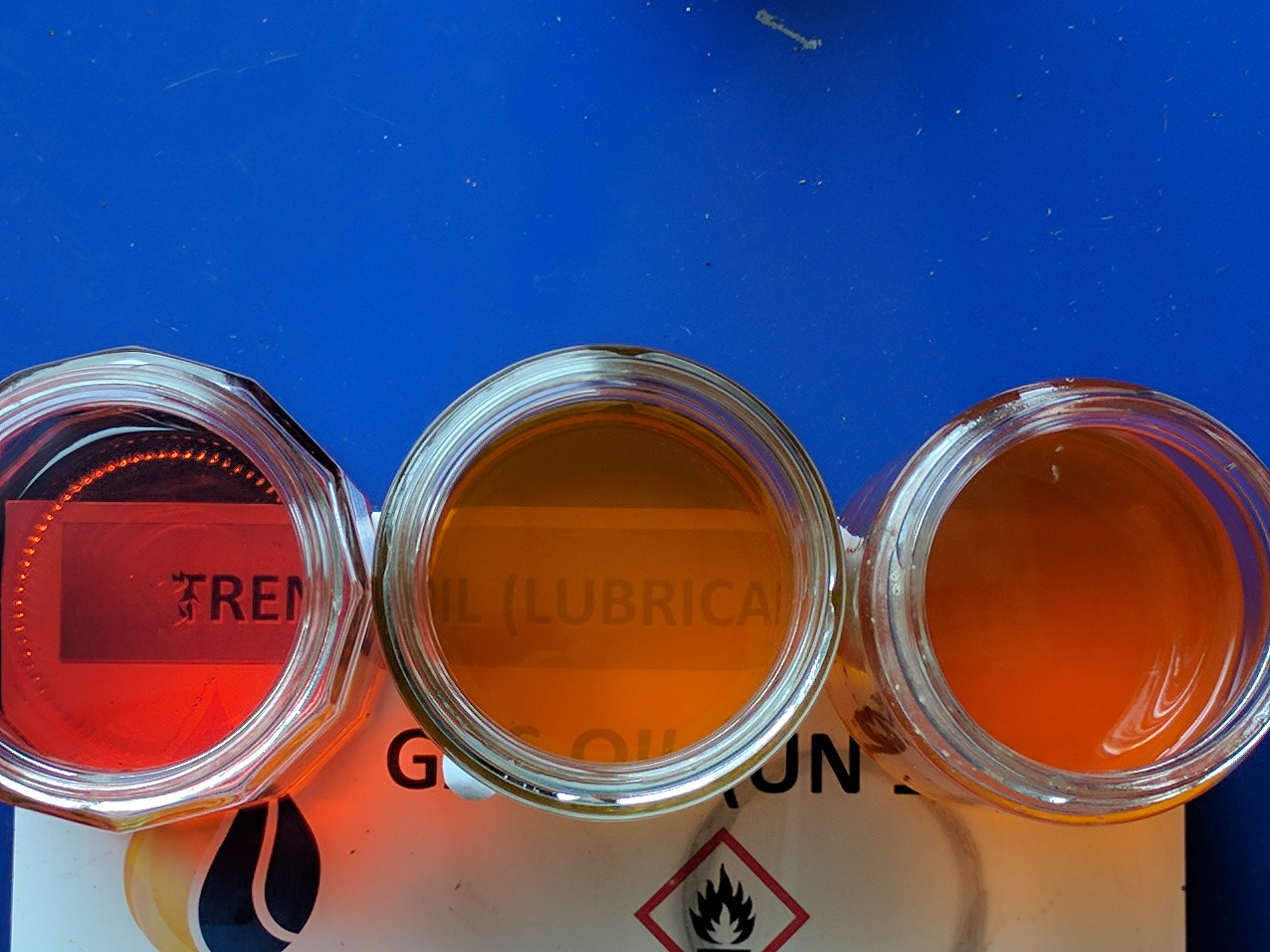

Joy! It works. Took a few turns, just to wind me up, then started and runs perfectly. I'll post a picture of the fuel tomorrow, what a disaster it's been!

Yes it all worked. I vacuumed out the tank again, drained it all through and now it's strictly running on fuel from a barrel! Here's a pic showing left to right 1. New fuel, 2. Fuel from the mower that was biocided from the IBC tank, and 3. Fuel from my Kubota B2150 tractor with its rusting steel tank, that clogged its filter in the middle of it all!
I really thought I'd got rid of the water, but I hadn't.
I couldn't have diagnosed it and worked through and dared to take the injector pump off without you guys so THANKS again! Happy ending, and hopefully anyone with similar issues can find this thread now.

Next you had better get into the Kubota and drain all fuel from its tank. The pics of your old fuel are not pretty.
