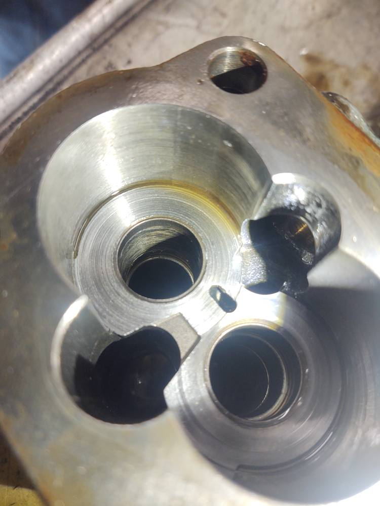

Welllll, everything has been fantastic until the other day. I noticed that I couldn't pick up the blower at idle anymore. Steering and pto clutch operation was totally normal. So onto the diagnostic tests.
Fluid level good, clean (just changed when mid pto kit went on in December), and not foamy.
Pressure gauge showed 1200psi at idle and 1800psi max when stone cold. When hot, only 300psi and 1100psi. That eliminates a suction issue because it would be worse when cold.
Relief valve removed and inspected, nothing found. Relief adjustment bottomed out, no difference in pressure gauge readings.
Next test was a bungee cord pulling a rear remote lever deadheading at 1500rpm. After about 5 minutes, the suction line to the pump was warm and steering discharge line was quite warm. Rear hydraulic discharge line was stone cold coming off the pump. Veryyyy interesting. Seems that the pump is internally bypassing somehow from the main hydraulic side into the steering side.
I tried like hell to contact Shimadzu directly to source a pump seal kit/parts availability, but it was absolutely useless. I called their USA office number and every extension went right to voicemail and all vm boxes were full.
So sadly, I had to call the dealer and order a pump and all the associated seals for $1034 shipped. I asked if i could return the pump in case my diagnosis was incorrect and they said yes as long as i didn't open it. Silly me, I ASSumed the whole tractor was under the 5 year warranty. But that's only the drive train, everything else is only a 2 year as I found out.

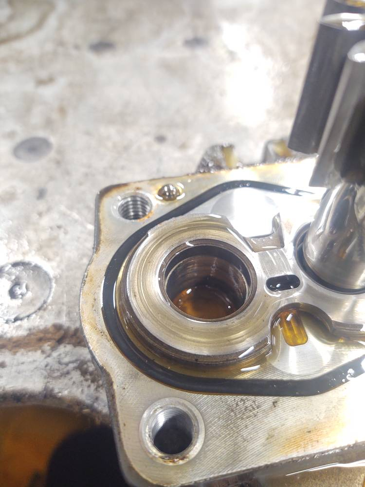

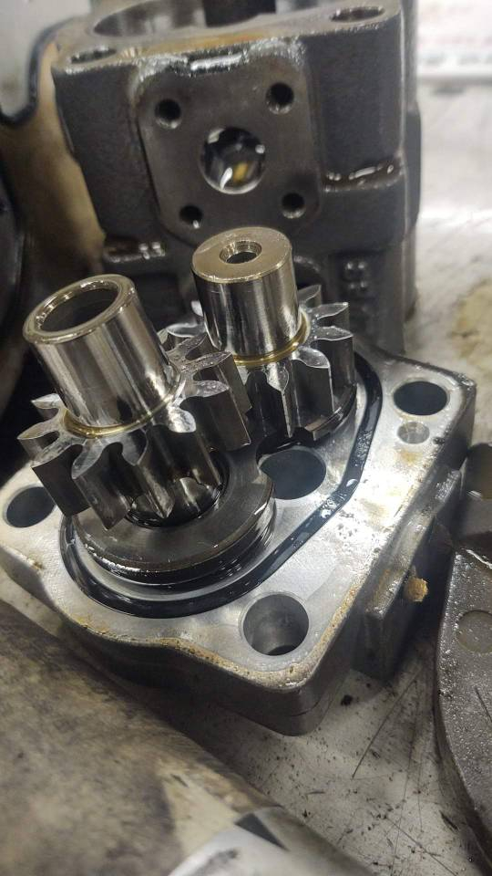

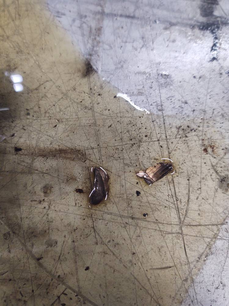

I tore into the tractor today (which was a giant pain in the rear) and pulled the pump. Tearing the pump down, it definitely was the issue. The shaft bushings on either side of lower gear on the main chamber were destroyed. The excess clearance between the shaft/bushings were letting hydraulic pressure escape and travel through the hollow lower shaft of the steering side of the pump and into its discharge line. I'm just happy to have actually found the smoking gun.
Pulling the strainer, there was definitely metallic junk stuck to it. So the cavity was cleaned out and a new strainer installed along with a new spin on filter. The 15 hour old oil will get pumped through a 20 micron filter on its way back into the tractor.
