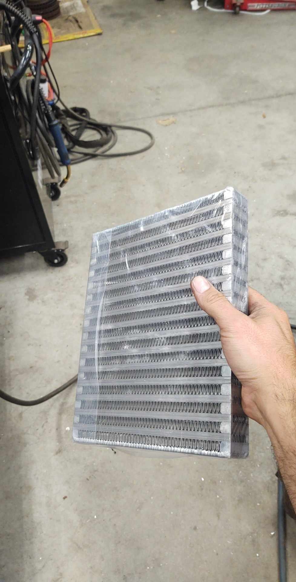

The hoped perfect plan is to add the 10.5"x8.5"x1.25" Bell intercooler and have a good friend adjust the tune while monitoring egt on a pto dyno. If needed, I'll make a straight exhaust pipe to remove the doc to see if it's a restriction and drops egts. If absolutely necessary, I'll add a second turbo for a baby set of compounds where the doc currently resides. I really don't think I'll need to go that far given the extremely modest goals. Im not worried about hurting anything in the driveline as I never will plow or mow a field. These mods are solely for pto power. Stay tuned for fun.

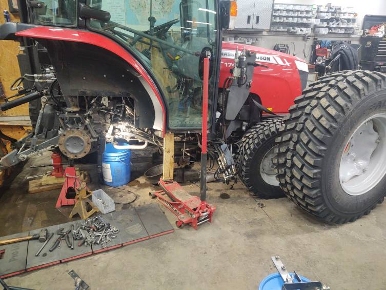

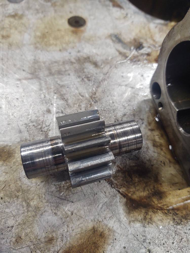

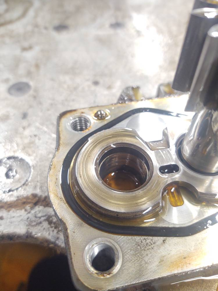

Welllll, everything has been fantastic until the other day. I noticed that I couldn't pick up the blower at idle anymore. Steering and pto clutch operation was totally normal. So onto the diagnostic tests.
Fluid level good, clean (just changed when mid pto kit went on in December), and not foamy.
Pressure gauge showed 1200psi at idle and 1800psi max when stone cold. When hot, only 300psi and 1100psi. That eliminates a suction issue because it would be worse when cold.
Relief valve removed and inspected, nothing found. Relief adjustment bottomed out, no difference in pressure gauge readings.
Next test was a bungee cord pulling a rear remote lever deadheading at 1500rpm. After about 5 minutes, the suction line to the pump was warm and steering discharge line was quite warm. Rear hydraulic discharge line was stone cold coming off the pump. Veryyyy interesting. Seems that the pump is internally bypassing somehow from the main hydraulic side into the steering side.
I tried like hell to contact Shimadzu directly to source a pump seal kit/parts availability, but it was absolutely useless. I called their USA office number and every extension went right to voicemail and all vm boxes were full.
So sadly, I had to call the dealer and order a pump and all the associated seals for $1034 shipped. I asked if i could return the pump in case my diagnosis was incorrect and they said yes as long as i didn't open it. Silly me, I ASSumed the whole tractor was under the 5 year warranty. But that's only the drive train, everything else is only a 2 year as I found out.

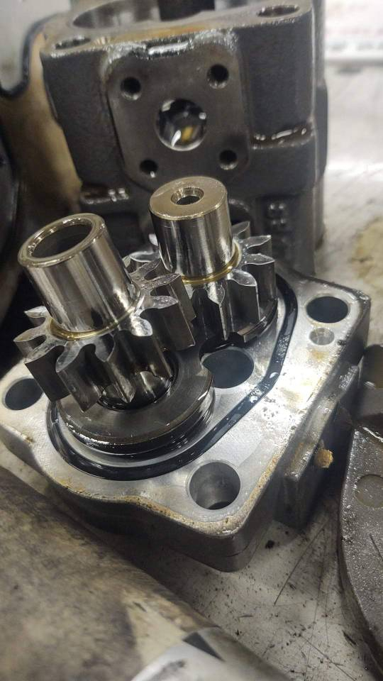

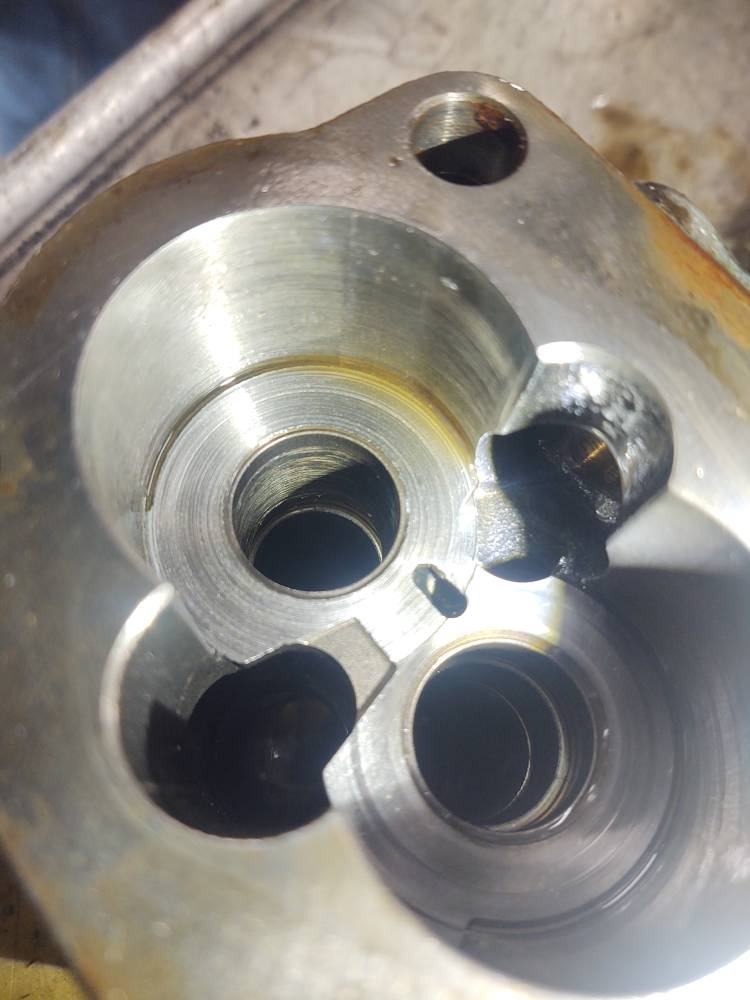

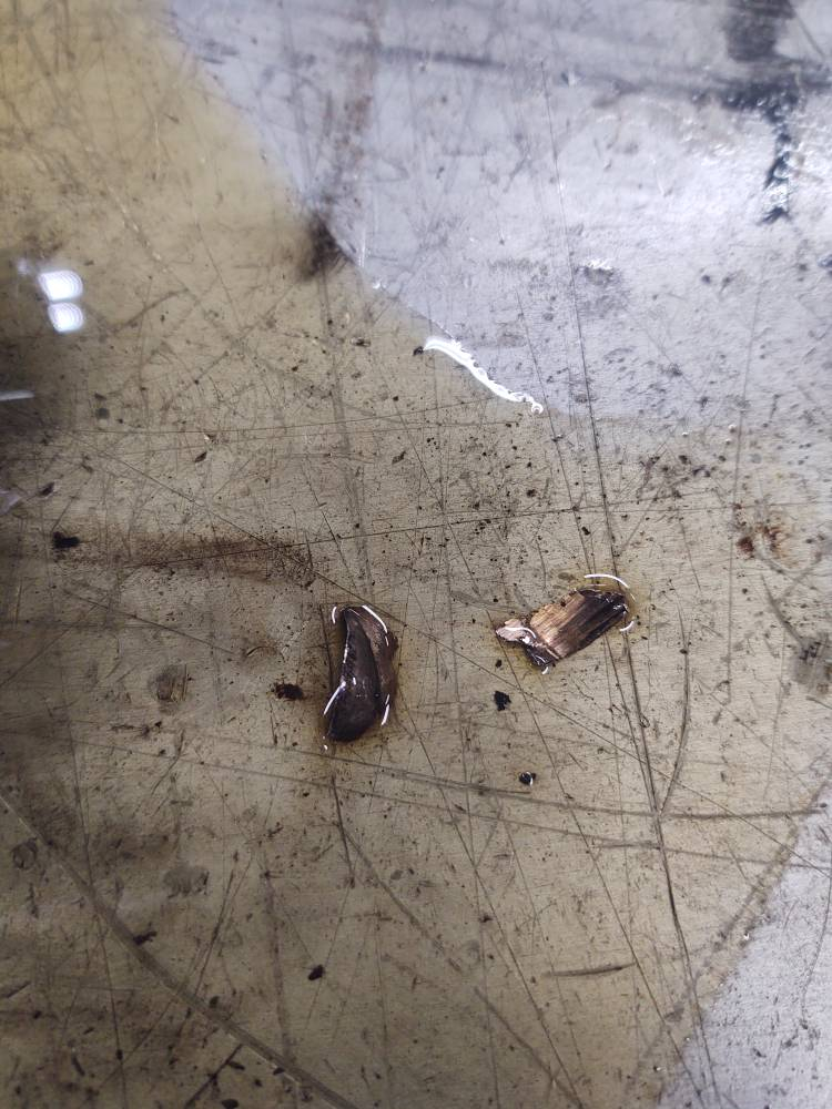

I tore into the tractor today (which was a giant pain in the rear) and pulled the pump. Tearing the pump down, it definitely was the issue. The shaft bushings on either side of lower gear on the main chamber were destroyed. The excess clearance between the shaft/bushings were letting hydraulic pressure escape and travel through the hollow lower shaft of the steering side of the pump and into its discharge line. I'm just happy to have actually found the smoking gun.
Pulling the strainer, there was definitely metallic junk stuck to it. So the cavity was cleaned out and a new strainer installed along with a new spin on filter. The 15 hour old oil will get pumped through a 20 micron filter on its way back into the tractor.

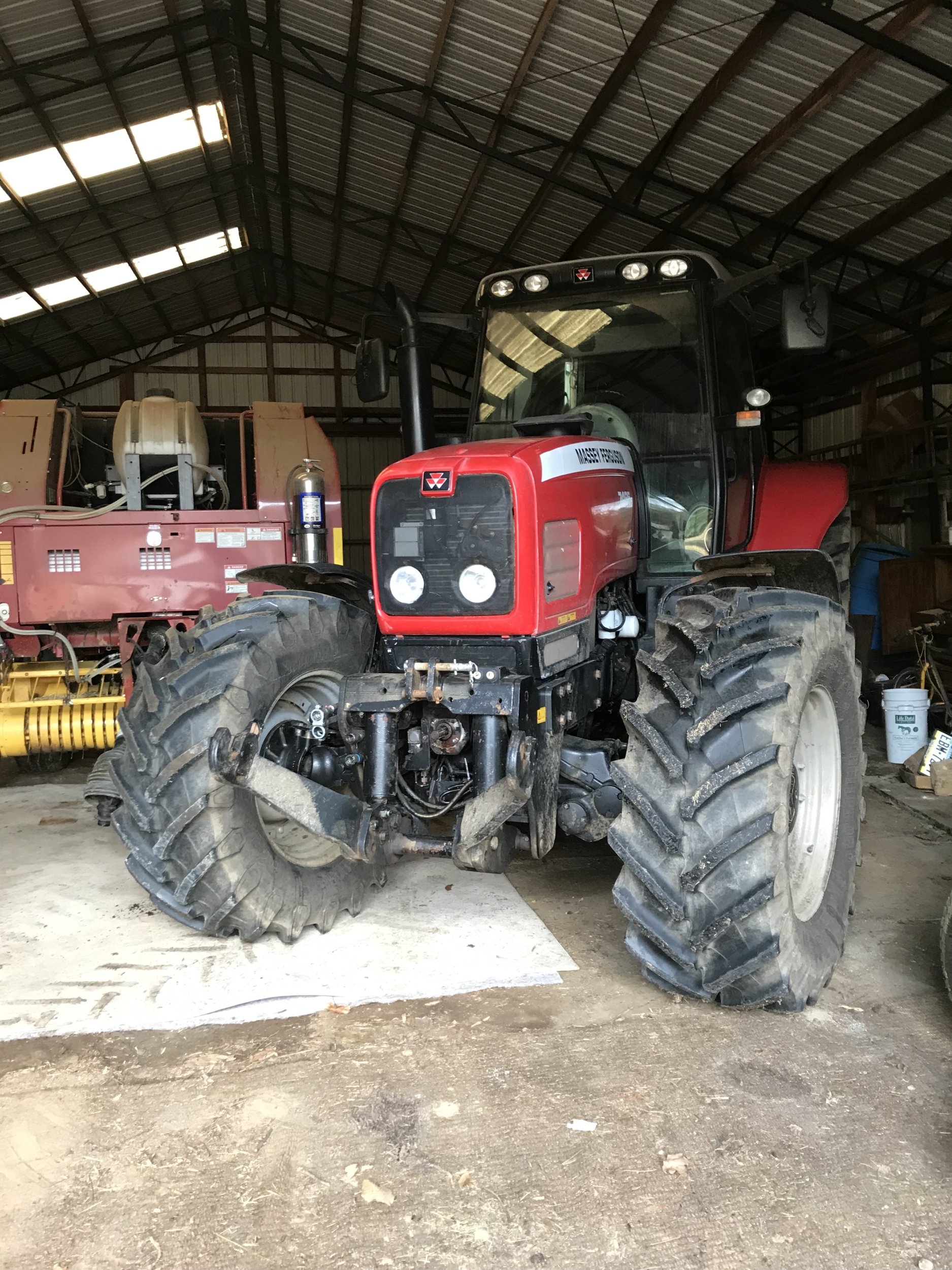

Had same problem on my JCB Fast Trac. It was a $7,000 Rexroth aluminum pump. The shaft bushings were able to move in the aluminum housing and took the pump out. Not a big fan of aluminum pumps or housings anymore.
I wonder if previous owner overheated the pump/hydraulic fluid?
My Massey 7495

Niiiice. Thanks in advance for sharing as you go through this process. You gotta fab up a question mark downpipe for it like you did for my ALH back in.... 2009? I forget what year it was but definitely long ago.
Is the intercooler going to have a fan? Or sit by the radiator? If no airflow I could see it heatsoaking and being pretty pointless.

Haha, no it won't get a question mark downpipe, it will be tig welded stainless if I have to though.
The intercooler will be out front of the current cooling pack so the engine fan will pull air through it. I'm going to weld bungs on the in/out pipes for a thermocouple to measure the delta also.
One of my euro tuner friends is tuning the ecu for me. I assume they could do a siemens on a kioti...? This is a denso ecu.
Sounds interesting, wonder if the PTO drive will be able to take it as the spec sheet says 53HP for the chipper minimum. Also wonder about enough lube in the engine and how to get the heat out of the cooler. And hydraulic heat and ... keep us updated, seems like a fun project.
Considering the size of the gears I saw up in the transmission case when I put the mid pto on (mid pto bolts to bottom of trans case), I'm not concerned with hurting them. The pto shaft that came with the chipper has a slip clutch on it so in theory it's a pretty safe setup there also.
Since there will be zero load on the tractor hydraulic system running the chipper, I see no reason for any additional heat to be made there. Yes there will be increased oil and coolant heat to be dissipated, but again it will be monitored and addressed as necessary.

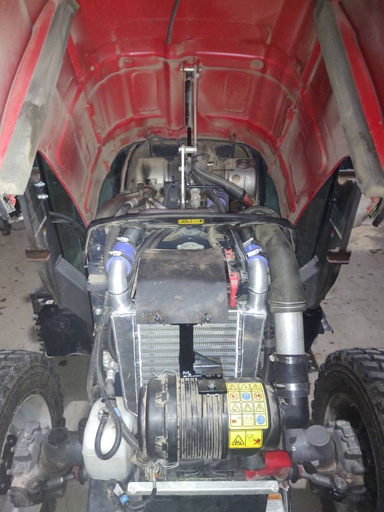

OMG, that is a major mod.
   / Joined the red club! #80
Nice. You had that much room between the air filter canister and radiator already?
