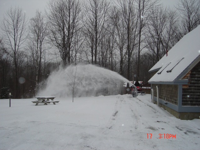

Husky-- same issue here. While blowing snow yesterday, I found I had to hold the joystick "up" so it would stay in float; kept popping out when going over uneven ground. I don't remember that happening last winter. Don't know if that's normal or not, but easy enough to overcome- glad the 2310 has power steering!

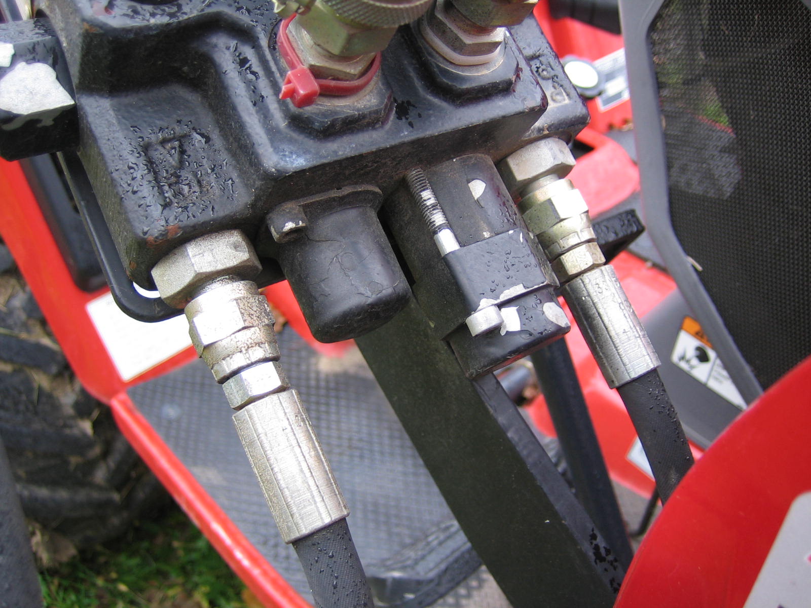

Try loosening up the screws on the detent cap of the lift spool (lift spool should have lnger cap), moving the joystick back and forth a little and retightening the cap. It could just be a minor alignment issue.
Also had the problem with the seat switch last year, and have a jumper ready & waiting. So far I haven't needed it, however.
It's certainly not normal. The driveways that I blow are very uneven, side to side and front to back and the blower always floats over it well even with the wear bar flat down on the asphalt. The adjustment mentioned by jeepcj7 should help.
At risk of showing my ignorance (probably too late already) :rolleyes: - where is the lift spool, what does it look like, and how do you access it?

My guess is you have moisture in the cap and it is restricting your detent mechanism when it freezes. Take the cap off, clean well and re-grease. Should be good as new. If you should happen to need a new spring, I replaced my with an old VW brake pad retaining spring. Works perfect! Happy tractoring.
   / Joystick float #9
Thing,
Is the cap what is called the "Joystick Assembly" in the parts book? From the parts illustration it looks like that's a single unit. And where is the spring you describe?
