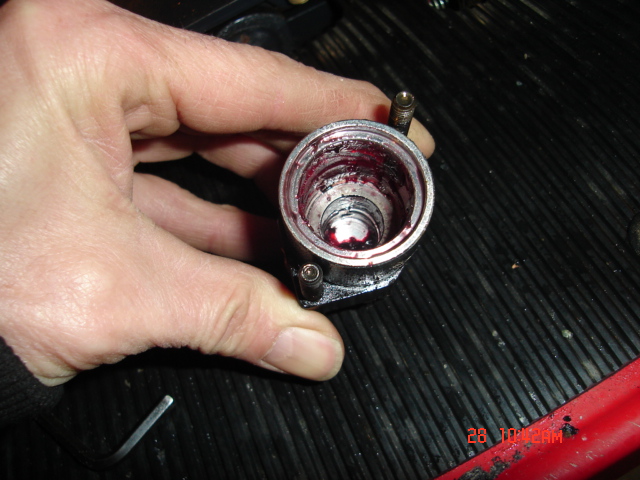

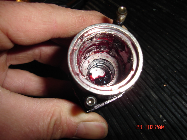

Well, I just did the same thing, and saw what others have described - no broken springs, not condensation, just a bit of red grease. I tried moving the lever with the cap loose, tried rotating the cap 180 degrees, tried moving the split ring, tried removing some of the excess grease from the spring, and it still doesn't work properly.
I also took a hair dryer to the cap and after it got warm, it *seemed* to work a bit better. I could take my hand off the lever and the front wheels did not come off the ground. But when it cooled back down again, the problem returned.
It's hard for me to believe that the hair dryer would raise the temperature of the cap enough to cause it to expand all that much, but since that's what Mr. Fitzgerald (junior high science teacher) taught us that heat does, I'm wondering if that's the cause?
However, I can't seem to consistently demonstrate that heat solves the problem, so maybe it was a coincidence.
I'm stumped and will call the dealer tomorrow to see if they have other tips. If not, how does the warranty on these things work? Do I have to take the tractor to them? Pay for the at home service call? Or what?
Seems like such a simple thing - and it's interesting that at least 3 of us are having the same problem. Makes me wonder......

If someone has used their float setting recently and knows that it is works as expected (stays locked in float over rough terrain). Could you inspect your detent cap and let us know if you can see anything out of the norm from the pictures that irvingj posted?
I'm with you on this seeming to be a fairly simple mechanism. Puzzled.

I am thinking you have moisture in the grease or the manufacturer used a low quality grease that doesn't work so well at cold temps. I would try cleaning out the cap with some degreaser and see if it works better. If it does, I would put in some new grease and see how it holds up. From the pics it appears MF is now using a different float "mechanism", lets hope it doesn't prove to be unreliable.

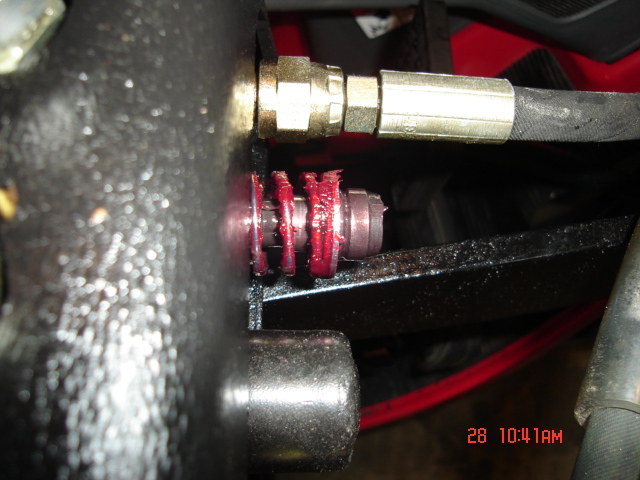

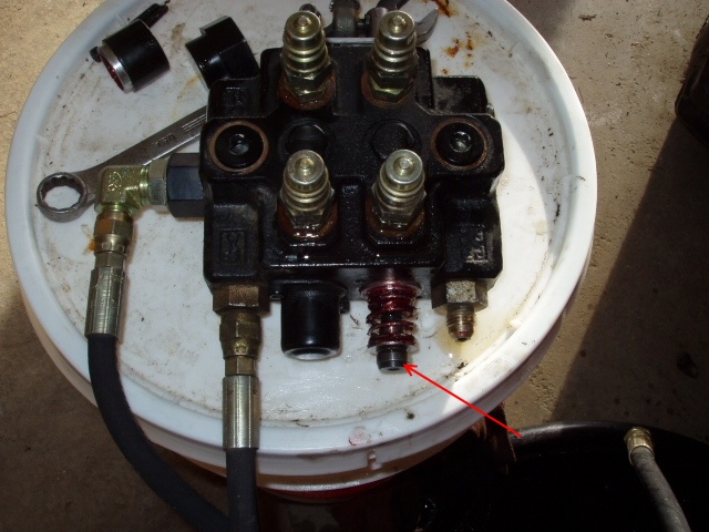

When you remove the cap, at the end of the control rod is a bolt like thing that controls the spring tension (see the attached pictures) - it takes the same 5/32 hex key as the screws that remove the cap. In my case, this was loose, which caused the float spring to not center and catch in the proper place. He cleaned the grease off the threads, applied a drop of Loctite, then put it all back together - et voila! It works perfectly.

Well, we have no joy. Took apart again, only to find the socket-head "bolt" on the detent shaft was very tight, not loose at all....
Cleaned off grease anyway, just so I could see it more clearly. The washer on the end of the detent shaft seemed to be centered just fine. Now I can see the groove that the split ring slips into. Perhaps removing some of the grease will help--? Everything else seemed OK.

The float operation is another function for the spool being held in position by using a grove in the spool, and a ball and spring. Some may be adjustable, but otherwise, clean the area of any trash or debris, and either replace the ball and spring, or cheat a little and put something over the spring to compress it a little more. Water, rust, ice, dirt are just some things that will interfere with the float position. A bungee cord will work if nothing else.
