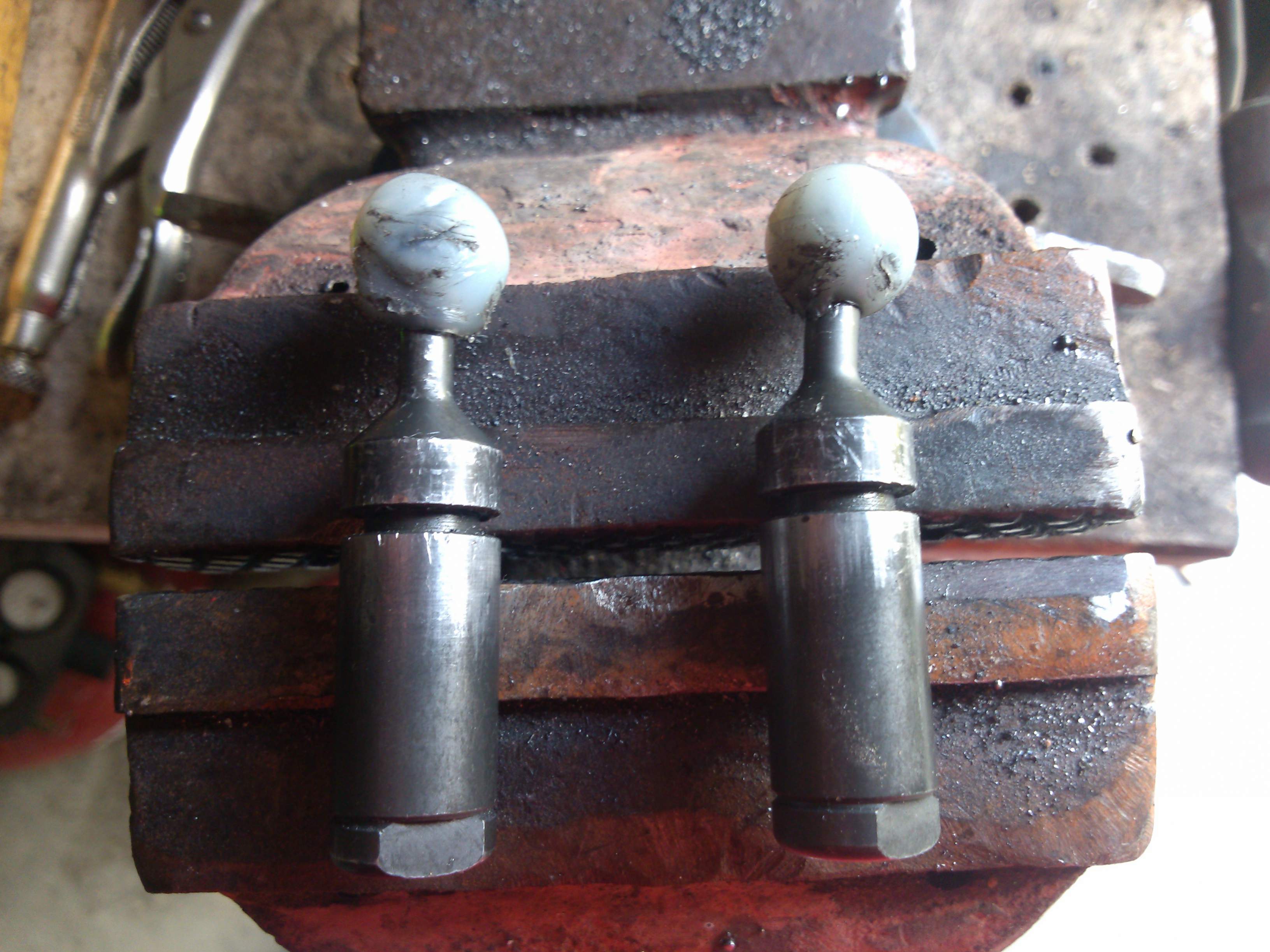

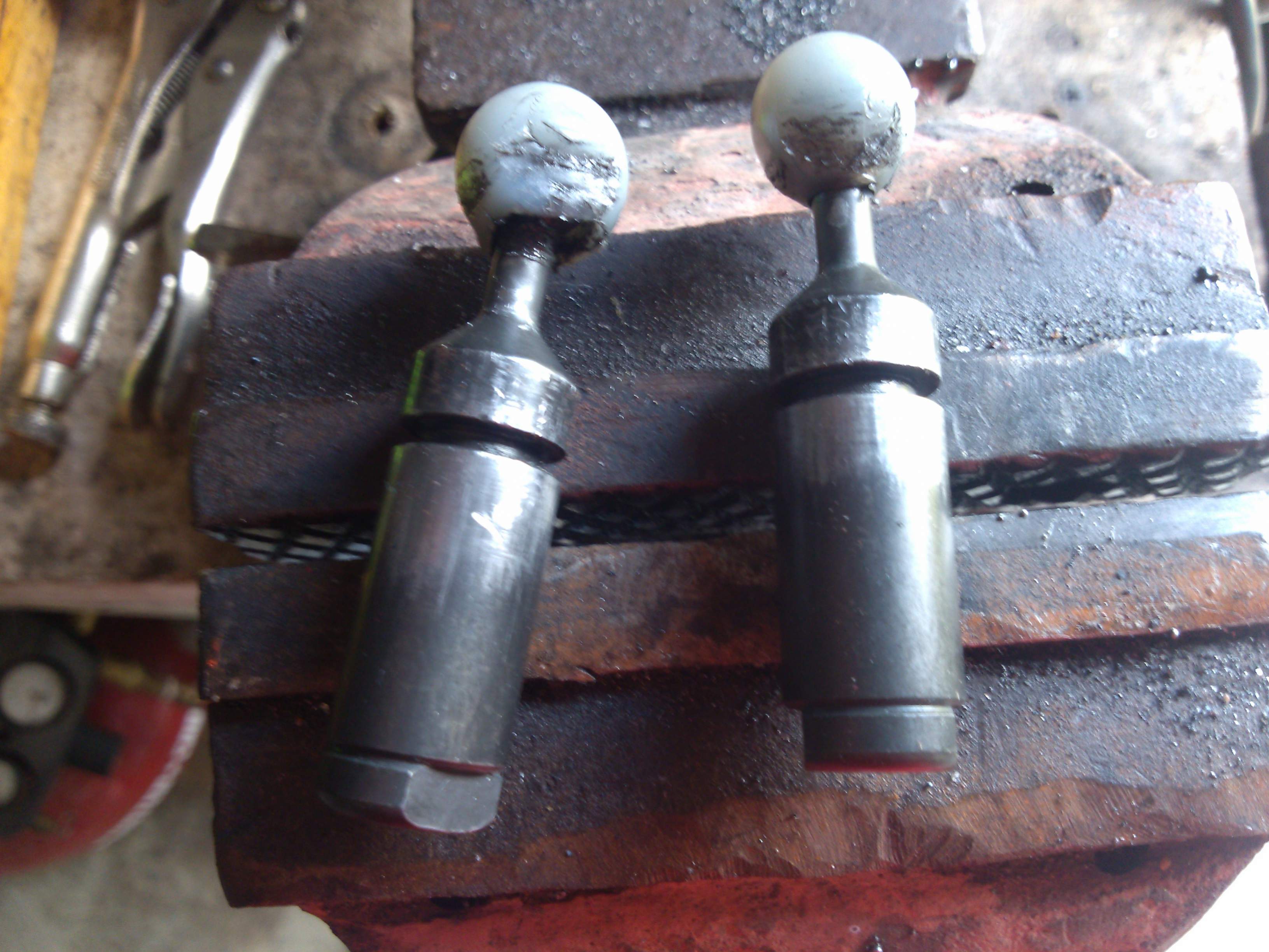

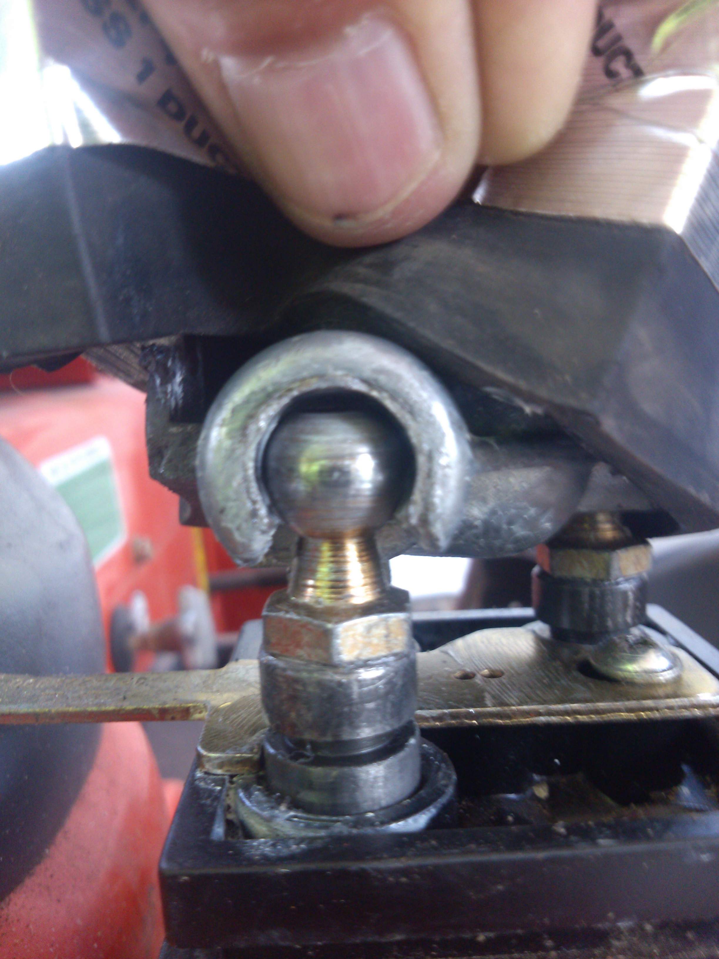

So latest, the parts did work. I had to add shims in the cinematic head, the balls were slightly smaller than the original, other than that it all worked out, nice and tight joystick functions. The metal on the Kioti parts was soft and easy to drill and tap.
   / Joystick valve pivot
#17
Here are some pics for future reference, for someone. I looked for the stainless steel shim stock but could not find until after the unit was back together. Wife found a pipe that I used, if it wears out will use the SS shim stock next time. I did replace all 3, they all look the same.
