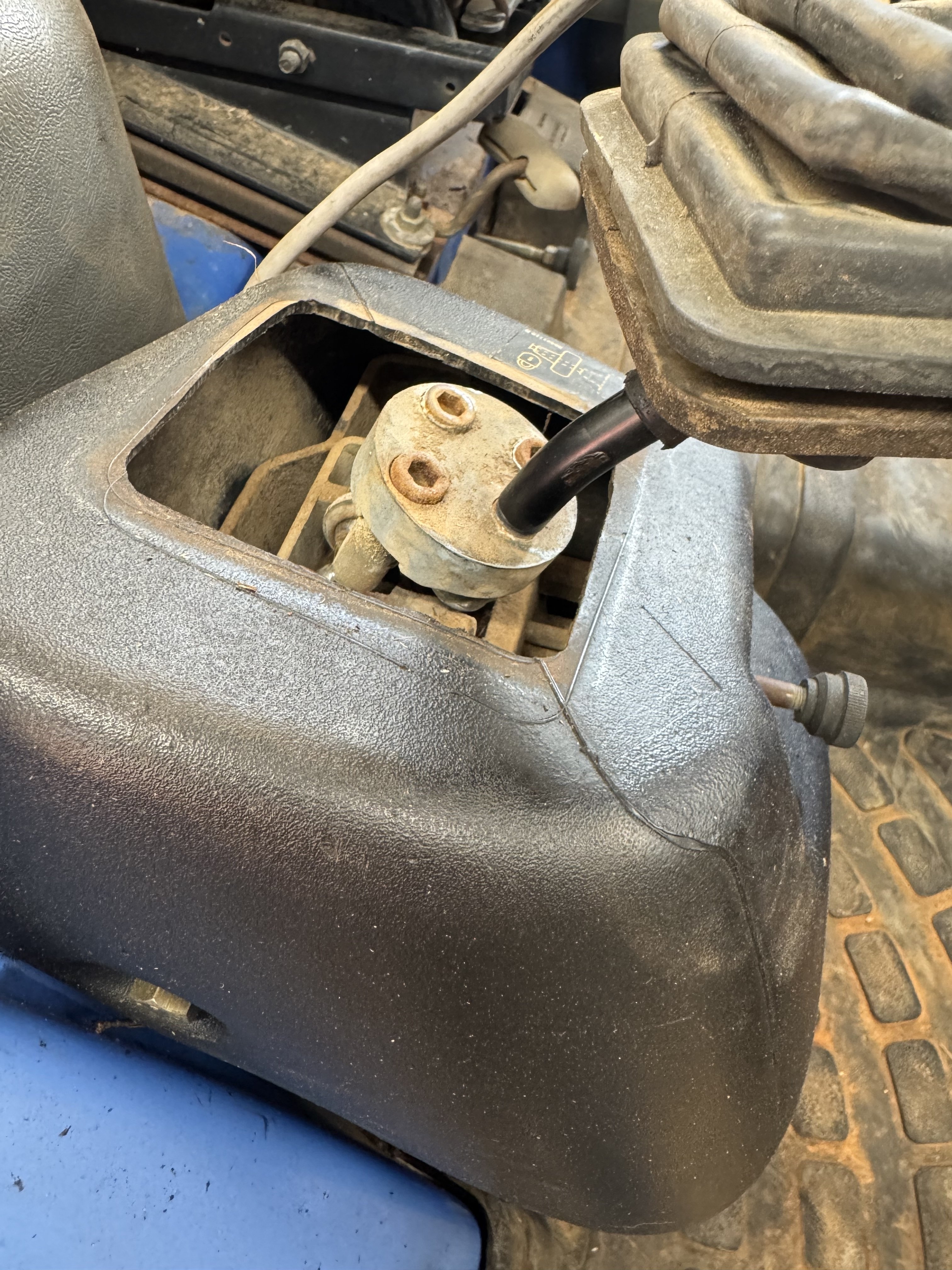

/ Joystick #4
If directly attached I would carefully remove or slide the protective rubber boot up to confirm the movement of linkage and valve spool.

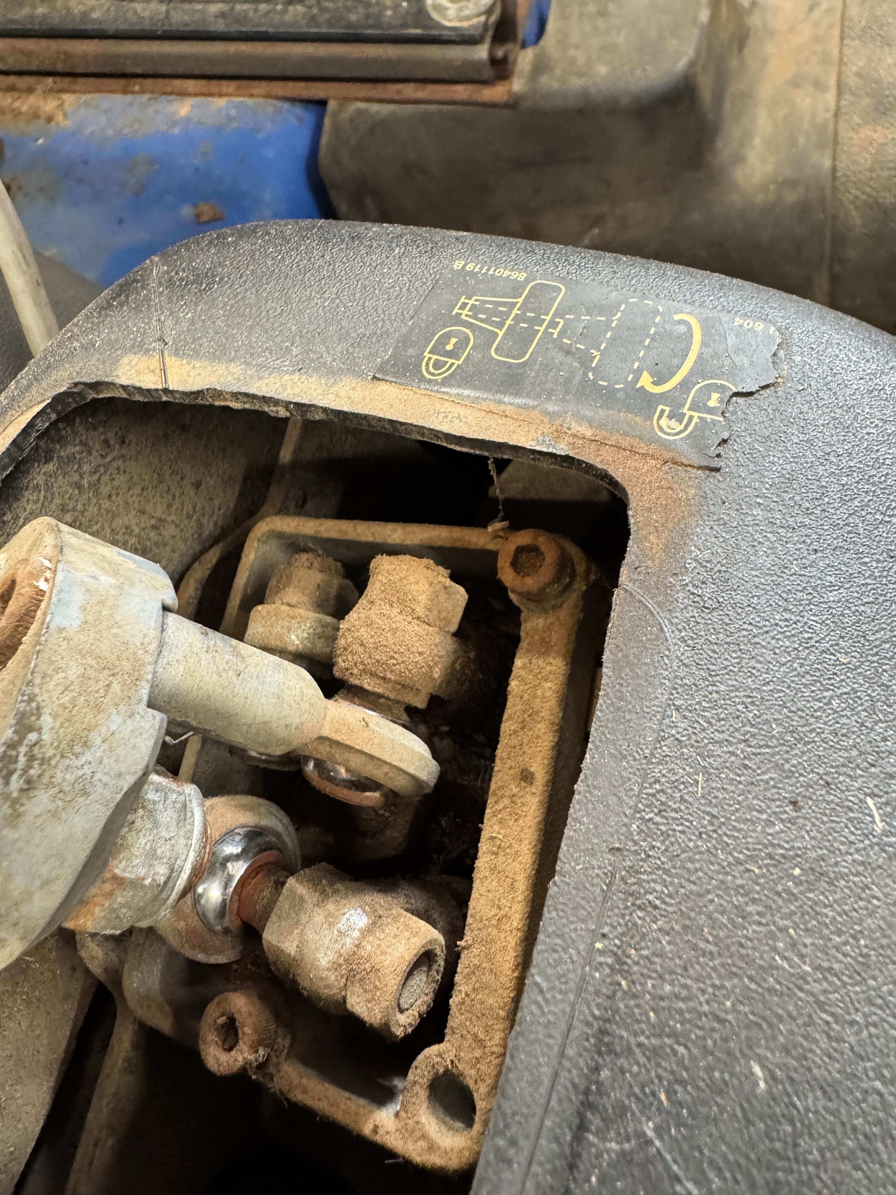

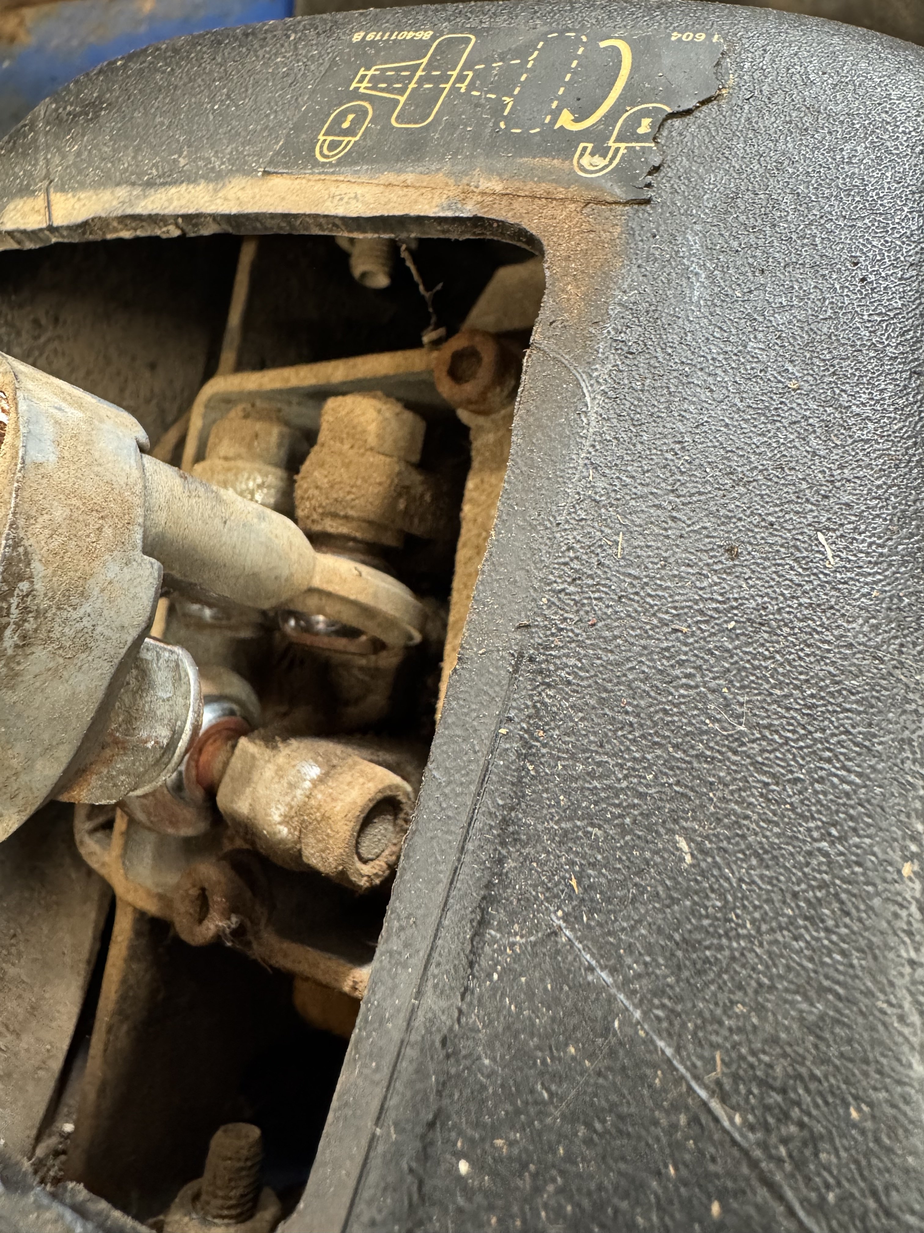

It locks into the float position see first picture.
Here are some pictures of the joystick connection and it looks normal.

/ Joystick #8
since it locks into float detent the spool has to move past normal lower. If you hold joystick in normal lower position do you see the loader try to move. I.e. do the hoses stiffen and sound like pressure it at relief valve setting? It should do all the above.
If you try to feather the loader so moves very slowly will it lower?
Everything points towards a failing quick disconnect with exception of oil must pass through quick disconnect to lower.
This is an unusual failure mode..

/ Joystick #10
Raising slowly would point towards the spool not centering properly which can be caused by linkage binding or the centering spring assembly being full of crud or depending on style coming apart. Spring assembly is located under cover on end opposite the joystick.
If, repeat if my memory is correct the lower and float is operated by pulling the spool towards the joystick. If this is correct then when in spring center home position both spools should extend out of valve housing the same distance. Again looking at pictures it looks like one may extend farther than the other but could easily be optical illusion.
I would 1st try lubing all the ball joints on the joystick control. The pictures may be deceiving but they looked dry to me.

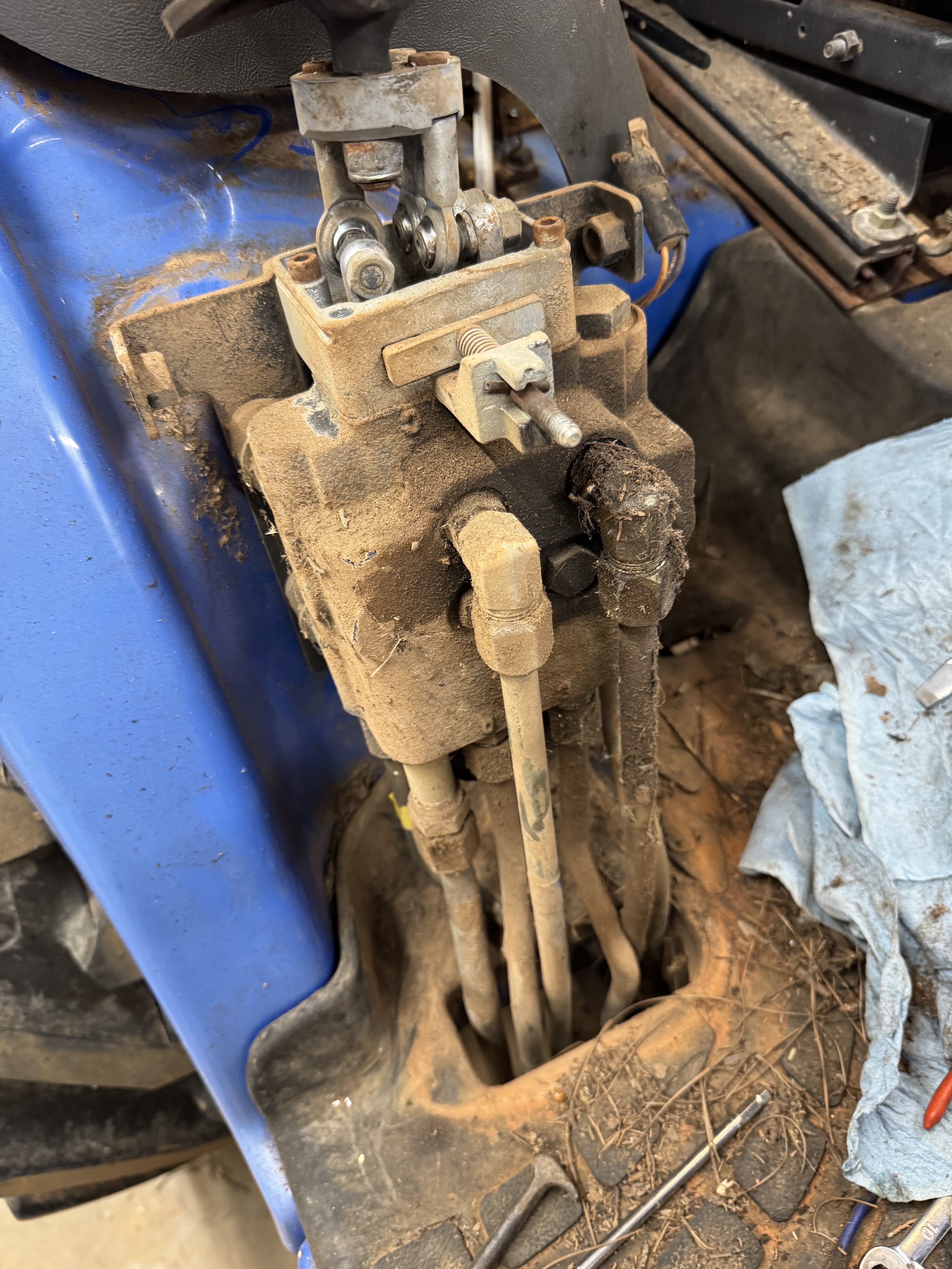

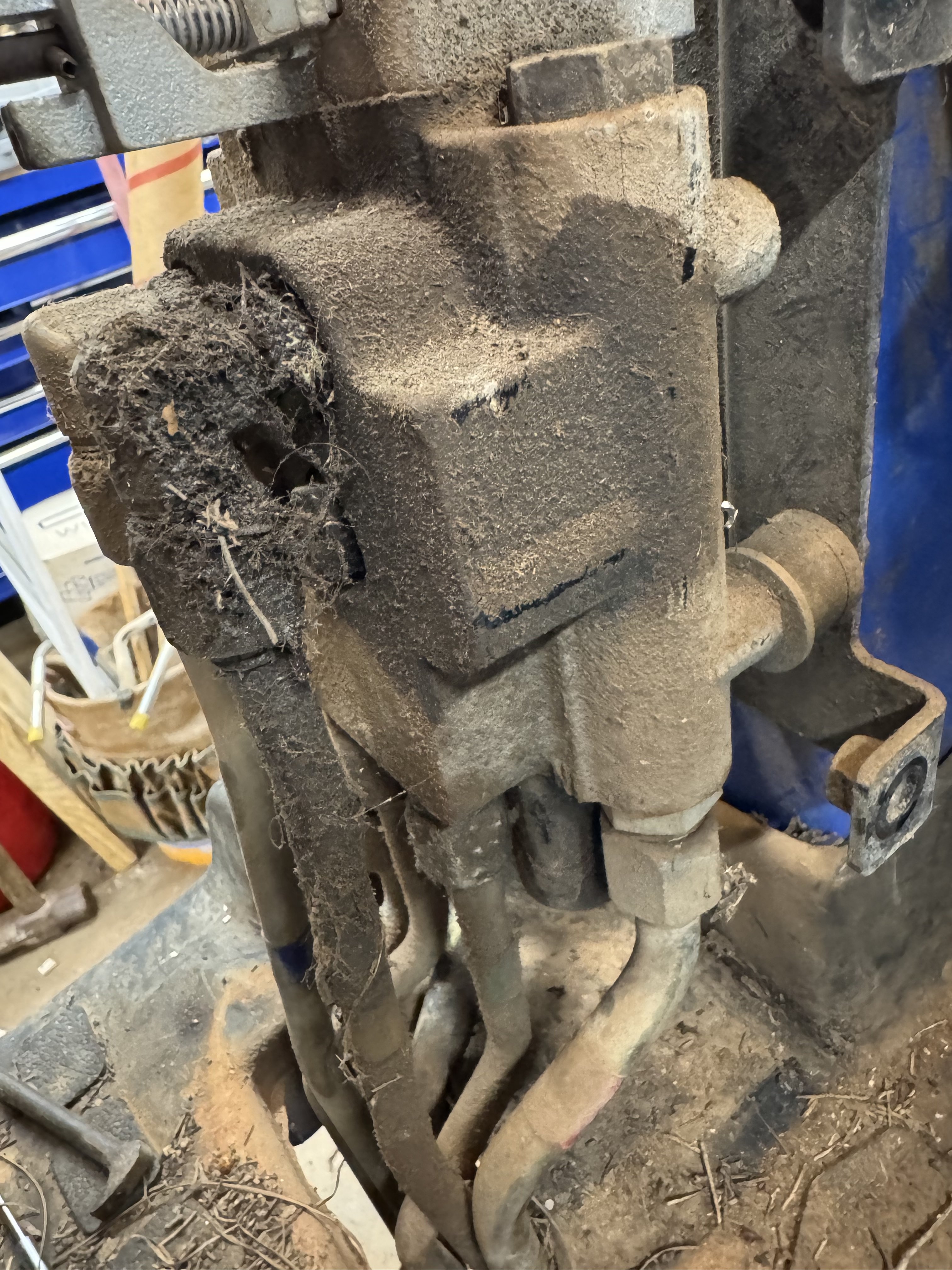

/ Joystick
#14
I loosened and reseated each of the four couplers, but it didn’t change the issue.
I then swapped the lift and tilt lines (all four) and the symptoms switched in sync with the line swap. In others words the tilt position lifted the loader and lowered it without issue. The lift position which was now the tilt function would not move in but one direction.
I believe this means the issue is in the loader valve itself.
The valve which looks like it’s not been uncovered since it’s installation at the factory. It does have some slight seepage and it’s on the lift side if I am understanding it correctly.

/ Joystick #15
Not sure what could fail in the valve to cause this problem but I guess anything is possible.
I would probably replace both of the male and female quick disconnects on the lift lower circuit before replacing the valve since much easier and less expensive than valve and would totally eliminate a QD as the problem but then being armchair mechanic it is easy to give advice and spend other peoples money😁
