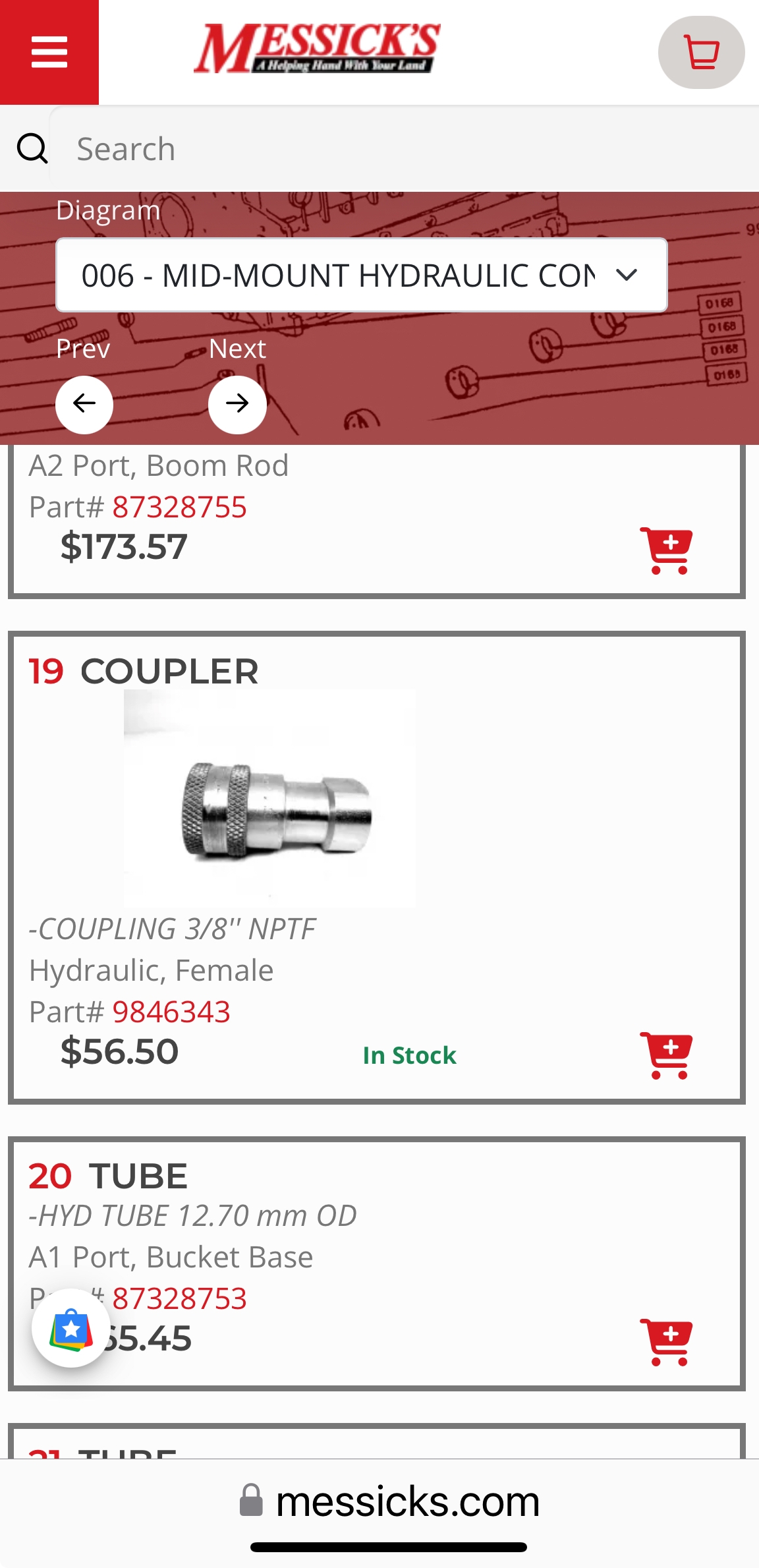

Sorry I was more referring to the size I’m having a hard time finding the male end for New Holland version (COUPLING 3/8" NPTF) Part# 9846343.
I will look at the sites you mentioned to see what they have.

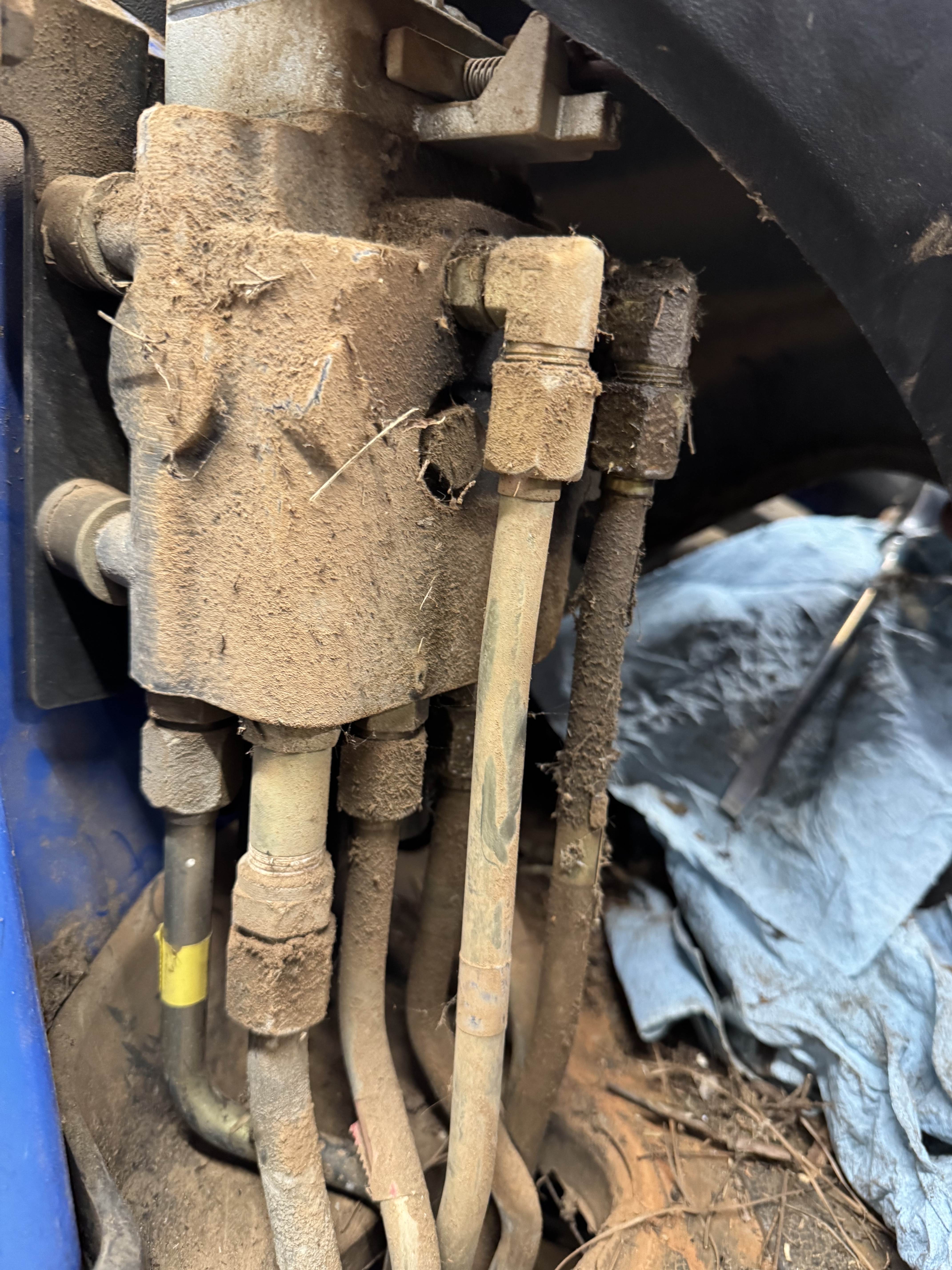

Well swapping out both (both sides of each too) the couplers on circuit that raises and lowers the loader arms did NOT fix it.
It still only lowers when in the float position and still creeps up in the neutral (no movement position) at the same rate as when this started happening.
So I guess the next thing is to either rebuild the loader valve or replace it.

Certainly not a normal run of the mill failure that you are experiencing. If I remember correctly you swapped the lines from raise / lower to the curl / dump spool and then the loader raised and lowered but now curl / dump didn’t work so it certainly points to the lift / lower spool being the problem.
Not sure what else to try at this point.

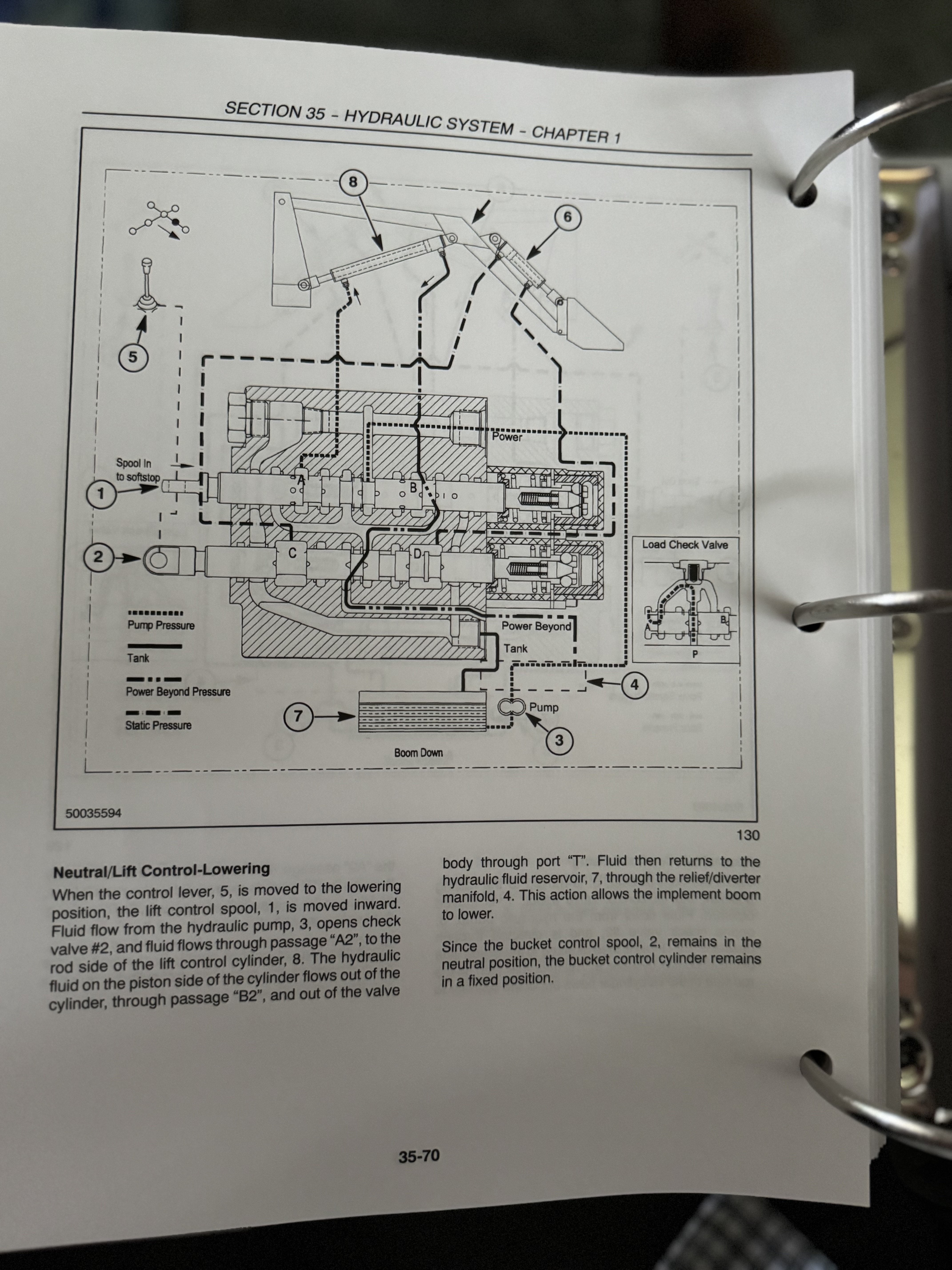

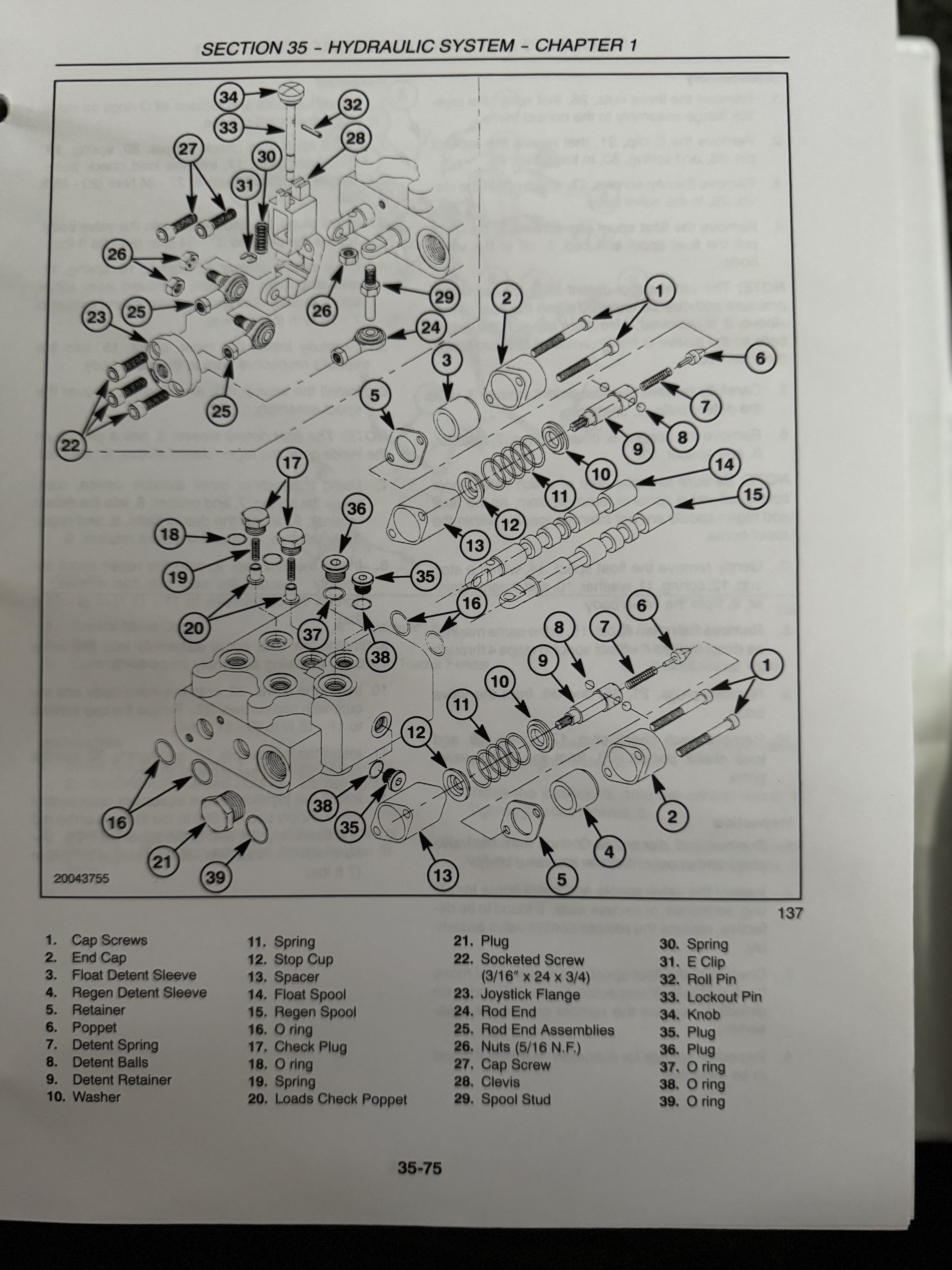

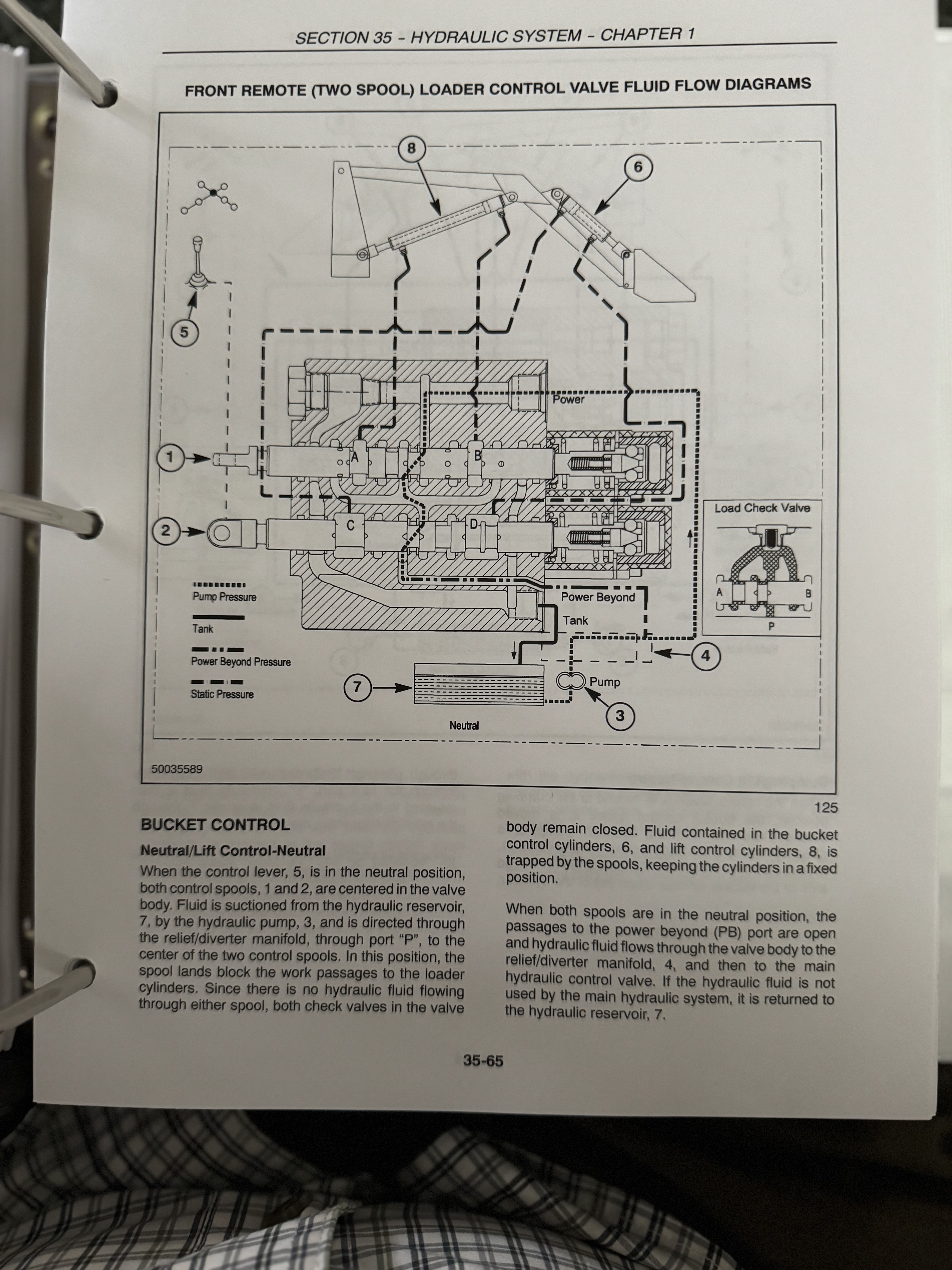

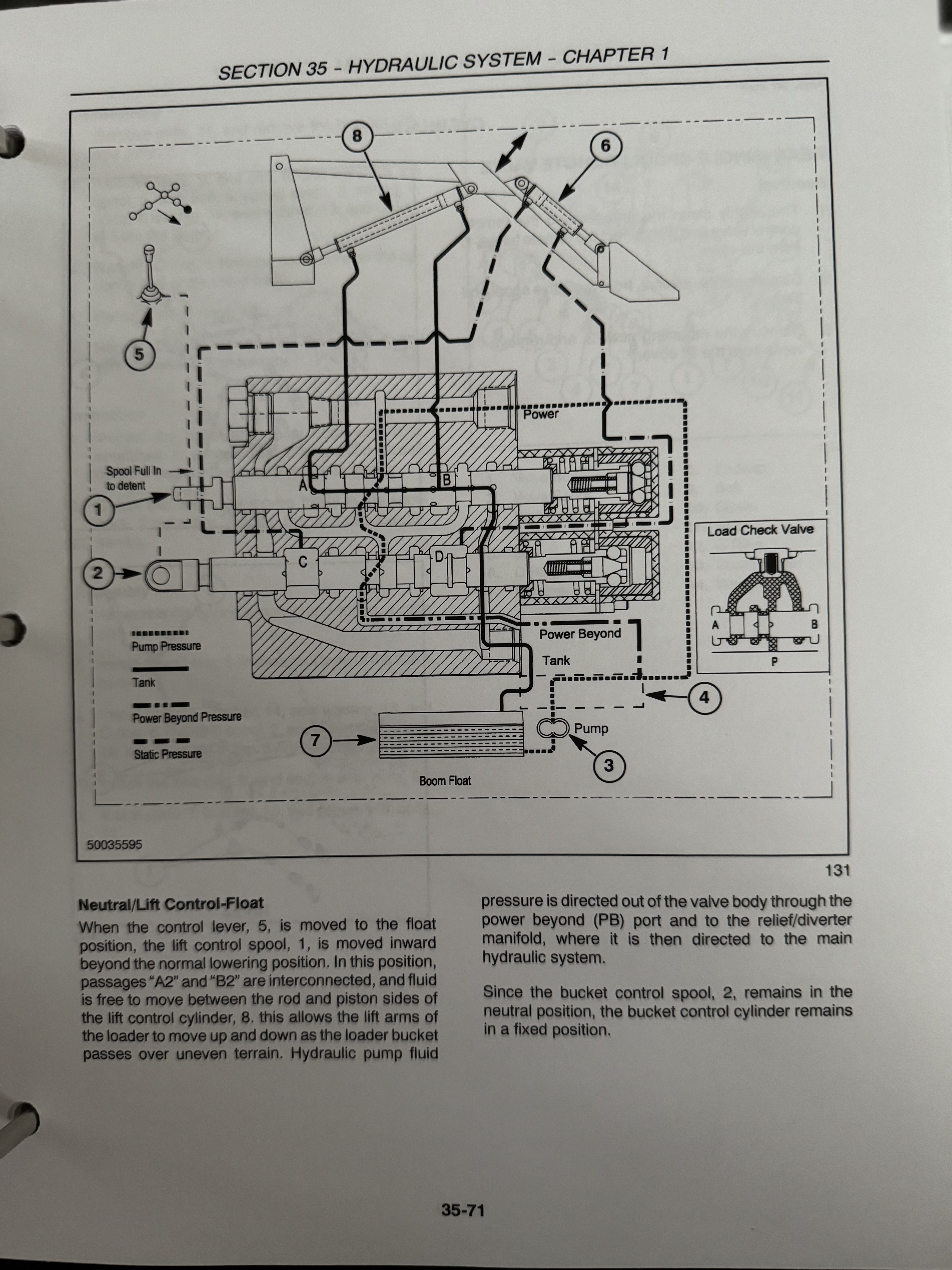

My service manual has the loader valve in the hydraulic section.
The attached pictures show the relevant flow diagrams for the positions not working and the parts breakdown.
It looks like in the first two flow diagrams the oil flow is not flowing properly as it is only lowering in the float position.
Also in the last flow picture (bucket control) oil in going to lift cylinders rather than stopping B on the lift spool (top one listed as #1).
I wonder if the load check valve listed in bucket control could be messed up (lower right of diagram). But it looks it’s part of the spool #1.

/ Joystick #34
Load checks are typically separate from the spool and usually just prevent oil flowing from the load back into the pressure port. Normally if one fails it will allow the load to drop when trying to raise vs preventing it from lowering.
Also looks like your valve is a series parallel design where return flow from raise lower is directed back into the curl - dump circuit so you can lift and dump or lower and curl simultaneously. Did your loader do that before it quit working?

Diesel
In studying the valve Assembly on img 1158 you posted the centering mechanism item 9 screws into the end of the spool. If this has worked loose and backed out a turn or two it could potentially allow lift to drift up vs being centered and prevent lowering since spool would no longer be traveling to correct distance.
If you decide to take this apart removing cover item 2 may or most likely will allow item 6 & 8 to fall out.

#39
Diesel
I like your suggestion.

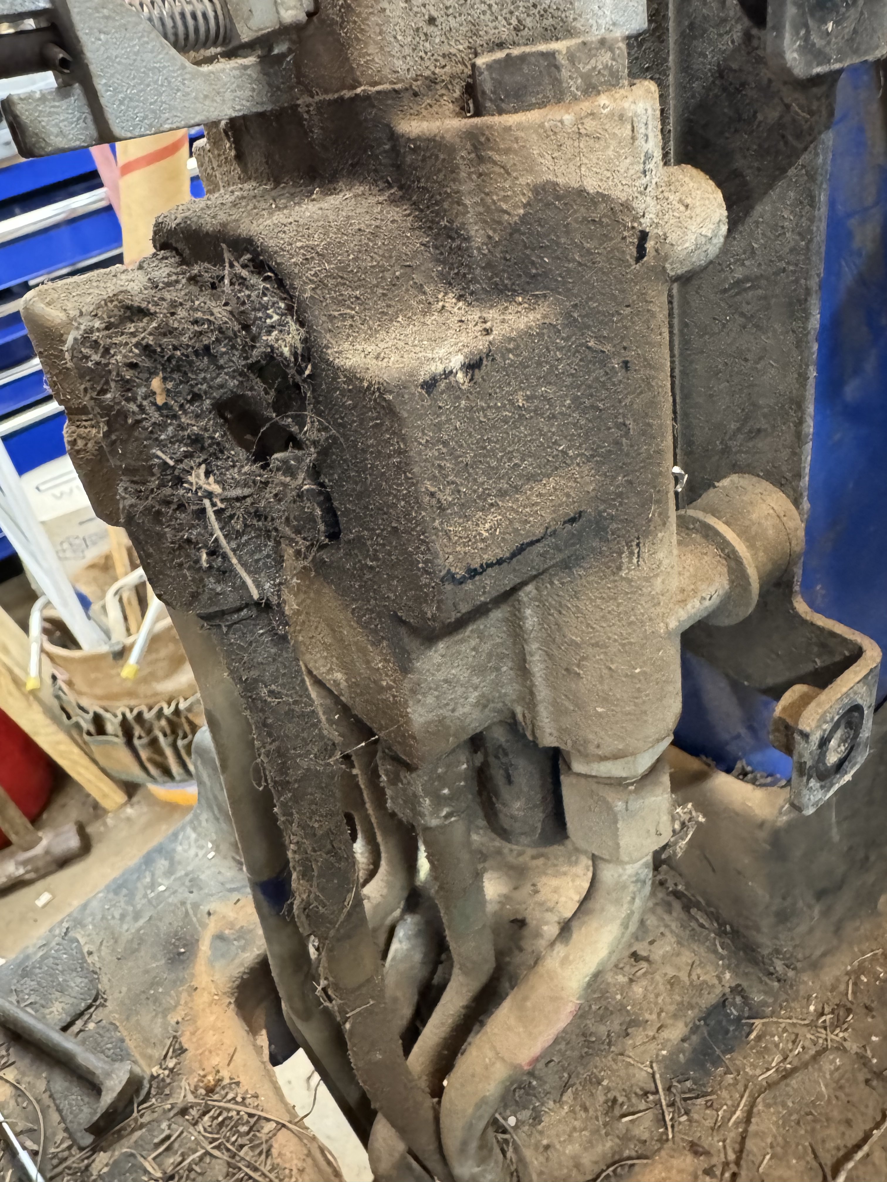

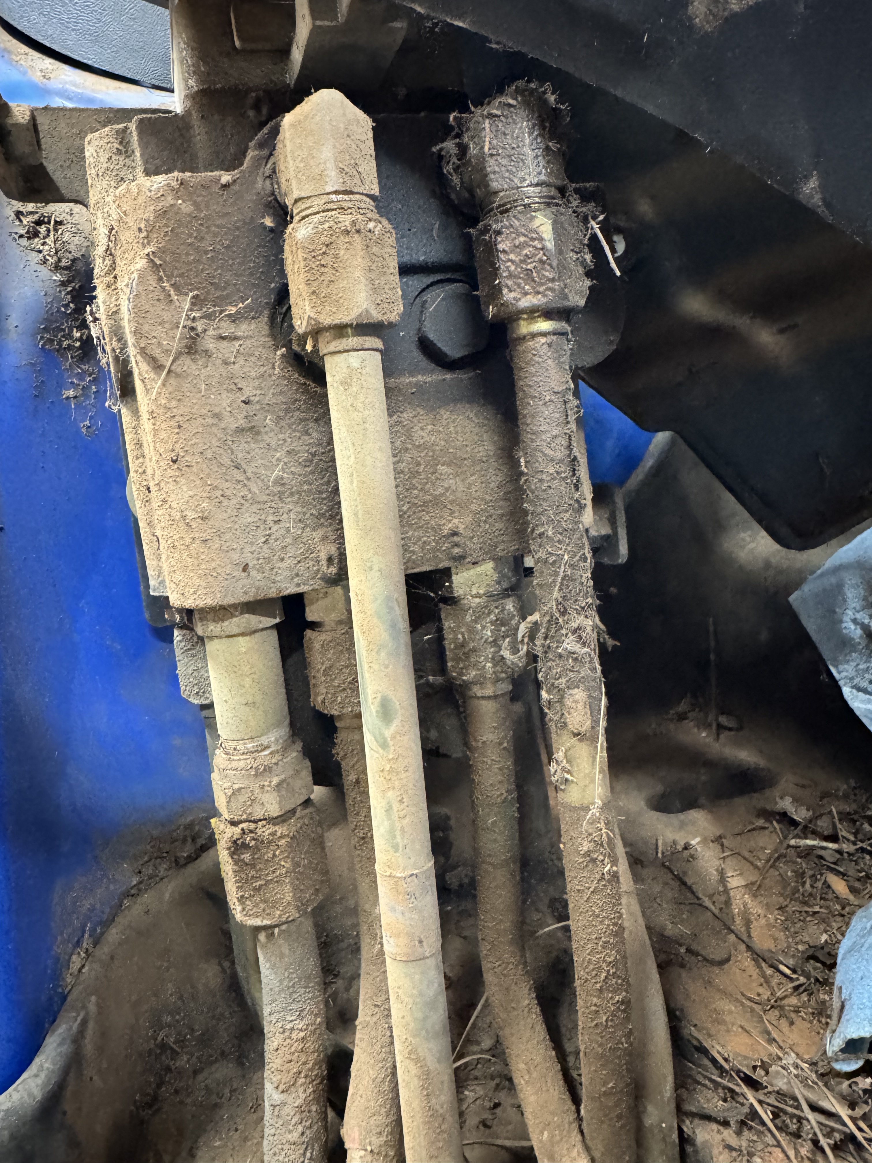

Background my joystick was working loose when I first got the tractor. I finally got it stopped by adding a locknut to the bottom of the shaft.
So it may have vibrated #9 loose and be worth checking.
It will probably require removing the whole valve to get to #2 due to the hard lines.
