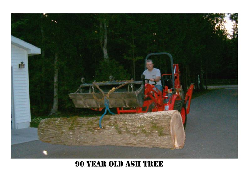

I can't figure the ratings on those CK30's with a KL130 loader either. The CK30 has got an engine 50% bigger than a CK20 and yet it supposedly bench presses only 50 lbs more when comparing loaders. So say the specs at Kioti's website. I think it has more to do with the hydraulic pump in each tractor but it doesn't make sense anyway. Common sense would dictate that one is figured too conservative or one is exagerated.
I don't think I am going to pay a whole lot of attention to those figures however conservative or exagerated they become. All I know is my CK20 with a KL120 loader recently clean lifted an ash log solid/green measuring 23" at the butt an 17" at the top and was over 8'. The log tables claim it weighs 960-1050 lbs. That was off the front end of a reinforced bucket and thats plenty for that little tractor but it did it. That CK30 and KL130 loader I know can beat that.
Oh, one more thing. When I actually tried counting the age rings on that stump it turned out to be more like 150 years old not the 90 listed below the picture. (See below picture) This photo is undoctored but taken at dusk so flash was used.

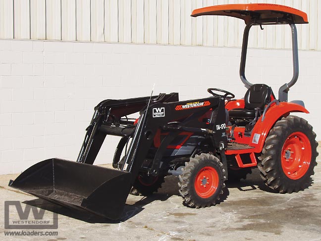

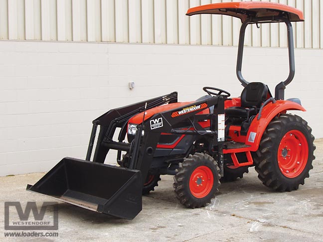

You are not the only one who gets frustrated when comparing specifications for loaders. Mfg are "supposed" to follow guidelines for consistency for comparison; what actually happens is they find ways to elevate the lift capacities so they "look" better on paper than they will actually perform. What really matters is the "full working capacity" of the loader. How much will it lift at the full height at the FRONT edge of the bucket.
Ways the numbers can be skewed:
Changing the hydraulic pressure capacities the loaders are tested at
(i.e. a 250 pound increase in pressure (2500 to 2750) resultsin 300 lb increase of lift capacity)
Cylinder size will also tell you a lot about how much the loader will lift.
How far the loader sits out front of the tractor is also a good indicator of comfort and eliminating that "pucker" factor you guys always talk about. The closer to the tractors front end, the more it will lift and the rear end will stay put. (i.e. see photos. The smaller loader (TA-111) sits back further on tractor and has nearly the same lift capacity as the one with the higher lift (TA-170))
Lift height directly affects the lift capacity.
CK30 with TA-111 at 8'3" lifts 1400# (2" cylinders)
CK30 with TA-170 at 10'2" lifts 1450# (2" cylinders)
CK30 with TA-175 at 10'2" lifts 2250# (2 1/2" cylinders)

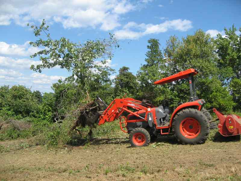

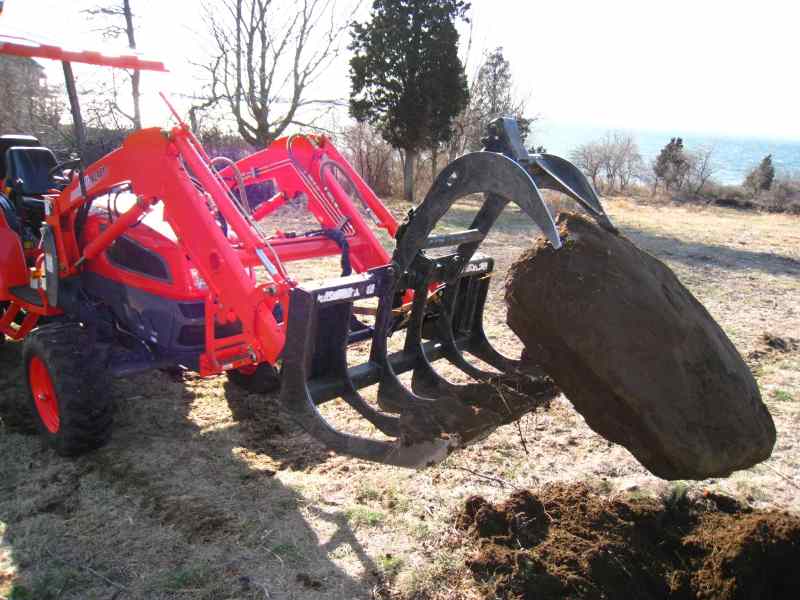

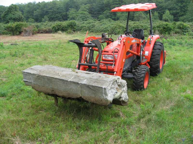

As a former satisfied CK20/KL120 owner I always thought it was weird that Kioti had a relatively wimpy upgrade in loader capacity on the CK25/27/30/35. The Woods is a good choice but will cost more and makes comparisons with other tractors necessary as you have pointed out.
When I decided to upgrade from my CK20 I considered the CK30 as the horsepower was probably enough but I couldn't get my head around the lack of loader strength as that was my primary motivation for upgrading. I finally decided on the DK40se with a more than doubling of loader capacity (nearly triple) over the CK series. Never looked back. 2700lbs of lift capacity and something around 3700lbs of breakout force is a beautiful thing. I sometimes regret losing the convenience of a smaller tractor size but then I go out and rip up a few stumps or drag a big rock out of the ground and know I made the right decision. Given the premium for Kubotas, I would imagine that a DK40se/KL401 would only be a slight stretch from what the L3240/LA724 costs SO LONG AS you get a competitive bid from a high volume Kioti dealer (Mom and Pop Kioti dealers are notorious for trying to get list price which never compares well against a discounted Kubota).
I don't think that the KL130 is weak it just is out of proportion to what is available from Kioti at the 20hp range (KL120) and the 40hp range (KL401). They should be able to mount a loader with 1400lb or better lift for those larger CKs and I'm surprised they haven't addressed it.
