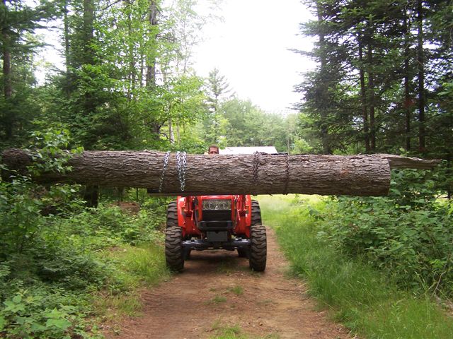

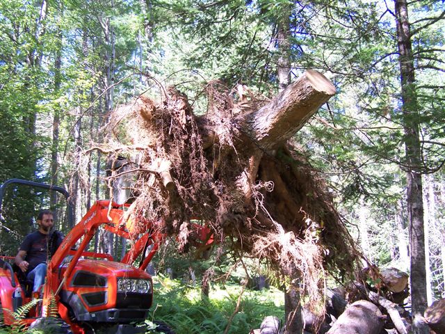

Yota,
Here are a couple pictures a customer sent to me (not re-touched)of his KL130 loader at work.
Keep in mind that his tires are loaded and he has a backhoe on the rear.
This stump and log are maple and still green. As you can see, the KL130 is able to lift well over it's printed capacity.
KiotiDave
