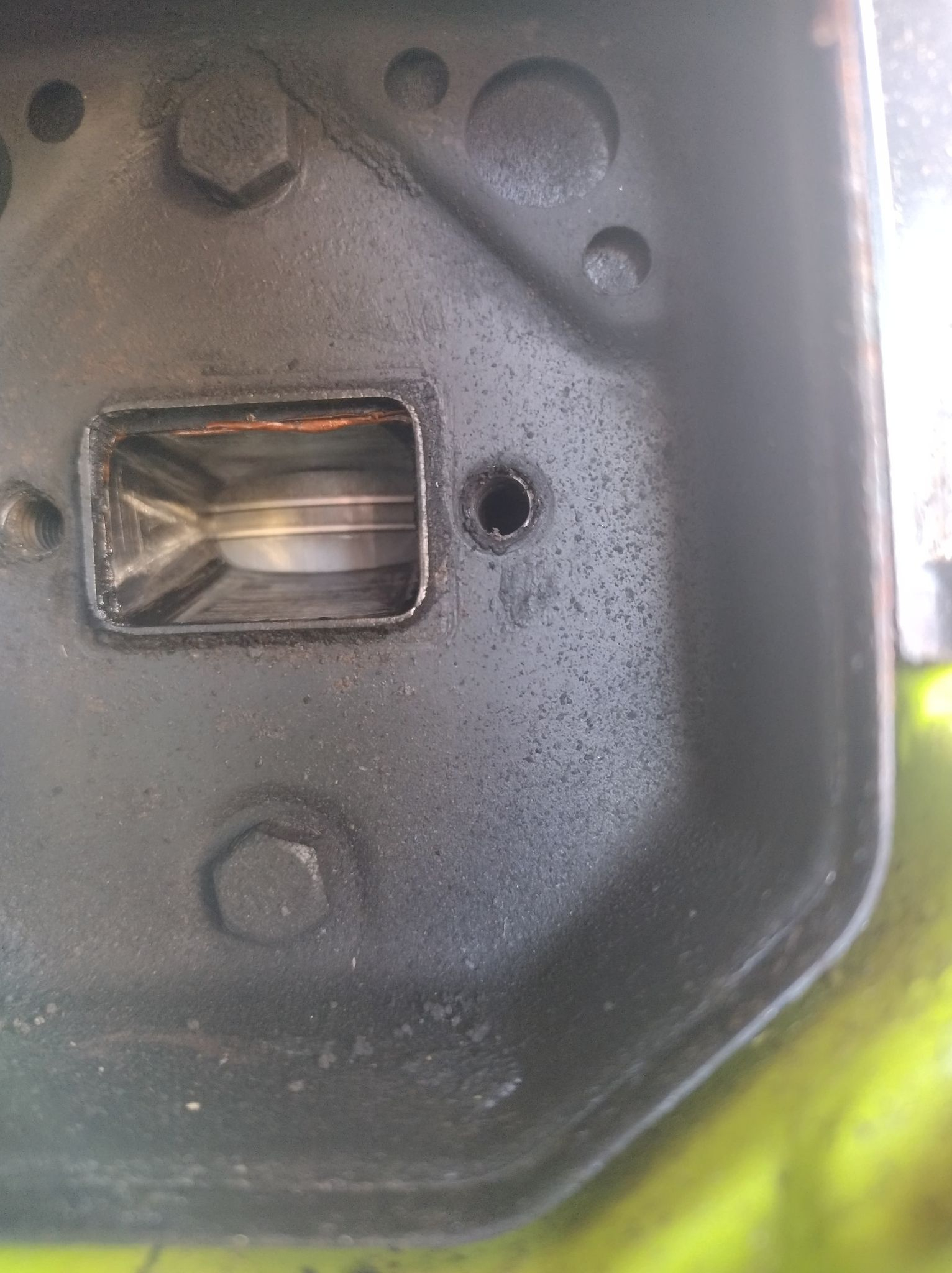

I made up a replacement exhaust port gasket to fit in where the original had gone missing on the old ProMac 10-10s/ It's a fiddly bit, just a rectangle of material only 1 3/8" on the long side, and a large rectangular hole on the inside. A little picture frame, not even any bolt holes the gasket fits in a recess between some raised ribs cast into the cylinder boss. I should have captured a picture, but...that's not me.
I used soft copper sheet, cut out with a sharp chisel, using the vise jaws as a guide. A fine rat tail file provided clean up. I didn't take the air shrouds off, So the fit was observed through a couple of fastener access holes in the sheet metal shrouds. I think I got pretty close to good.!
Tomorrow I'll gas up and see if it's a go. It usually just takes a squirt of fuel in the carb to get it to pop!

Well, the ProMac 10-10s started first pull, on a squirt of prime, Took two more primes to get it to pick up fuel on it's own. A scant 1/16th turn in on the main jet had it singing a nice high pitch! (Glad I had the ear muffs on!)
