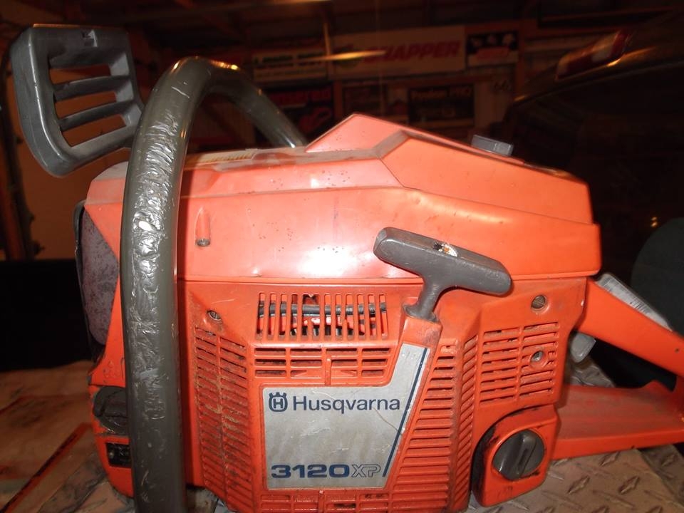

They quit making them in BLUE. I always tried to buy BLUE one.
I always bought blue and hard for next guy to scam someone years down the road that way.
The G3120 looks just like a husky. All orange. I would have liked a all blue. But I have no need for these anymore.
I bought one of my oem back and was like wth did I do that. Sold it 2 days later. :ROFLMAO:

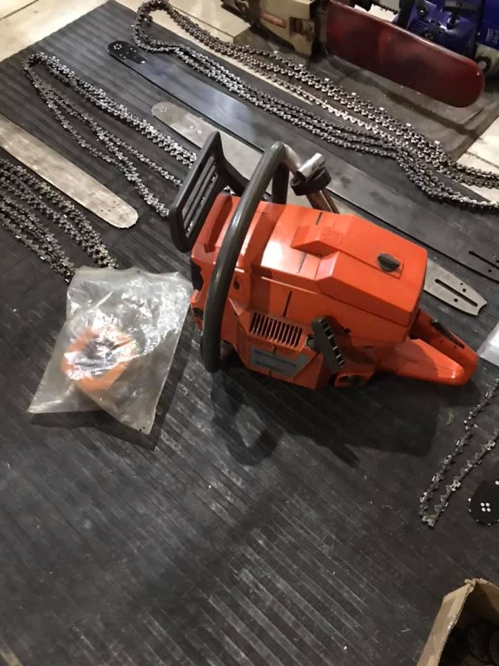

   / Just another junk chainsaw
#2,153
Also why as soon as I took this one in I listed it FS.

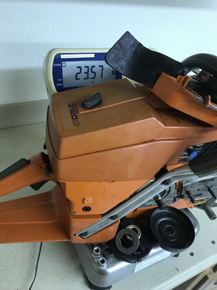

It was woods ported by friend out west Jason Egan and ran sweet. Unlimited coil with H side carb.
Reason shown in this other pic PHO weight even more then G888 MS880

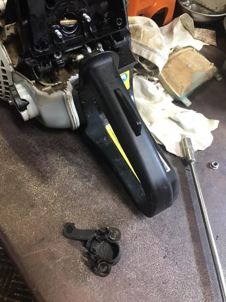

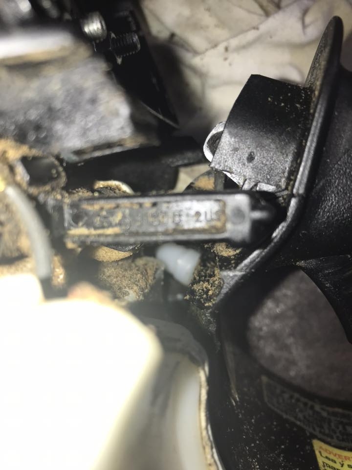

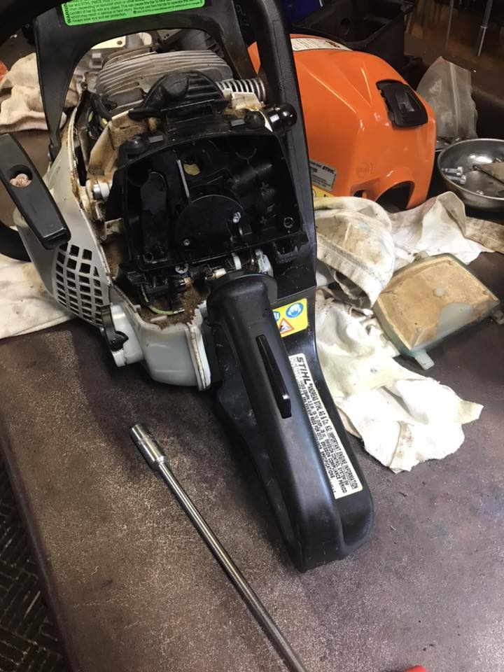

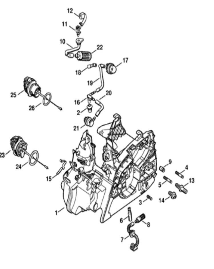

Stihl 211 complaint of gas leak. I can not find a gas leak at all.
Only typical oil line from oil tank leak. 🤷🏼‍♂️
IPL of area
#2,155
While checking things and cleaning tank vent etc.
They got very very lucky.
#2,157
Hello pita stihl location for a tank vent. :oops: 🤦‍♂️
Bye bye stihl tank vent and hello echo tank vents that I like better then stihls.

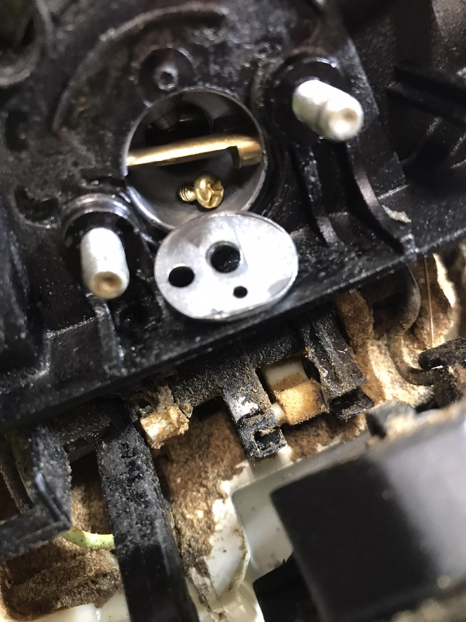

#2,158

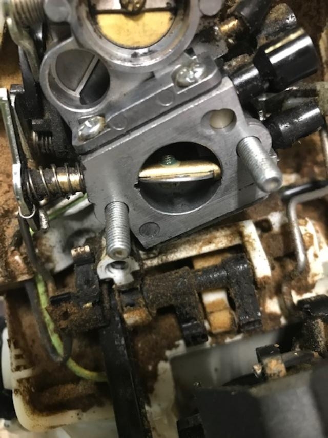

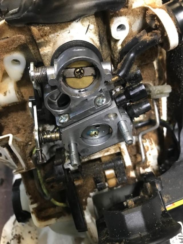

Ran by owner 3 options. Oem, afm carbs and redneck fix.
The redneck fix. Smooth the worn lips. Shape plate back to work. Take a longer screw from another carb. Loctite the heck out of it.
She lives. Choke fix worked.
