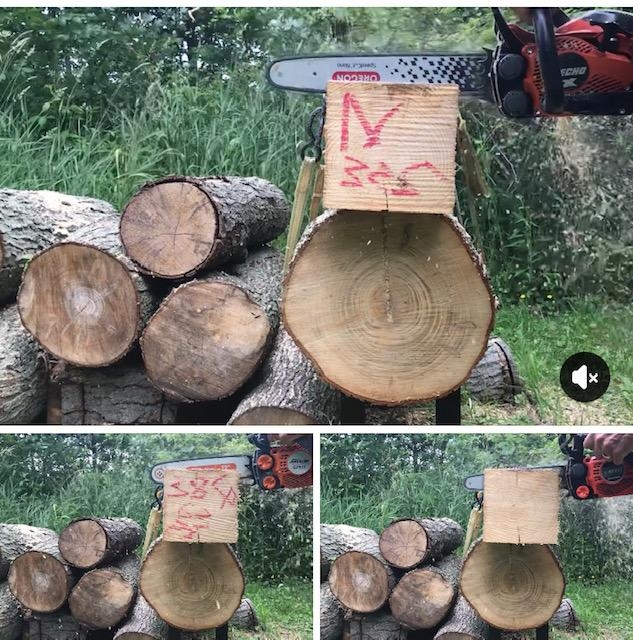

I cant find my times wrote down.
But the Egan pipe on oem was in the high 8's. So almost 2 seconds faster then Farmertec clone 2511 that isnt broken in yet.
   / Just another junk chainsaw
#2,573
OEM 2511 no doubt left there. Egan 1st and PSS V2 2nd.
#2,574
All 3
#2,575
@JeepHead was trying to wrap my ahead around why on clone PSS V2 was hair faster then Egan pipe. But not so close on OEM saw.
Thinking was closed port v/s open port and small air filter base and air filter v/s oem.
I totally forgot about smaller carb v/s larger oem carb. But Scotty reminded me of that.
So I check last 4 cuts. I found a little bit of the difference just now on last 4 cuts on clone. Egan pipe was 9" down and 8.25" wide at that point. The PSS V2 was 8.5" down and 8.25" on last 2 cuts.
This is why I always checked on cants back in race days. That was my last one used up.
#2,576
Guy in my group from Romania testing big cuts. 500 7901 385 651

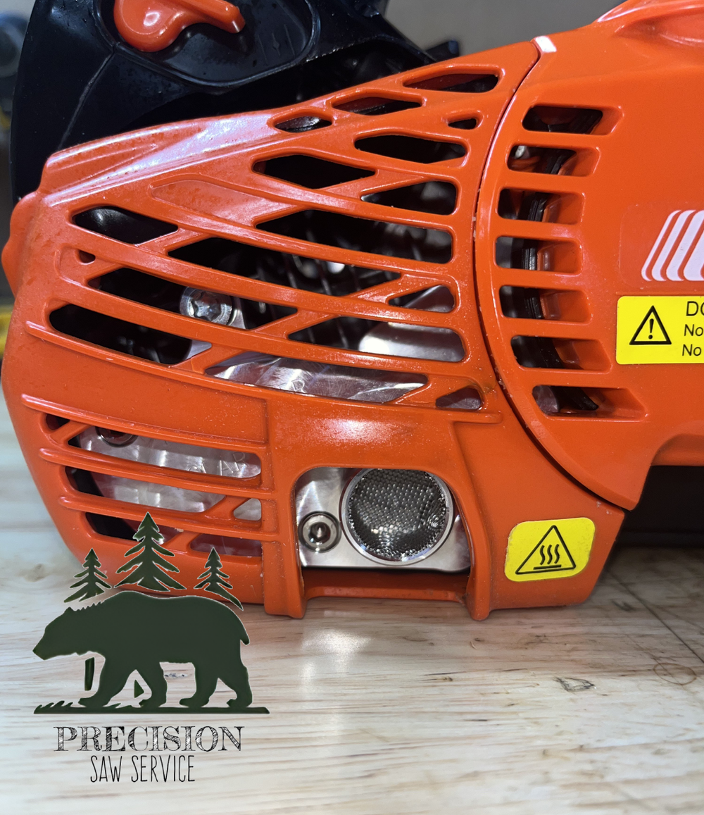

What's the sound different between the Egan and V2 and do you have to modify for the V2? I may pickup a rear handle 2511.
#2,578
IMHO the V2 deeper sounding. I didnt have to mod anything.

V2 on OEM 2511 shown here. No having to mod cover like clones.
Also comes with screen if needed.
