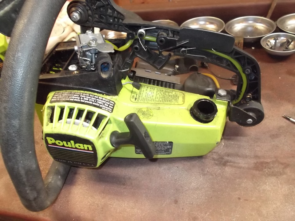

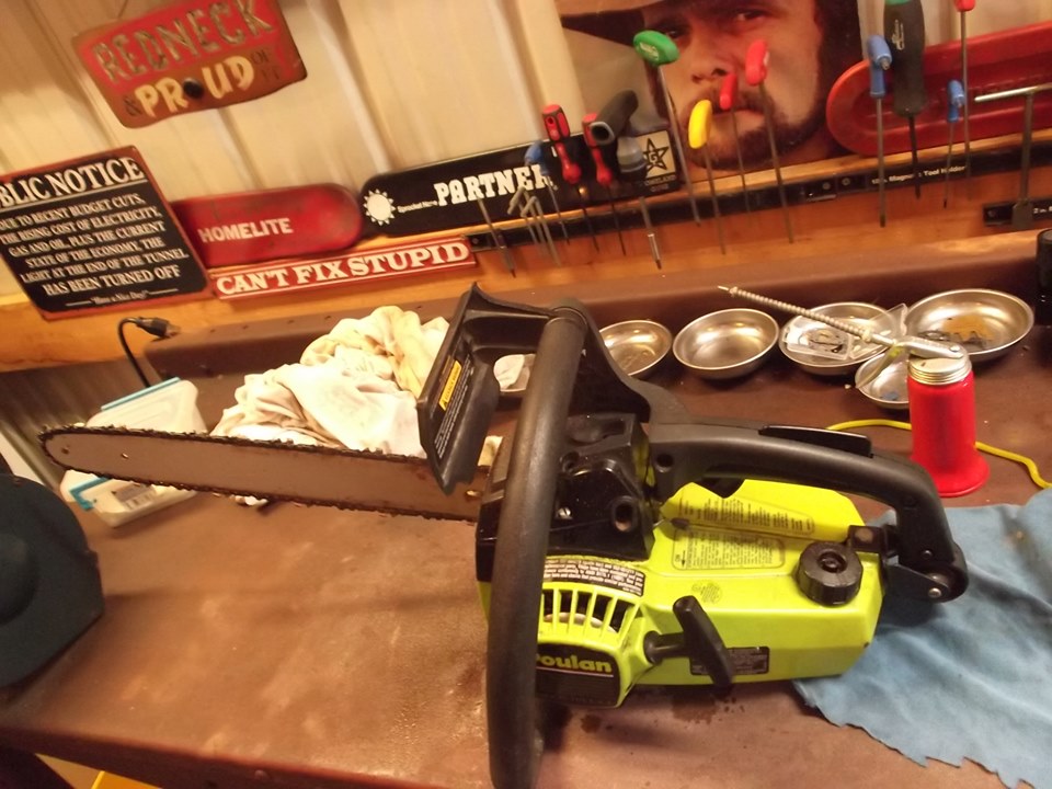

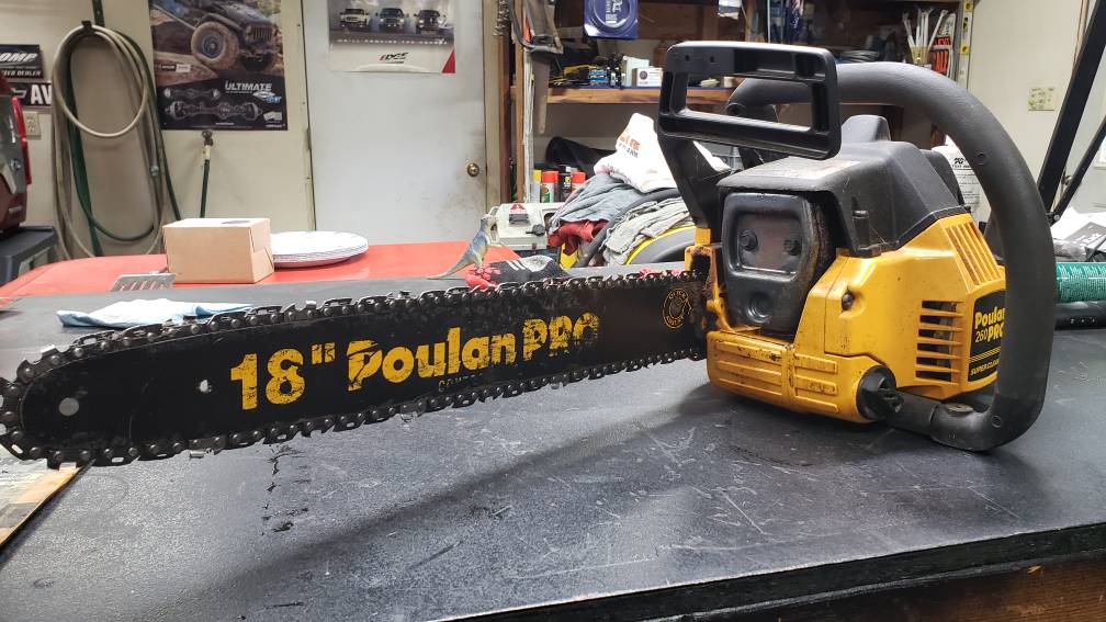

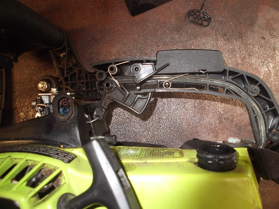

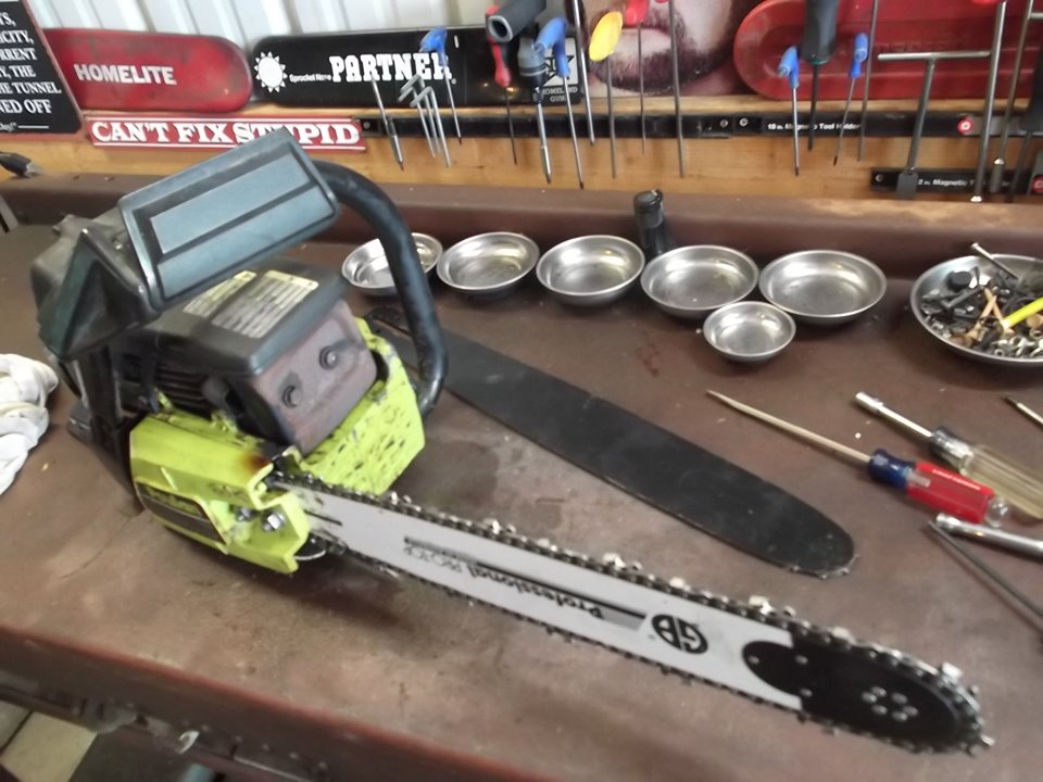

Poulan 4000 65cc with some of the grime off.
16” poulan Windsor bar. 3/8 60dl. New lines, new duckbill new ngk new carb kit installed.
Better suited with 20-24.

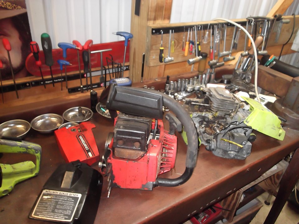

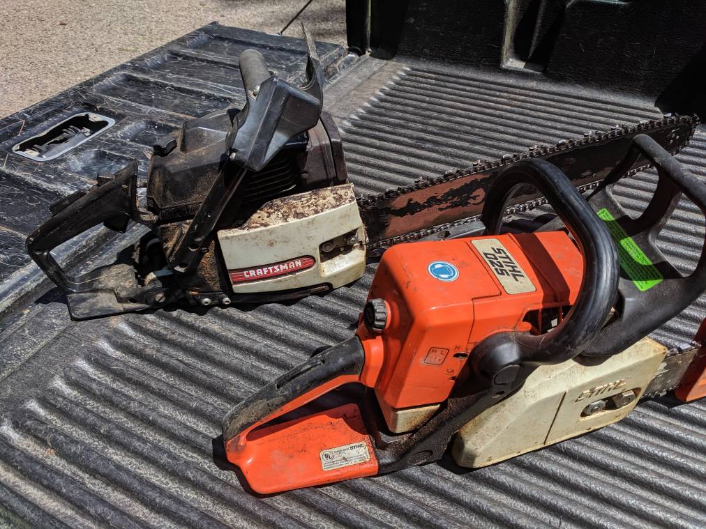

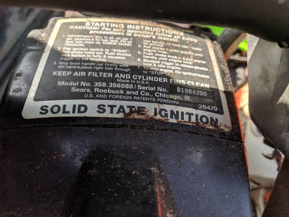

That looks a lot like an old craftsman i had. I scrapped mine instead of refurbishing it - no chain brake, heavy. But it did run and saw good most of the time.
Craftsman had them in grey and red. Some sold as 3.0 but really 3.4, then 3.4 and 3.7.
The best was the chrome bore 3700 and 4000.
Craftsman didnt have the high top 65cc one that I ever saw. Maybe I have forgotten if they did over the years but dont recall it now.
The red 3.7 came in both 3700 3800 saws.
/ Just another junk chainsaw #1,264
That gray one was the one i had!

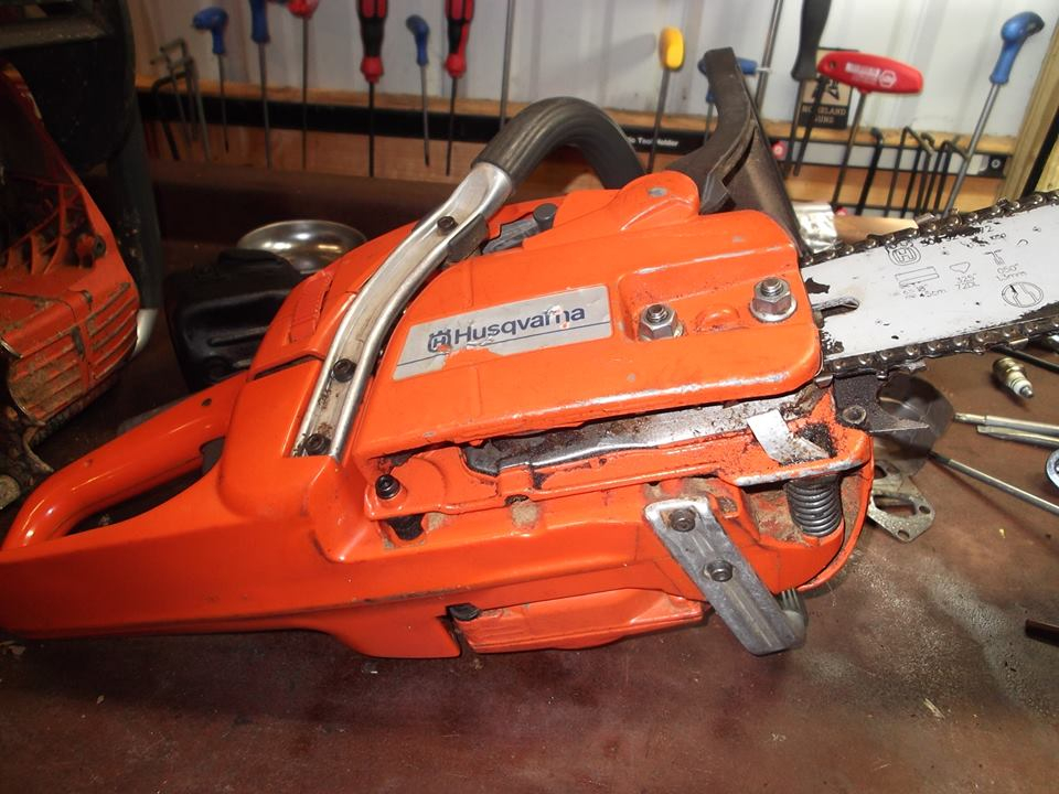

I didnt care for this style of full wrap compared to ones used on 372 385 etc. So took it back off of my jonsered 670.
Can be used on some 2 series huskys if you trim the side and drill a hole.
Also has my redneck made bracket and longer fasteners needed. Plus I used a spike to make a strong inner brace deal for both fasteners to go through first to strengthen. 2 of the longer fasteners are like $11 alone.
SOLD
If someone can put it to use just message me or on the shelf it goes.
#1,266
That full wrap sold right after I posted it in my FB group yesterday. 🍻
Cleaned up a painted the half wrap to put back on jonsered 670 champ. Just used a muffler paint I had on hand.
Just prefer this one in half wrap.

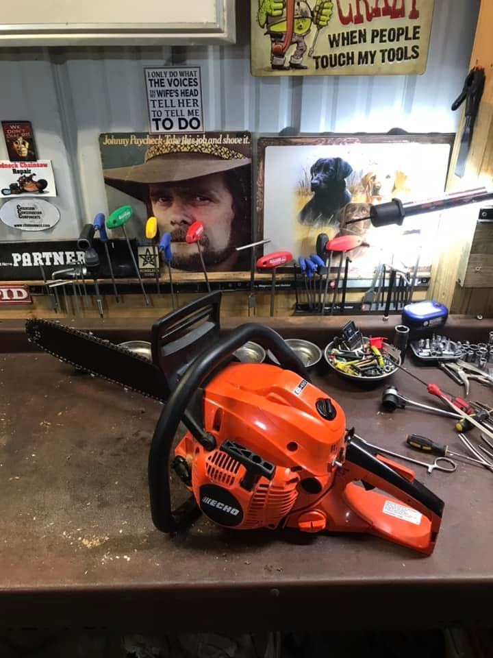

2016 OE 372xp mahle topend. 372 just getting ready to start 3rd tank.
2021 490 that been ported. Was told maybe 20 tanks so far.
Switched 372 back to how it was shipped. Pulled the high top stuff off. Took the big dawgs and full wrap off. Back to low top and small inner dawg with half wrap.
Put my afm muffler I did for other saw on it so he could have the big piped muffler he had on it back.
490 has spring assist start.
Ran a couple locals echo 4910 and sort of was wanting one to try out. Also was looking at echo 501.
Echo 490 has different piston and cylinder. P more like slab side 372. Quad port.
4910 501 p more like 440 piston style.
Reading 490 is a turd stock. But this one with just blind port work a local does seems to run pretty good.
But by Joe's dyno runs so does the 4910 501 stock leave lot on table to be fixed by porting.

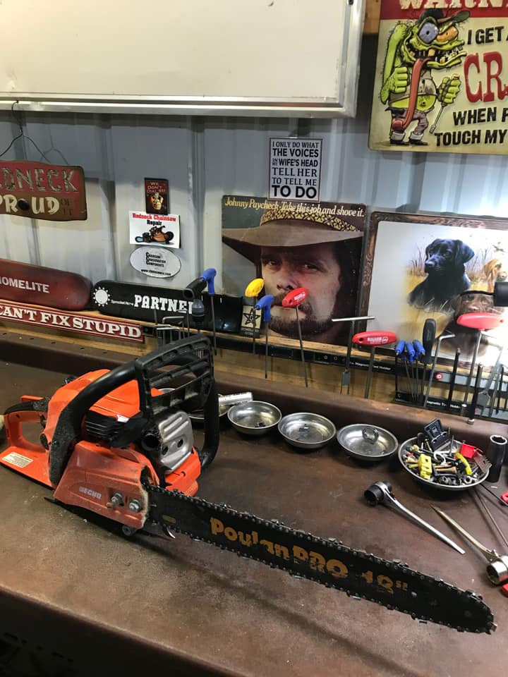

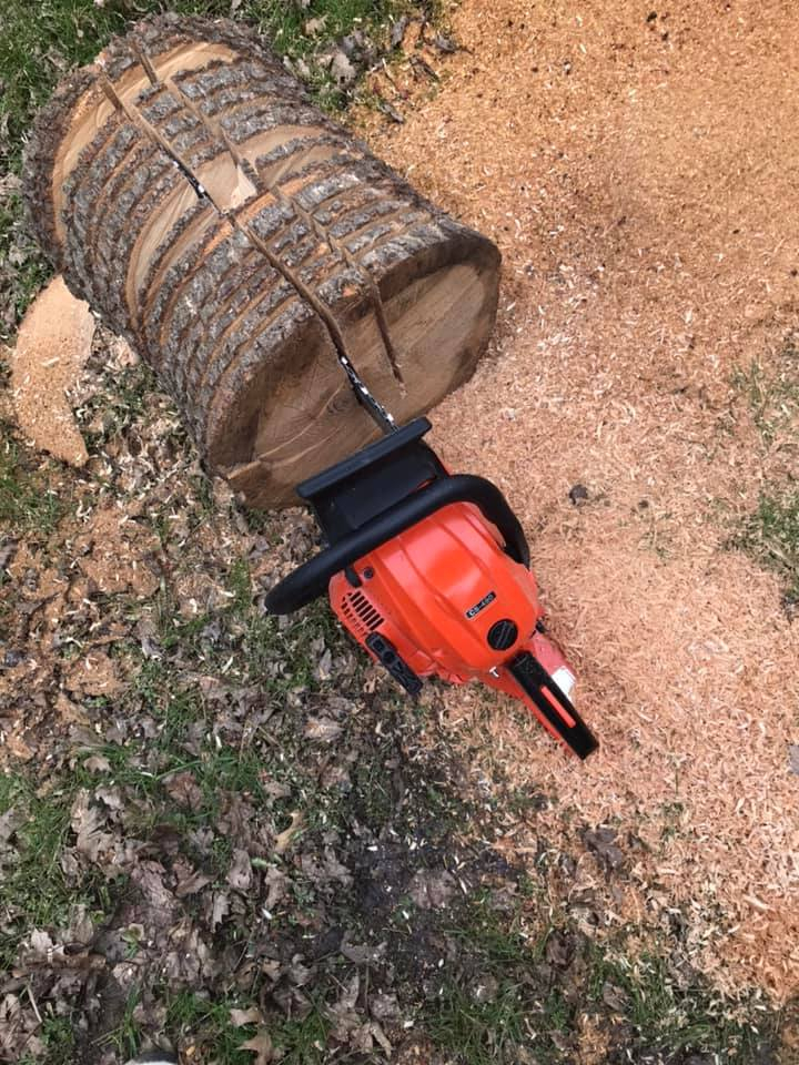

Been testing 3/8LP 325 and full 3/8 on that echo 490 that was blind ported by local. He got it little rough on the base on a corner area, but the dirko for base seal got her running good. Base needs about another .020 off it for tighter squish.

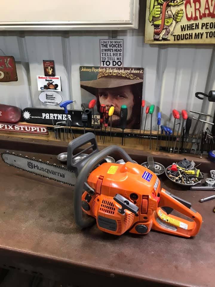

my husky has been leaking oil when stored. So far the only position it has not leaked, is on it’s side as if i were filling up the gas. Is this normal?
#1,273
Model? Some of them have updated oiler lines. I even tried dirko around some and it slowed them down.
#1,275

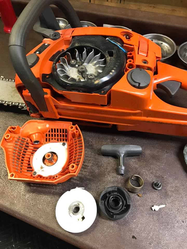

Newer 440
I take care of a couple 440 local. Never seen one just leak out. Just normal dripping from running and shut off.
Try cracking taking off your oil cap after running before putting up.
IPL shows a simple oiler with single line. If issues after trying above get in there for a look. Oil Hose [544084202] for Power Tools | eReplacement Parts
Not a saw I would recommended myself.
Pics of the 2 I repaired last go around.
/ Just another junk chainsaw #1,276
Thanks. I will try loosening the oil cap.
Those look abused. Mine is in good shape and works well.... just leaks when stored.
#1,277
Not abused the 2nd one above is like new with very light use. The spring assist recoil is a weak link and known by anyone that works on them.
1st one was a guy that placed saw on the ground and wife backed over it. 🤦‍♂️

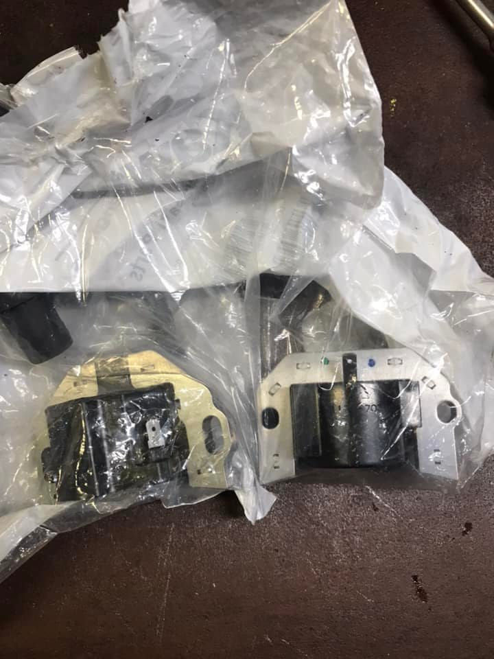

Order 2 OEM coils for a 22hp kaw twin that uses same coil on both cylinders. They cant even ship 2 of the same coil. 🤦
Least they got it half right I guess. :ROFLMAO:
Thank goodness most saws use 1 😇

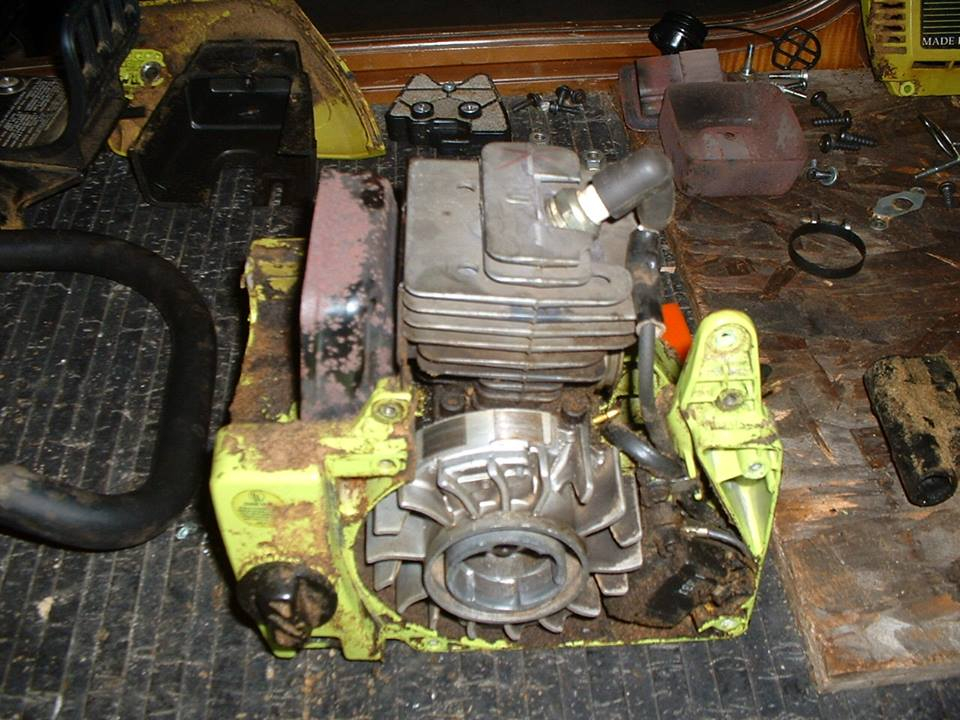

Dads bought new saw 1994 that had been road hard. Replaced AV's, intake boot and lines. Cleaned up a bit years back.
