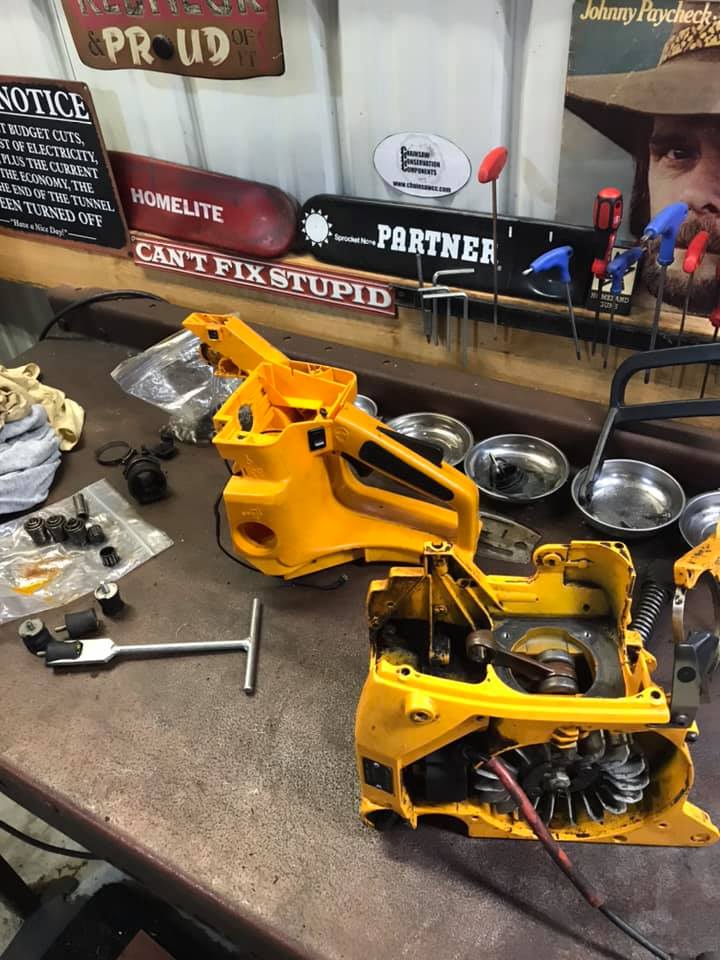

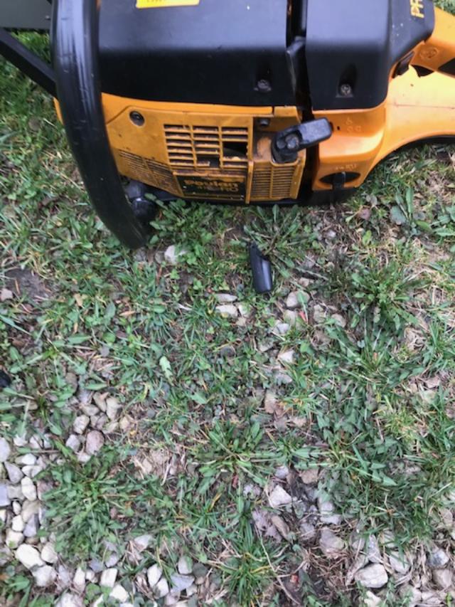

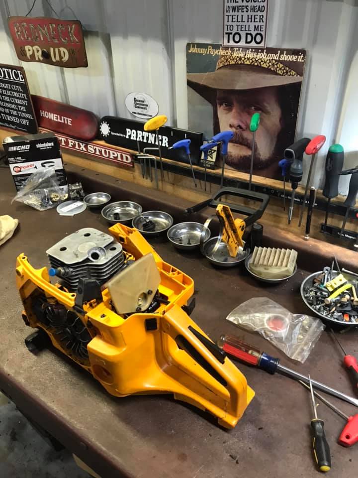

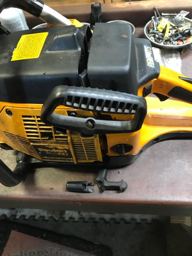

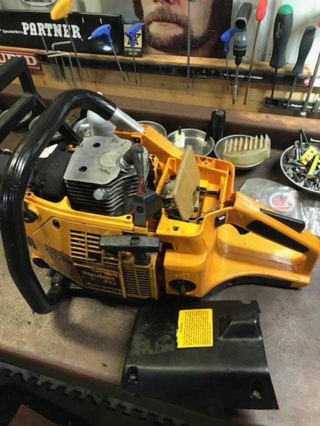

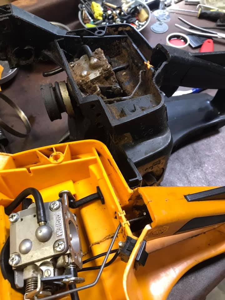

NLA new and hard to find use rubber av's for the poulans like ones fixed shown in thread. I still have plenty of used and some NOS still. But other folks dont. Soooooooo =
Had a idea for years now that different makers may work. Think I found a winner. The bigger ones didnt work but the smaller were close to same size.
