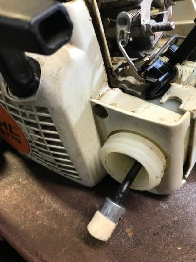

I've done the redneck echo fuel line trick in alot of different saws. Stihls mainly the 025 290-390. But this is first 170 I tried it in. Perfect. No more oem lines that just give up ghost. Never cared for the molded lines in their whole older plastic series myself.
Stihl 170. Guy never ran ethonal fuels. He always efree and also can fuels too. Stihl 390 025 170 and now 261 replaced 025. The 390 025 has been redone over the years too. Till 025 last fix was more then saws worth.
Never had one come back needing fuel lines after doing them with echo line to date.
Cool thing about this guy. He cleans his saws up before dropping off. All his saws always look like new. Just firewood cutter in late 70's.

Tygon maybe?
/ Just another junk chainsaw
#1,649
Tygon maybe?
It was stihl oem line. Tygon is crap line too for lasting. I use it only in certain trimmers since no other choice. Then also make sure it is real tygon with 4040 all on it. Not some aftermarket crap. It is even worse.
Ive done all 3 of his plastic stihls with echo line fixes over the years. 025 one the case wore out where cylinder sets so it didnt get rebuilt by me due to cost compared to getting a better saw = 261.

Done the owners MS390 many years ago same way.
Stihl black line is crap. If the green suppose to be better and resistant to ethanol.
But remember this guy dont use that crap and lines still rotted over time.
