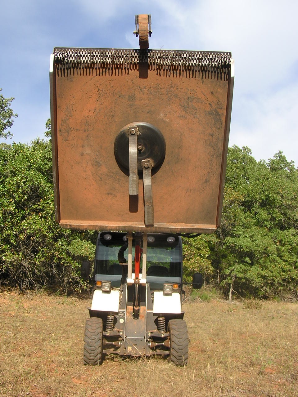

Can blades rotate/fold back freely at their connection on the stump jumper?
:confused2:
must google....
What he was referring to is the blades are typically mounted onto a "stump jumper" pan with shoulder bolts that allow the blades to pivot some. This is so when a blade hits a solid object, the blade will swing back some and lessen the impact to the gearbox.
A picture of a stump jumper with one blade folded back:

   / Just bought a bush hog, what to look for?? #20
Folding blades are also available on cutters without a stump jumper pan. There is simply a flat bar with a splined center hole to fasten to the gearbox shaft. The blades then fasten to that flatbar with bushings that allow swing.
The purpose of a stump jumper is not to allow the blades to swing freely. It's purpose is to "ride up" over a hidden stump or rock or any other obstacle. Without it the flatbar and gearbox shaft are vulnerable to severe shock from banging against said obstacle. :(
If you have a choice, always choose stump jumper.
