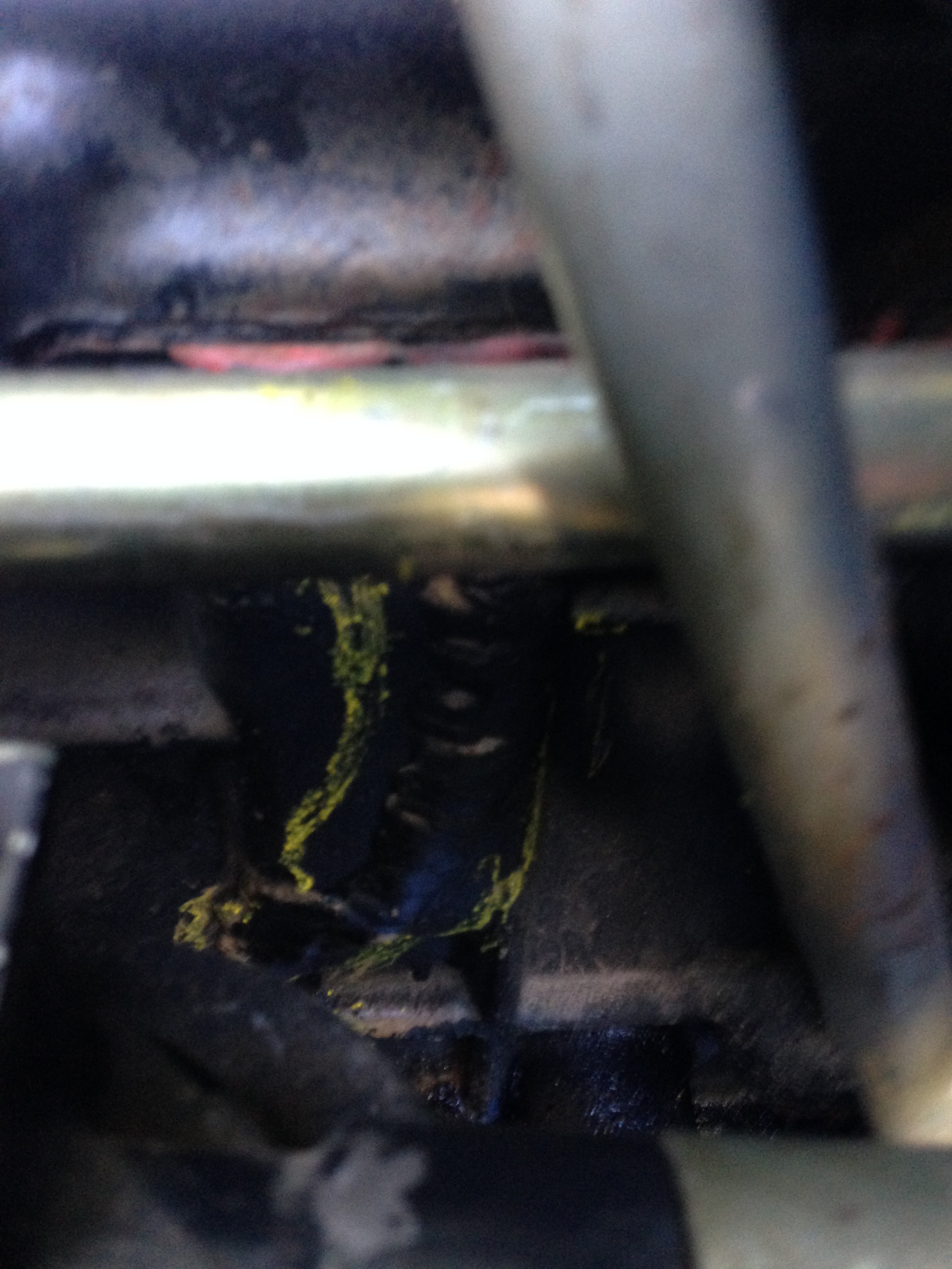

phillips iphone 138.JPG this is the bottom part of the weld it is leaking pretty much right at the end of the weld itself where i scraped the paint off

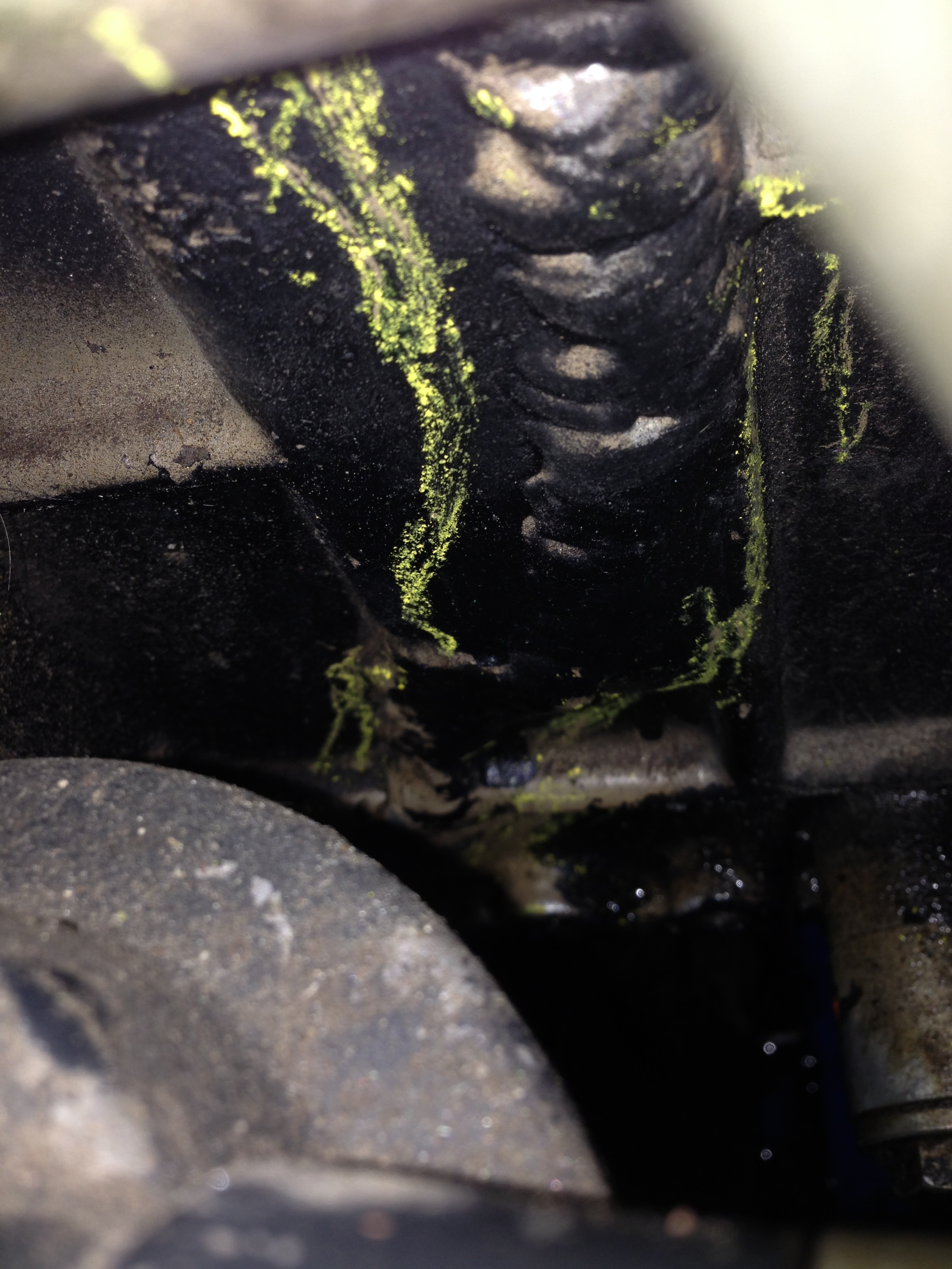

phillips iphone 135.JPG this is at the top of the transssion

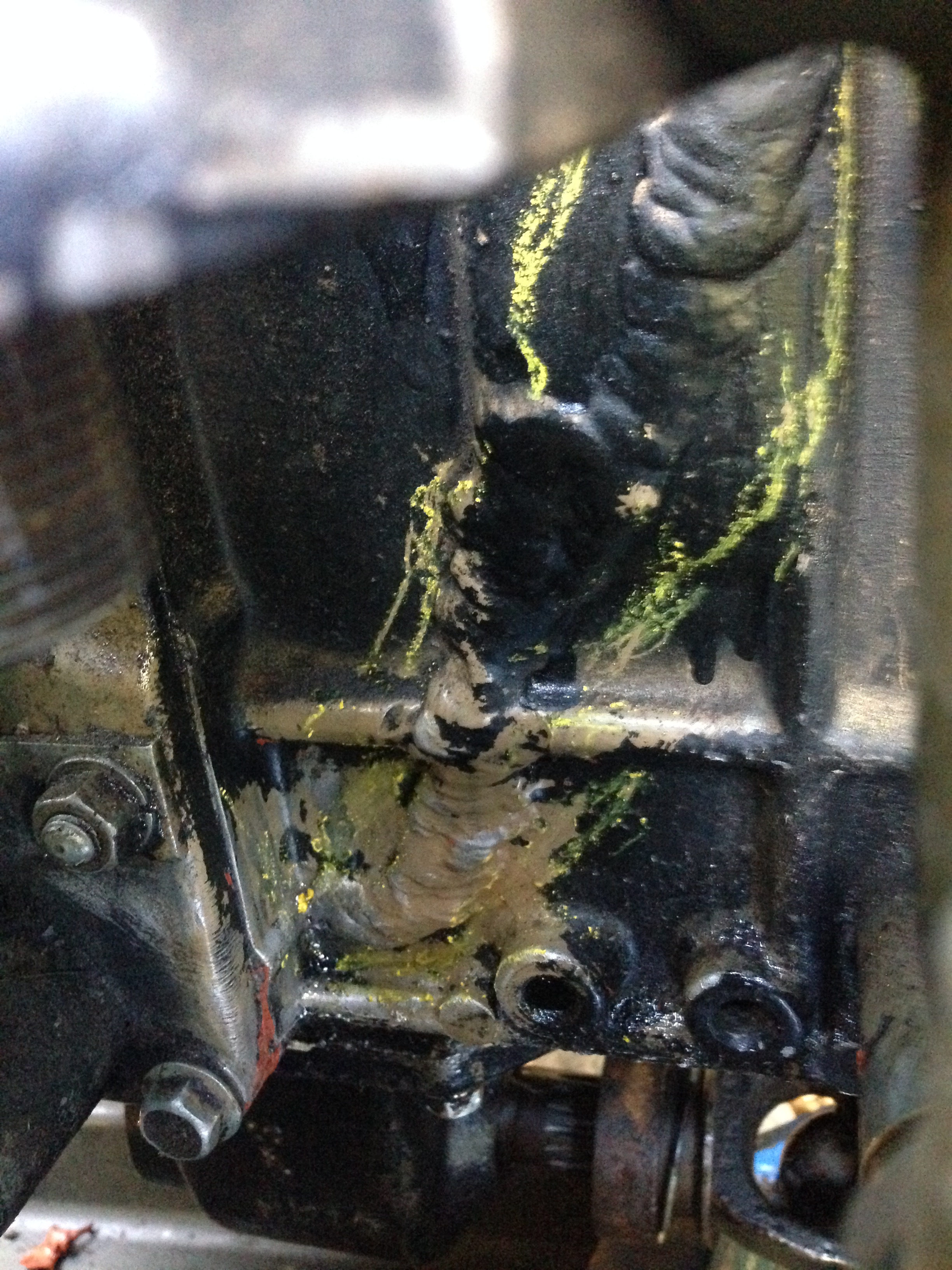

phillips iphone 139.JPG this is the middle part of the weld

View attachment 480749 this is the middle part of the weld
Since it was welded before there is a good chance that it can be ground back and rewelded. It takes a good welder to weld cast so find one and get it fixed. Shouldn't be all that bad. If push comes to shove, like others have said give JB Weld a try but be very meticulous about it, especially the cleaning part. You'd be surprised at what you can do with that stuff especially if there is no real pressure and it's just holding fluid.

I'm just worried about the stress that area takes since the tractor has a front loader. The crack is about 4" behind the bell housing.
