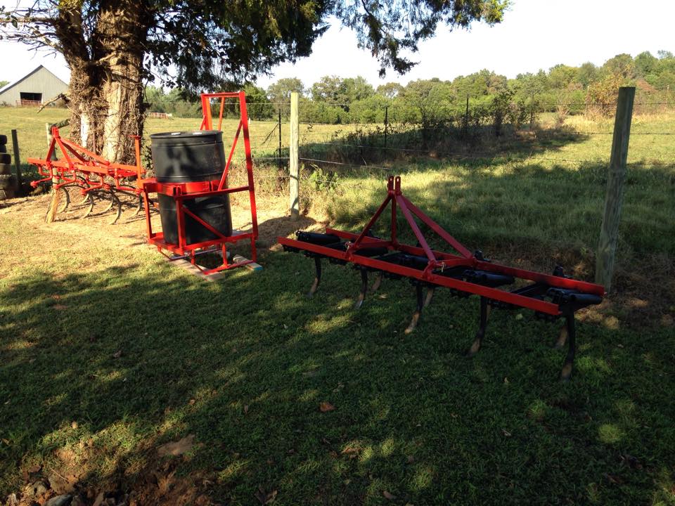

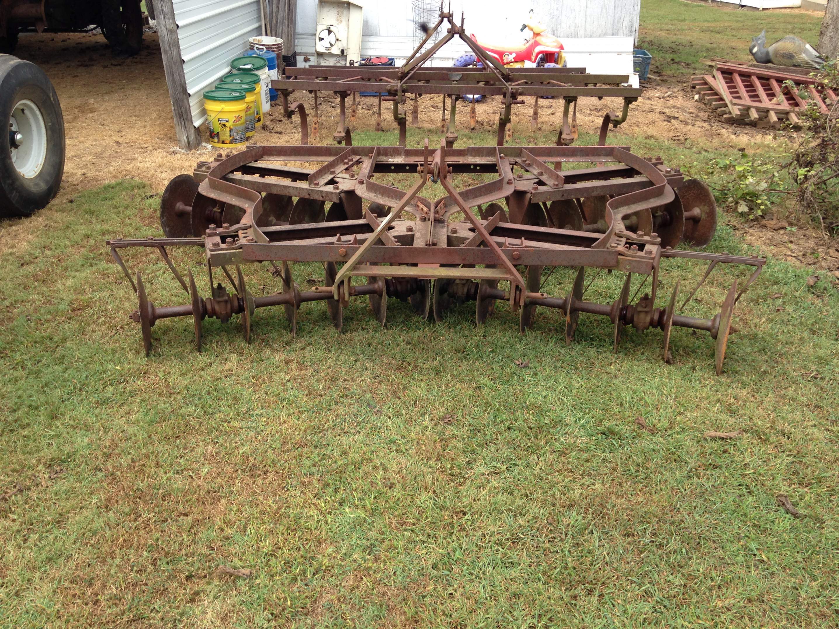

Also yesterday we made a trip to look at some equipment and brought home a Dearborn 13-2 Cultivator points just flipped. This winter when i paint it i will buy all new point's. Also picked up a Dearborn Re-breaker/Tiller gonna do the same paint/points. A Heavy Duty 4 inch boom pole and a Ford Series J 8ft 3pt Disc need's new front disc gonna switch to cut one's instead of round and the back ones are like new when i paint it as well.
Thanks for reading heres some pics of the equipment hope to add some pics as i get stuff done.

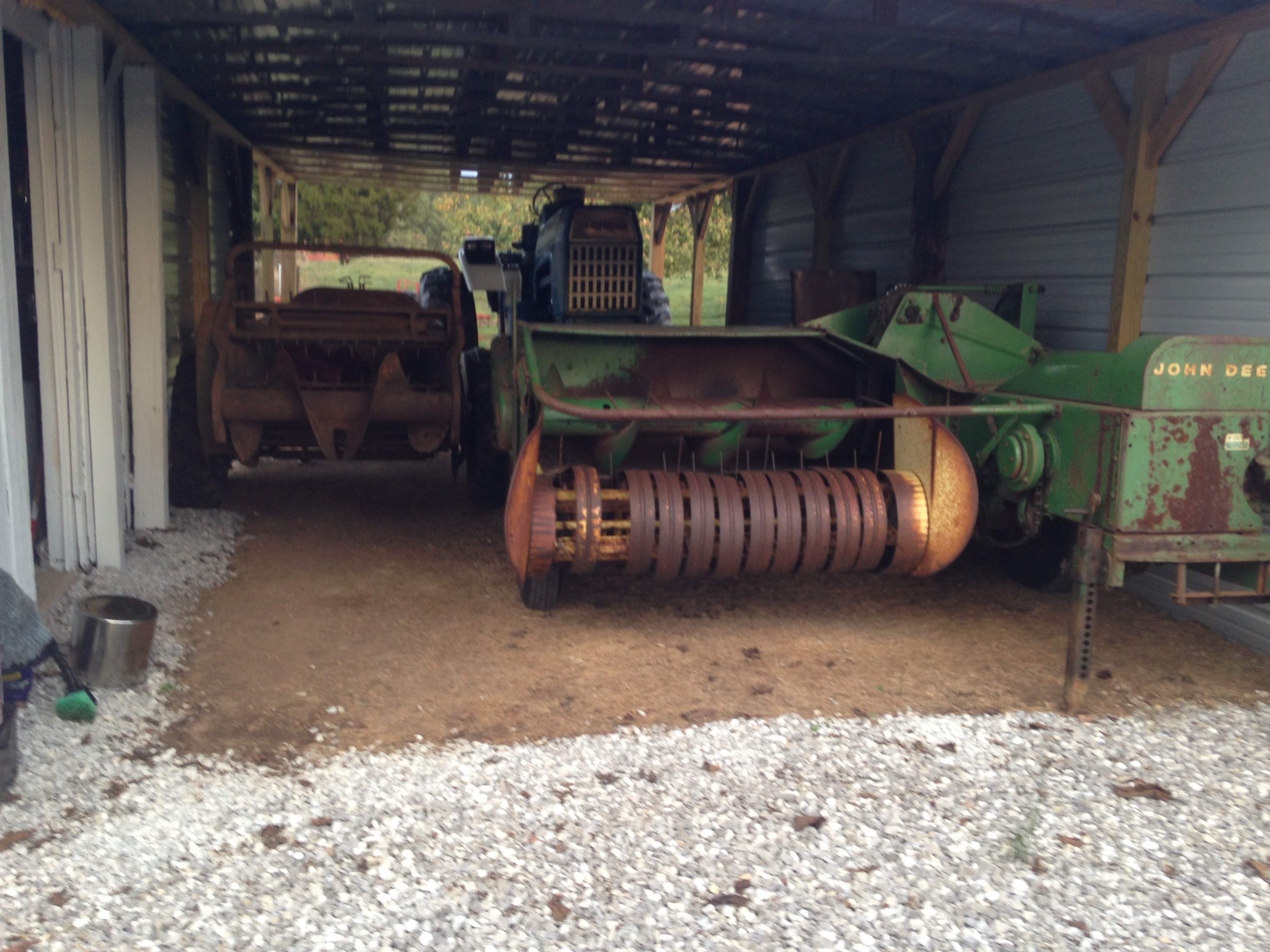

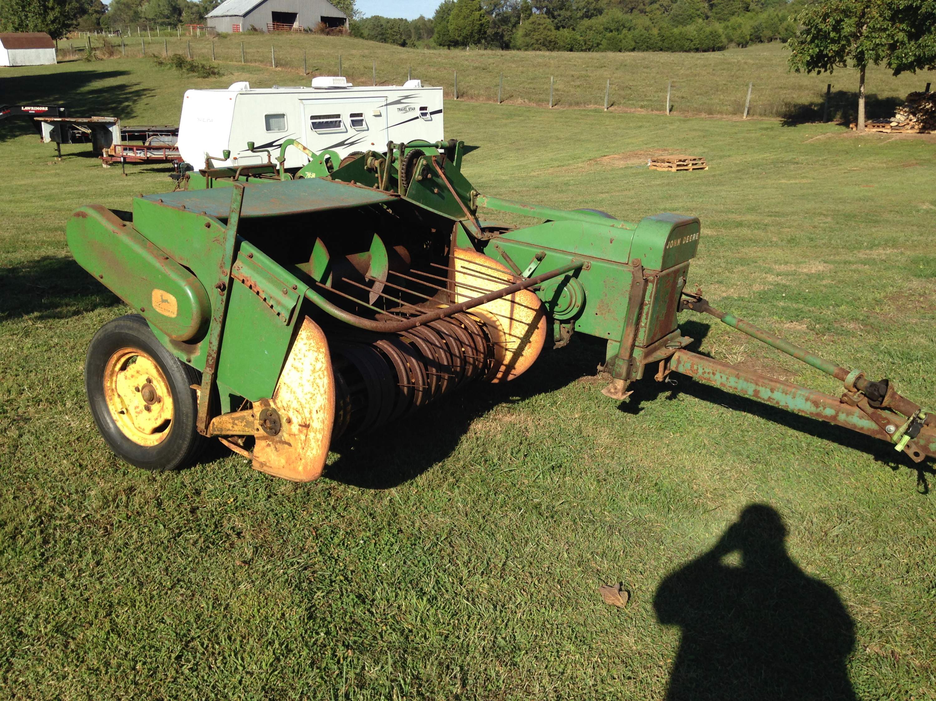

Update: 9/21/2015

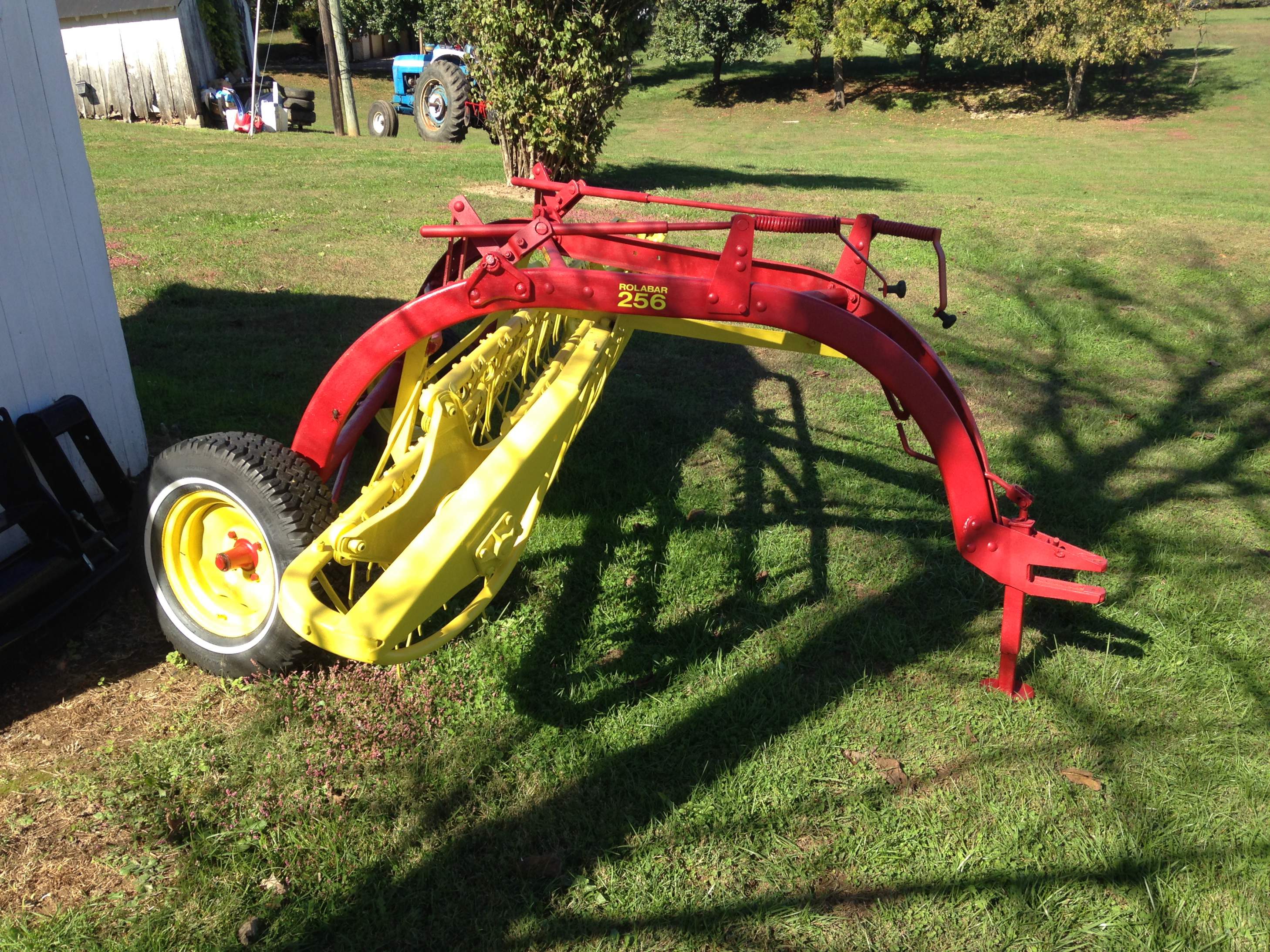

Hello again all I picked up a few more item's the other day a John Deere 24T baler and a 256 New Holland Rake both in great shape for $900 total got offered $2900 when i got home...and a few more offers since from others just can't let em go just yet haha crazy i guess and got a few painted aswell..

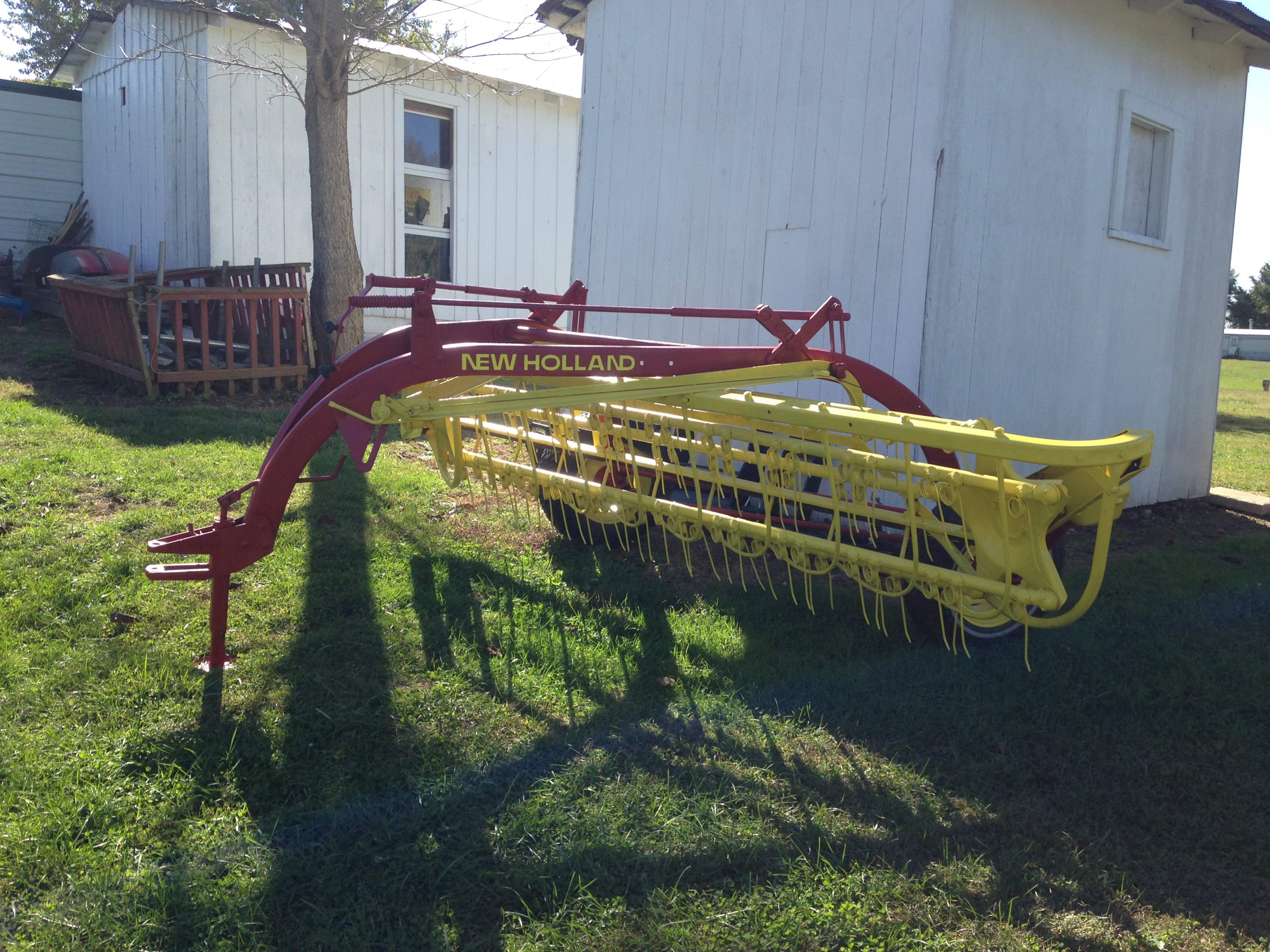

Howdy all so it's been a month figured i'd post a post some pic's of my progress so far
We had to extend the garage to fit in the new piece's and the tractor plan on another 20ft addition to the side and a 28x28 garage aswell but, money is short with the holiday's on the way. lol

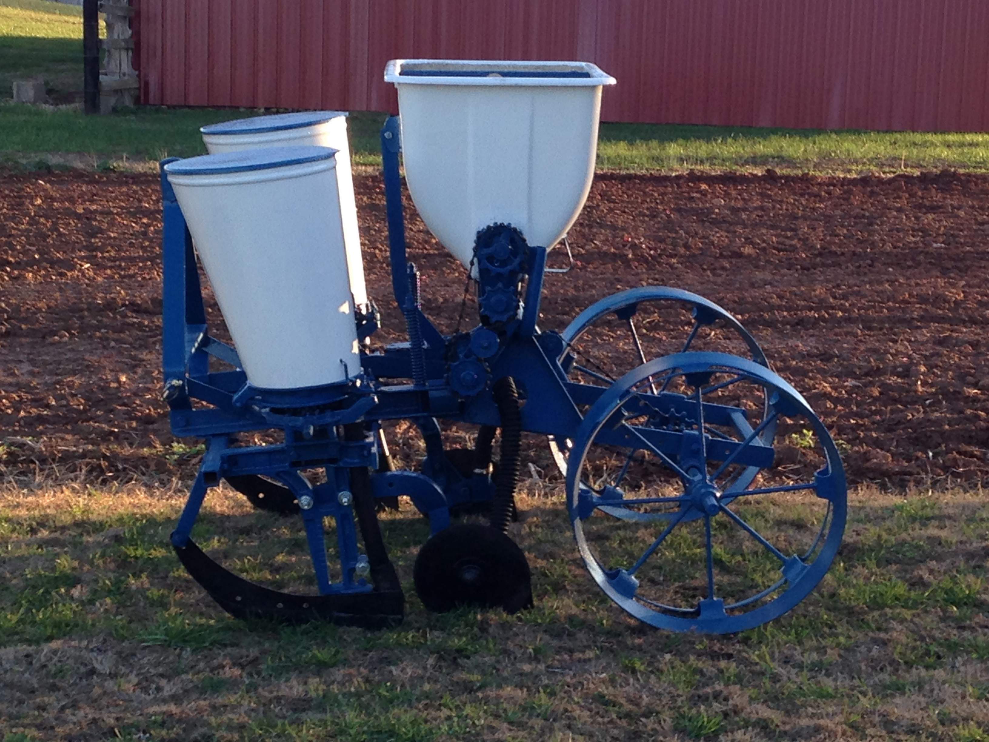

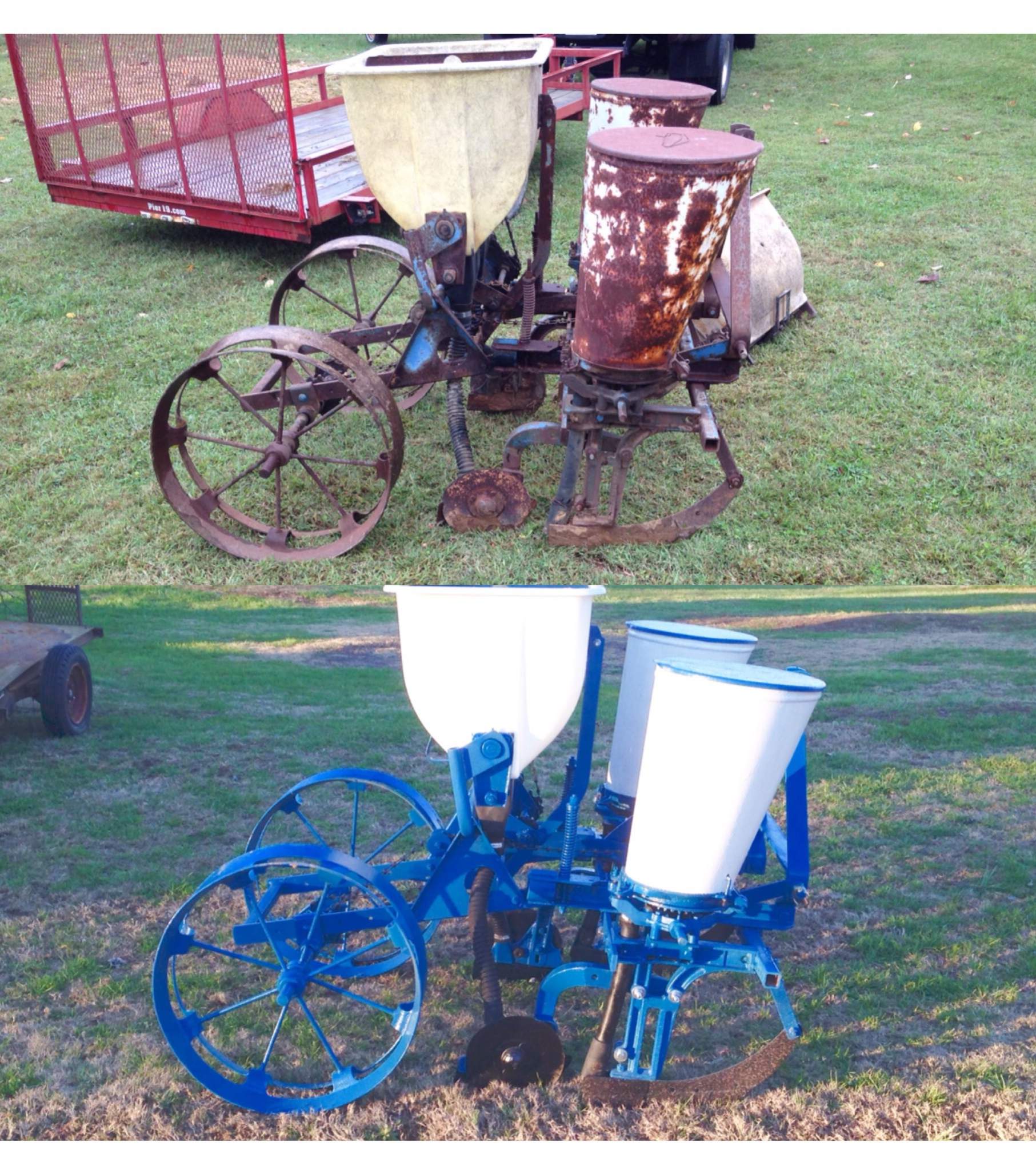

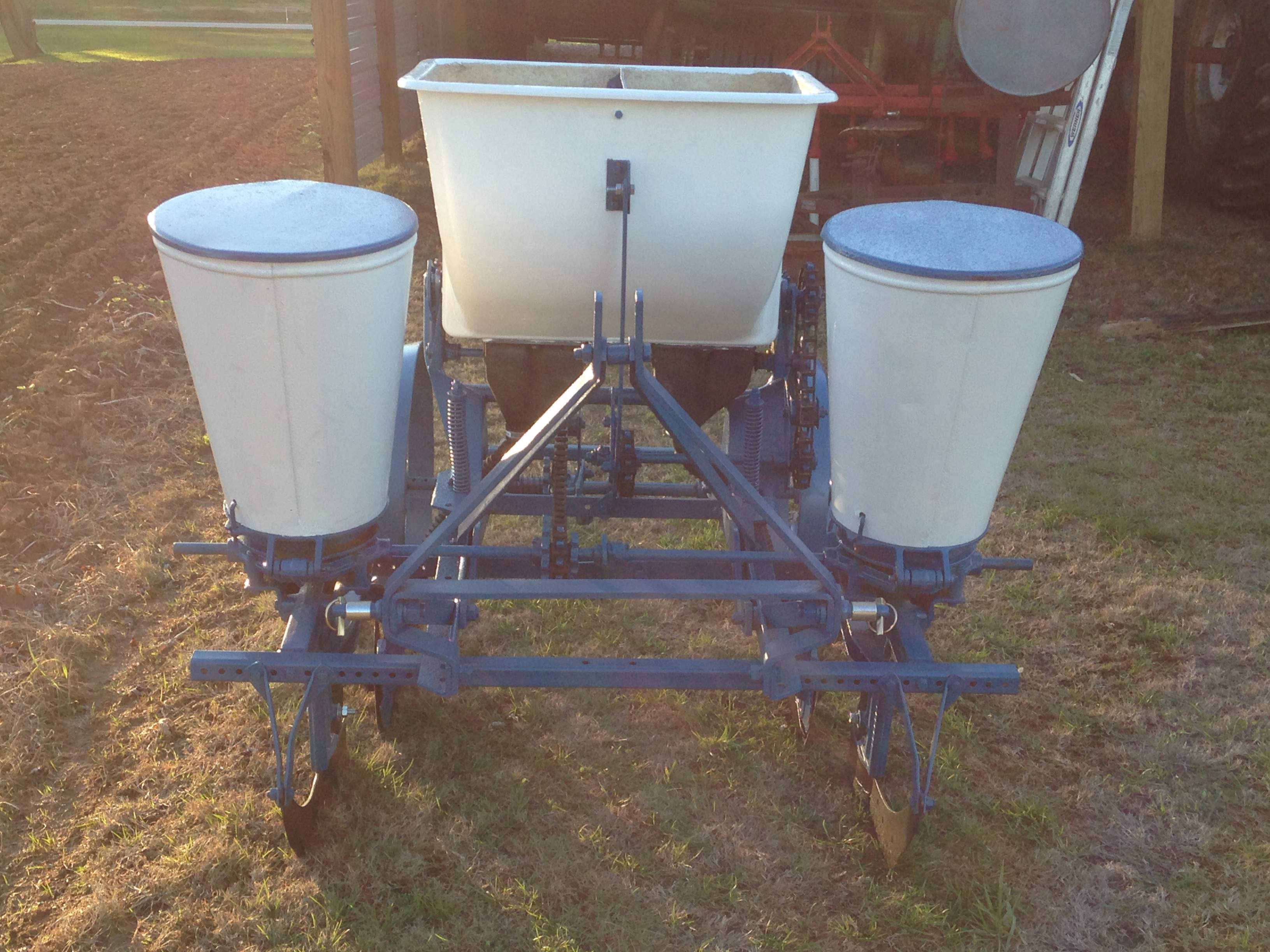

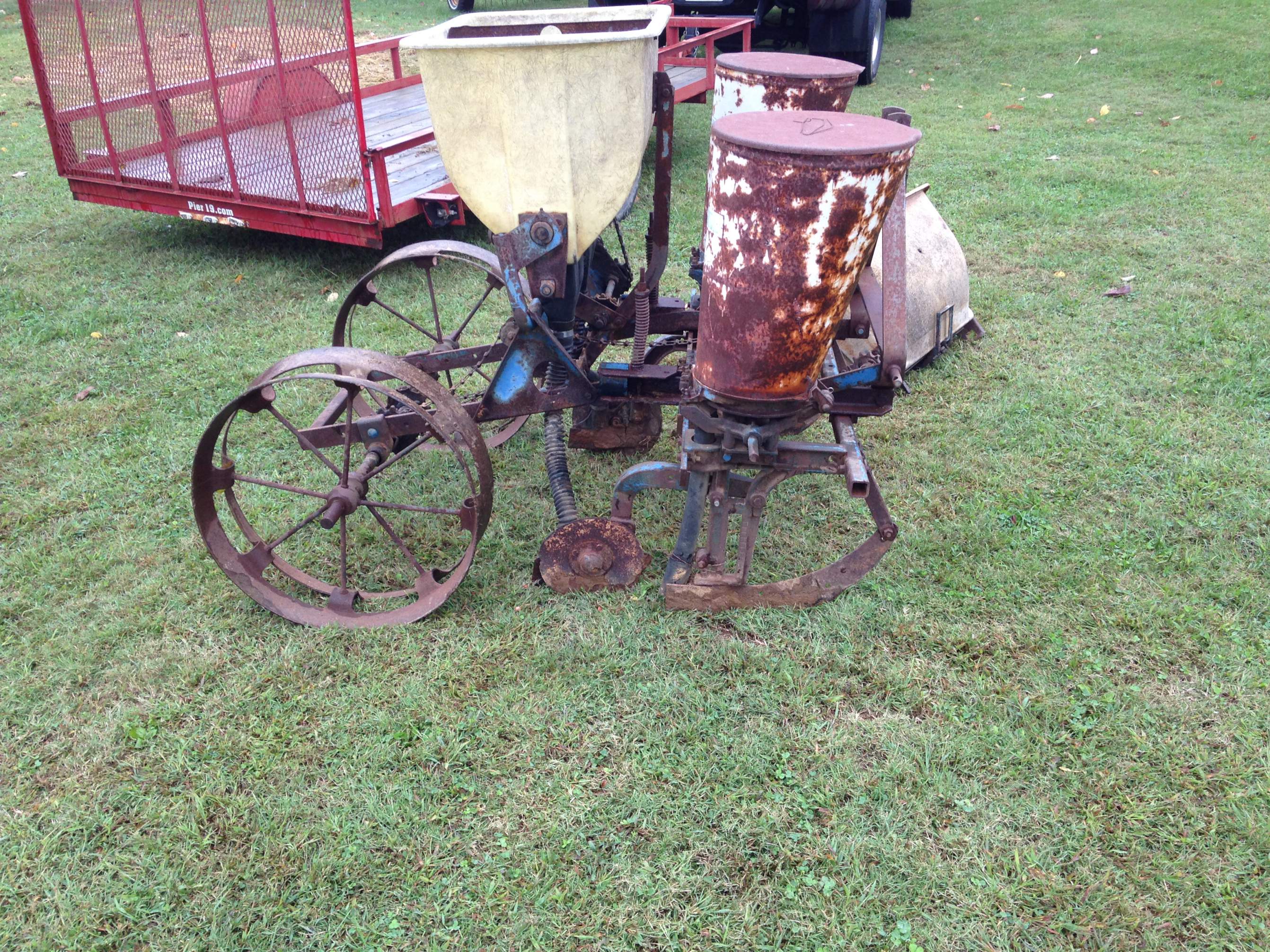

I picked up a Ford 309 2 row corn planter in great shape(came with a part's fert. hopper aswell) For $200 and a Holland Transplanter for $30 at a local auction. I was able to get the Rake painted and new decal's put on and got the corn planter one coat of paint on no pic's yet of it... But i will get some when done thanks for reading
   / Just bought my first Tractor #18
The rake looks awesome man! Great work. You are either really good at negotiating, or just always happen to find amazing deals. Ha ha
#19
Thanks i really enjoy restoring these old equipment back to close to new but still don't care to get'em dirty. Yeah i seem to stumble upon good deal's at time's lol I learned a lot from working at a local Farm Equipment Business so i know what to look for and the repair cost to help talk people down to a reasonable price. Still on the prowl for a 16ft wagon, 6-10ft Bush hog, 7-8ft Grader box, Finish mower and a 2 Row Corn Picker.

Finally got my Ford 309 Corn planter disassembled, fixed, reassembled, sanded, and painted today just gotta wait till its above freezing to put the new Decals on haha lol !!
