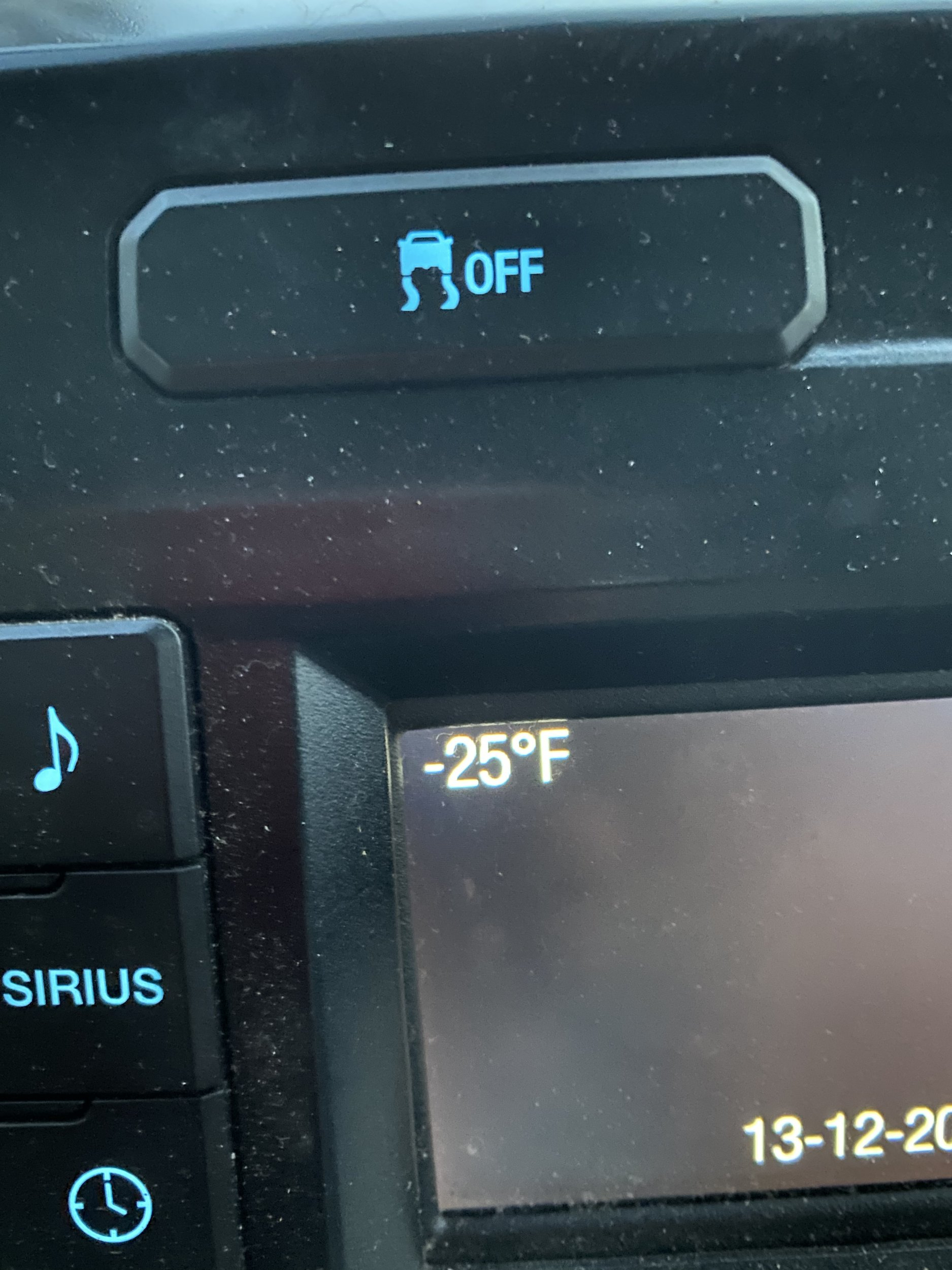

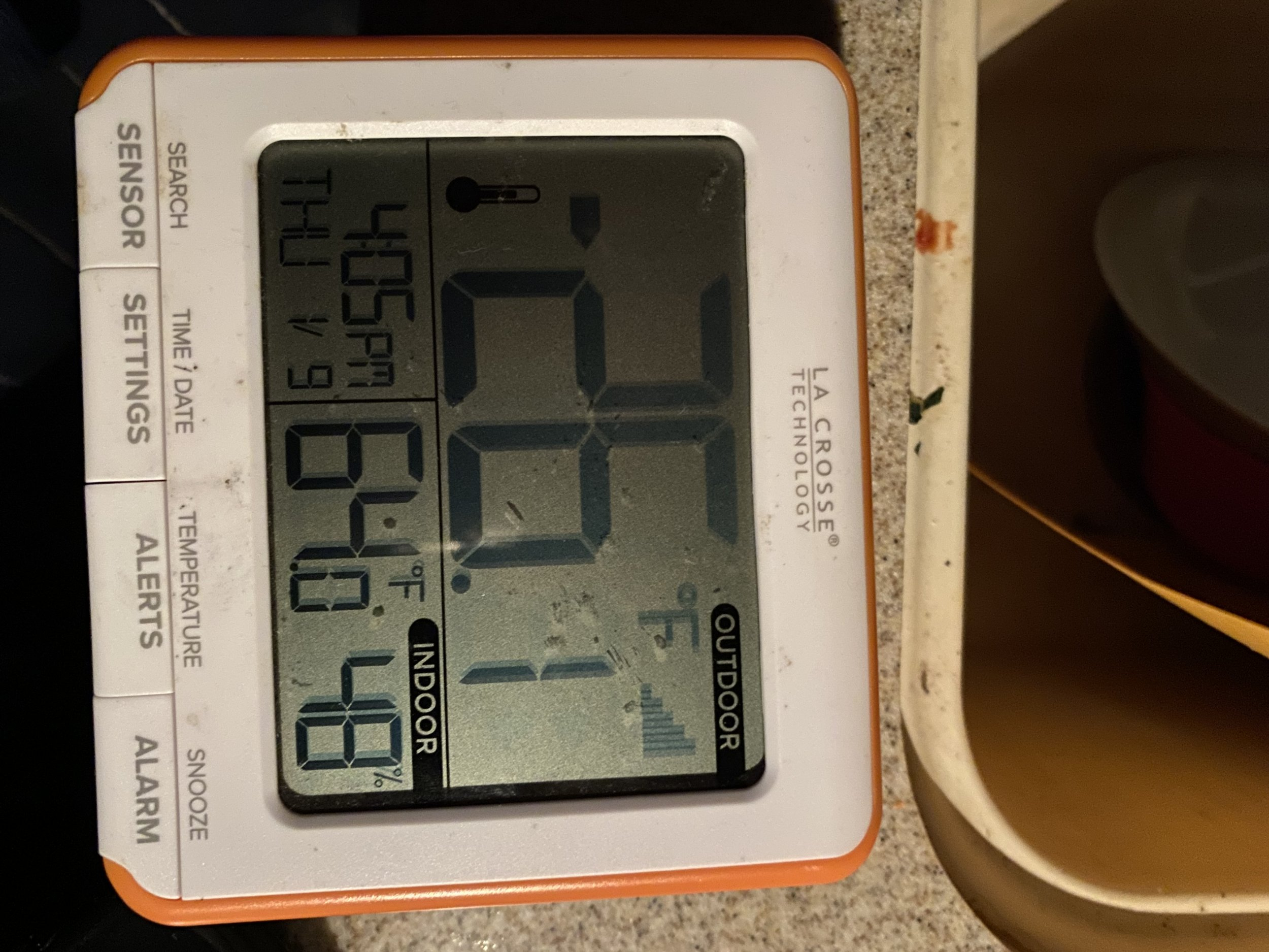

Glad I did it yesterday
This mornings temp
Truck started right up (had to help neighbor out who was stuck). Glad I have a good 0w oil in. Didn’t have time to plug it in.
