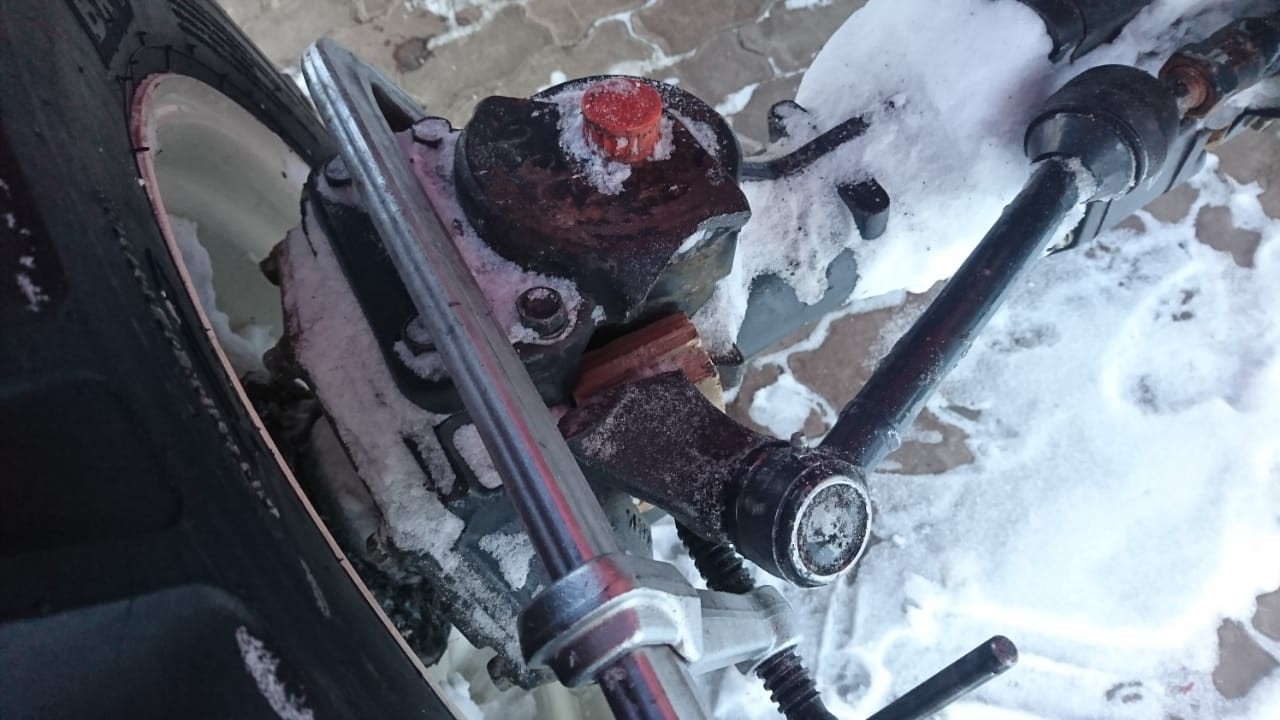

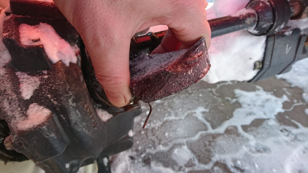

The same breakdown of my 2013 branson 5820R tractor, right side, the steering knuckle is broken. The tractor got stuck, got a stump between the rear wheel and the wing, when they tried to get another one, they broke it.
I attach a photo of the broken part, it is clear that the part was already cracked, probably from the previous collision of the front snow blade on the obstacle

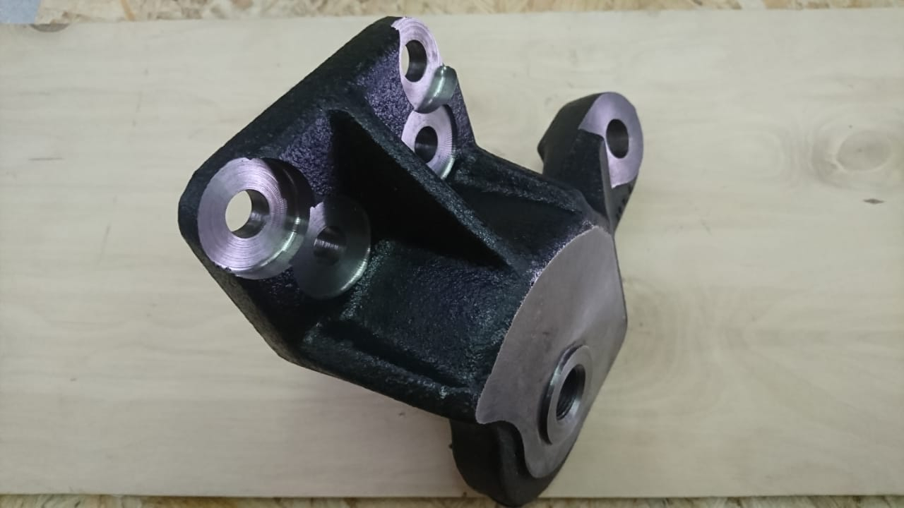

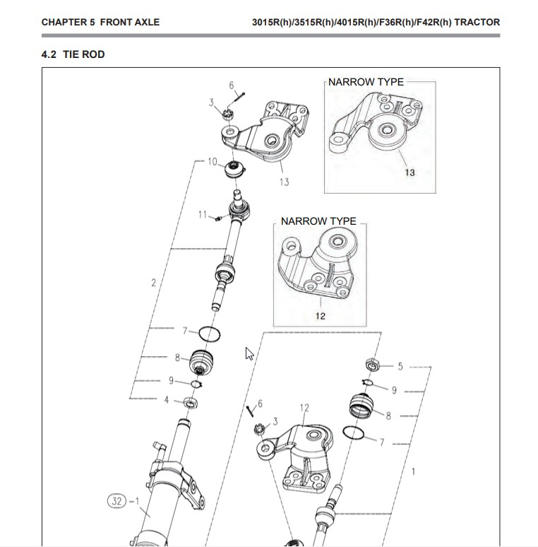

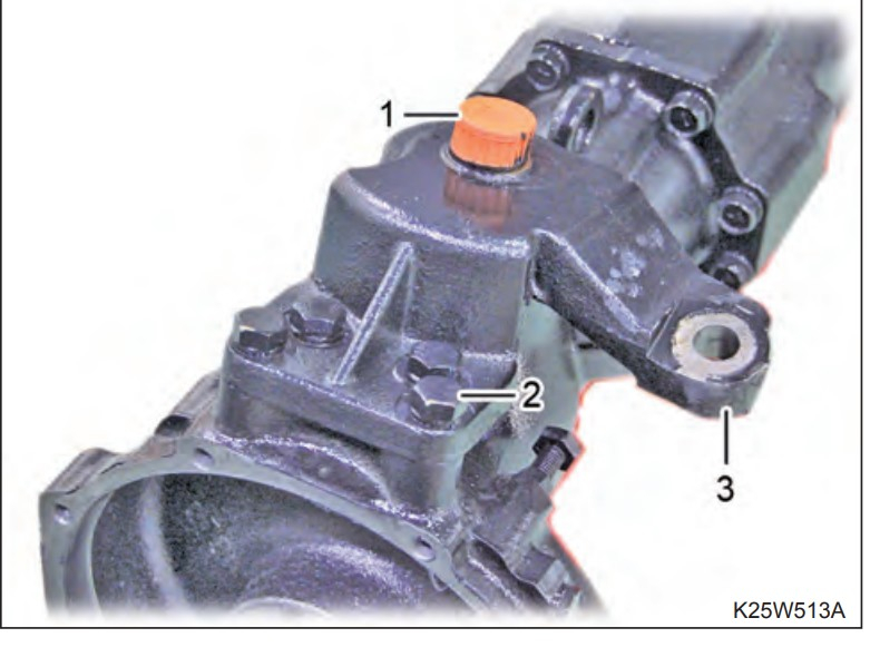

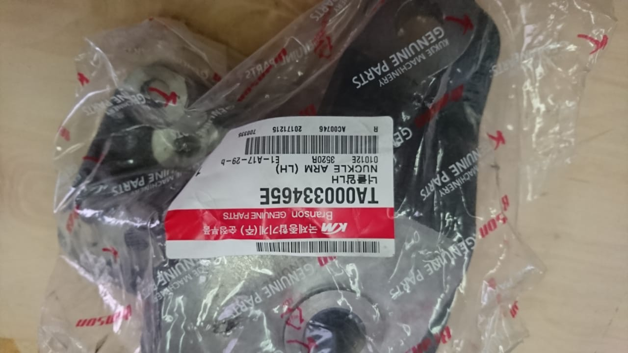

The manufacturer has changed this part, the old part number TC60020000B2 KNUCKLE ARM (RH) -> TA00021466A, the new TA00033467E (RH). The details are different. I ordered a part in Korea, an updated one came (I can't send it back, I ordered it through an intermediary.
Now I sell this part TA00033465E (LH) - $ 250 + delivery from Russia (5-7 days)
