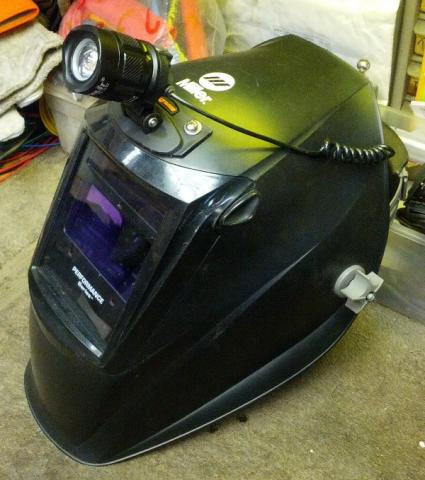

My solution was to add cheater lenses to hood and skip the glasses..... Added head lamp to helmet to spotlight area where arc is taking place, Yes it seems odd to add light when using a darkening lens to dim the arc... But the bright/more ambient light, the easier it is to see weld path.... And keep lenses scrupulously clean...
Another thing you can do is highlight weld path with colored paint stick/marker...
(not mine, image stolen off I-net)
Dale

At 76 and cataract surgery too...... Same issues.... See a previous post by me for possible solutions...
Dale

As other have said, additional ambient lighting will help a ton. A halogen work light is perfect.. or one of the newer LED ones should do the trick
   / Just can't see where I'm going #15
I'll jump on the added lighting bandwagon, I've tried it, it works... being into vehicles I end up welding in stupid situations that are hard to get your head near let alone anything else, so I started adding just an LED flashlight near where I'm welding and it's a big difference... With that said, I'm still young with good vision!
