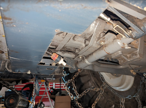

Where under the tractor is the little filter I should change? I already picked up a carquest 86006 to replace it with.
Under the seat, probably hidden behind that plate. The filter in this picture sits different than the stock filter.

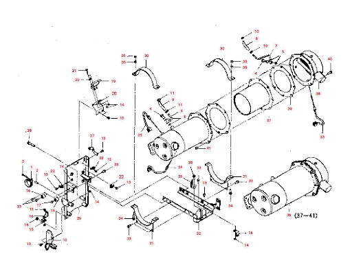

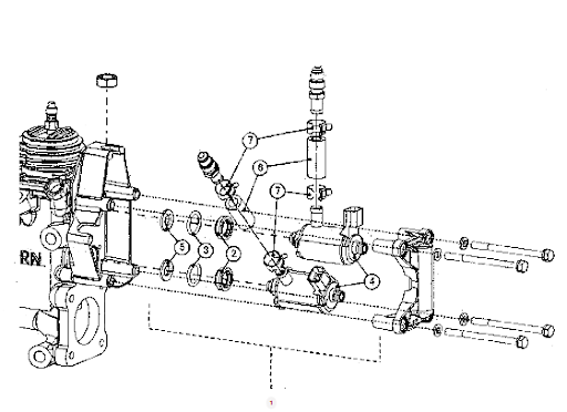

You could always inspect the burner and DPF. It shouldn't take more than a few hours depending on your skill level. My DPF (The HUGE cylinder under the hood) looked fine when I took it apart. I couldn't get the 1st filter out (Not shown in the picture below)... some people suggest that it is glued in, but the exhaust pipe leading to it wasn't too filthy and I was able to move air through it without trouble. The 2nd filter pops out easily and was very clean in my case.
Here's a breakdown of the burner (from https://parts.agcocorp.com/us/en/ap...=MF+1739E+COMPACT+TRACTOR+(AG3XXXXXXXKXXXXXX))
Injectors are #4 (x2)
Here's the DPF (from https://parts.agcocorp.com/us/en/ap...=MF+1739E+COMPACT+TRACTOR+(AG3XXXXXXXKXXXXXX))
