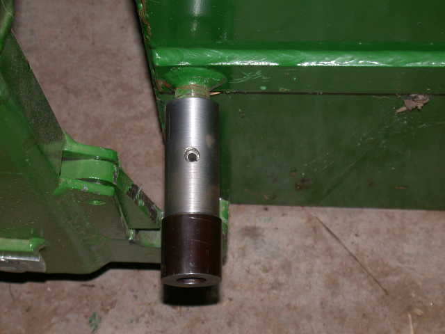

Too bad you guys don't do a little machining (I know you do Kenny). I buy DOM (drawn over mandrel) 1.5" OD and 750" ID trim it up a bit, takes about ten minutes, and I have all the bushings I need. I just saved more than twice the price of the BB to Imatch bushing on a 2' length of DOM that will make bushing for everything I own plus!
