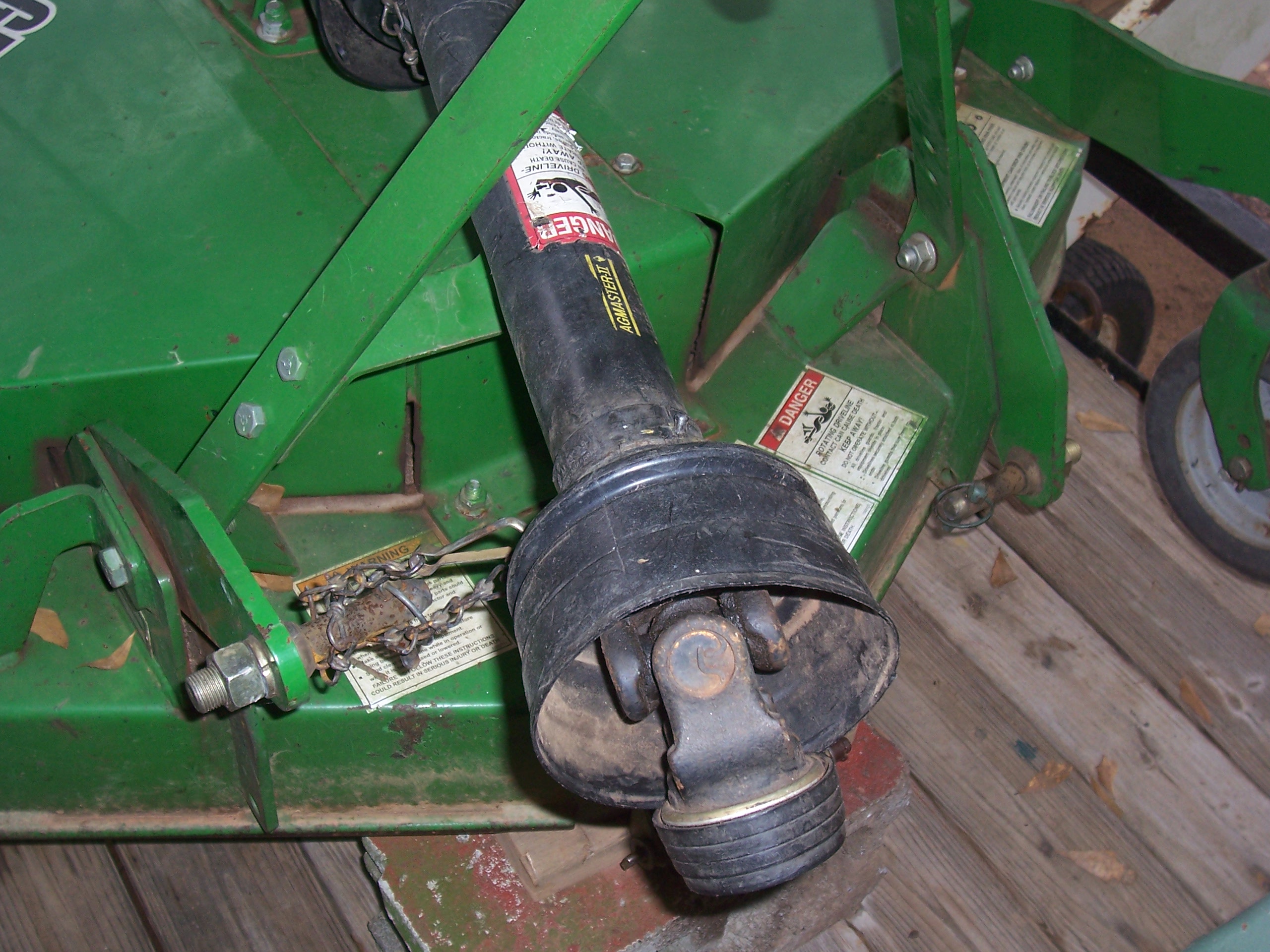

Thanks for the comments; I suspect its something very simple and I will figure it out soon. Would somebody measure your lift arms and see if they are 31" like mine? Seems unlikely they could have put type 0 arms on it, but if everyone else has 31" arms I'll know for sure that isn't the issue. Its possible these aren't bent properly, but that doesn't seem all that likely either. Maybe they just have to loosen up a little.

31" long or 28" pin to pin on my 2000. With the width of alot of pins on attachments, I've removed and turned all of them so there pointing Inwards. Never had a problem with any of my attachments doing that, But it sure does make it a lot easier to attach a Implement. The only one I haven't had to do that to was my RS1400 Tiller I had. It was the factory Yanmar Tiller for a YM2000.

Carey, that is great info; thanks for taking time to measure. I guess the narrow spread is just a characteristic of the Yanmar. I'm gonna see if the JD arms will fit.
Winston, looks like the offset arms might be made to correct this issue?
   / Just Joined the Club #35
I would ask fredericks to correct the stickers if it were me.
Also swap the pins to face inward. I have to do that on a few things. or at least on pin facing inward.
   / Just Joined the Club #36
Cary is right. I have turned my pins inward on my little 4ft Jbar bush hog and my razorback bushhog 5ft. when i use the bushhog 6ft finish mower of my uncles i have have to turn the pins in. I think there in on my box blade as well? The boom pole hooks up fine outward. And thats every thing i use on it. I have a YM2000 as well. Even when you get them over the widest point you have to worry about your arms rubbing the tires. I could hook the finish mower up by taking the arm off of the verticlal link adjuster and putting it on the pin then back on the verticle link. but then if the check chains got the slightest bit loose or in turns it would contact the rice tires on the arms. Quick inward swap took care of that problem.
