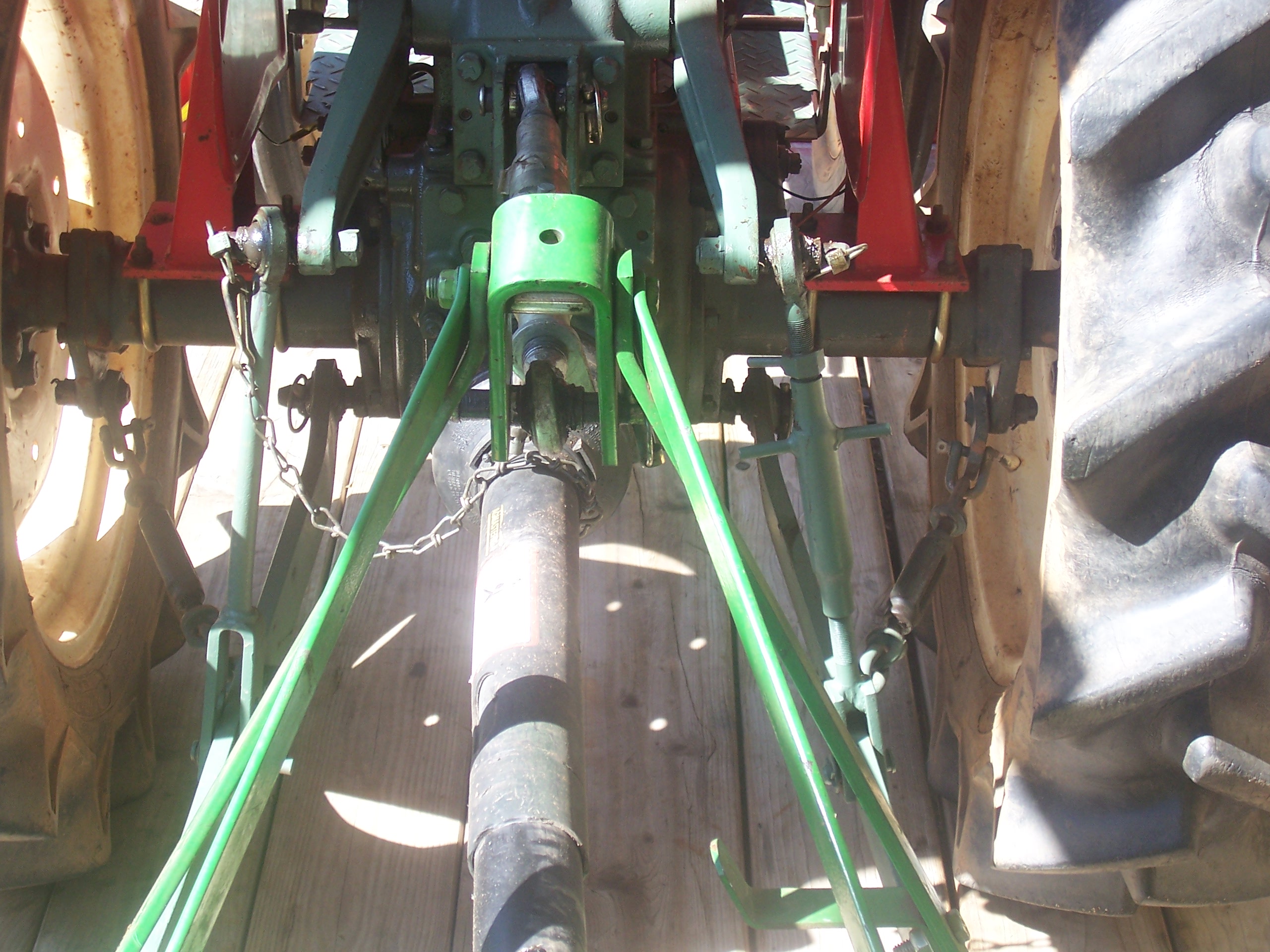

Close to my setup. My chains are just in the first holes. Been setup like this for Yrs. ;)

I was just saying that there some VN tractors with ROPS.
Anyway. My arms are just like yours came from Fredericks. I know it will work. that verticle piece is what i have to disconnect on wide things to get the lift arms on. I just move the pins though. as if its too wide the arms hit the tires anyway. You will probably give up several hundred pounds of lift like you have yours set now? at least 100#
   / Just Joined the Club #55
you can move them around to gain lift power etc, thats why there more than one hole for each thing.

My YM240 is all original and its set up like Corey's. Photo. The sway chains aren't long enough to go back and use the second holes.
And here's an old thread about the same as this present one.
That's interesting. My chains are too long to fit the first hole unless I leave out a link. You guys have yours set up just like in the Hoye link that Daniel provided. I will leave out a chain link and switch places with the chain and leveler and see how it works. No doubt that as Clemson pointed out I am losing some lifting power the way I have it now. But it gives a lot more range of movement up and down and makes the 3 point adjustment much more sensitive. Using the 2nd hole will give me back a little lifting power and should still keep it easy to hook up the equipment.
But I hope I don't have to ever use that last hole for anything. The leveler just wasn't designed to be at that much of an angle and it kept it in a constant bind. I literally spent 30 minutes trying to hook up that disc when I bought it. It was on unlevel ground, and even though I unhitched both of the lift arm levelers, I had to hammer and beat on the thing to ever get it to all go into place. Then I had almost no range of motion when picking up and lowering the disc. Apparently, they have used different levelers and chains over the years and what works ok on one tractor may not work well on another.
Thanks for all the help!

Yea i lost part of my check chain of the original and had to order one from HOye. It has more length i think but still tightens up.
I also thing i moved my vertical stabilizers back one hole but this was only a few inchas inward not behind the chains like yours.
