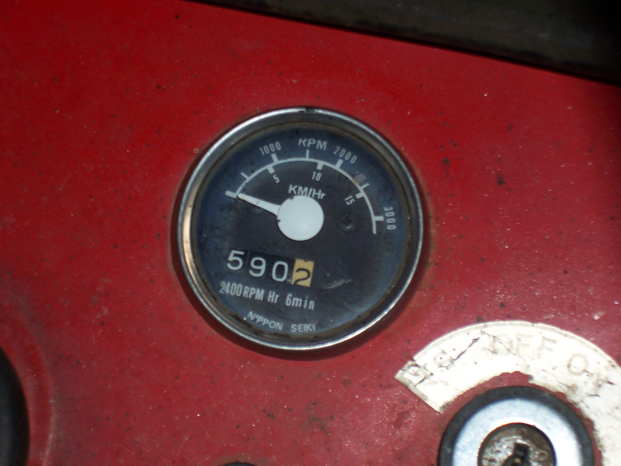

My ym2000 has a tick for 540 at 2400 I thought also says hp rating at 2400 rpm.
California does your 240 rate HP at 2200?
   / Just Joined the Club #85
Wow! has my Tach Hrs. slowed since I can run 2nd. gear PTO. I was Shocked I haven't hit 600 yet. And the Gray colored Square is there marking 2400. I thought it had one but I never can see it in direct sunlight. I had to mark with a scratch the chrome when I started using 2nd. I know now to Run it at the 10 and that should be 1750-1800rpms just to the Right of it.

Coosa, does your tach have a tic mark at 2200 as shown in the diagram above, or one at 2400? Anybody else with a 2210 - what do you see?
There is no tic mark anywhere on my tach. I tried it at 2400 and it seemed like the cutter was really turning 540. But that is just eyeballing it and I wouldn't claim to be a good guesser.
