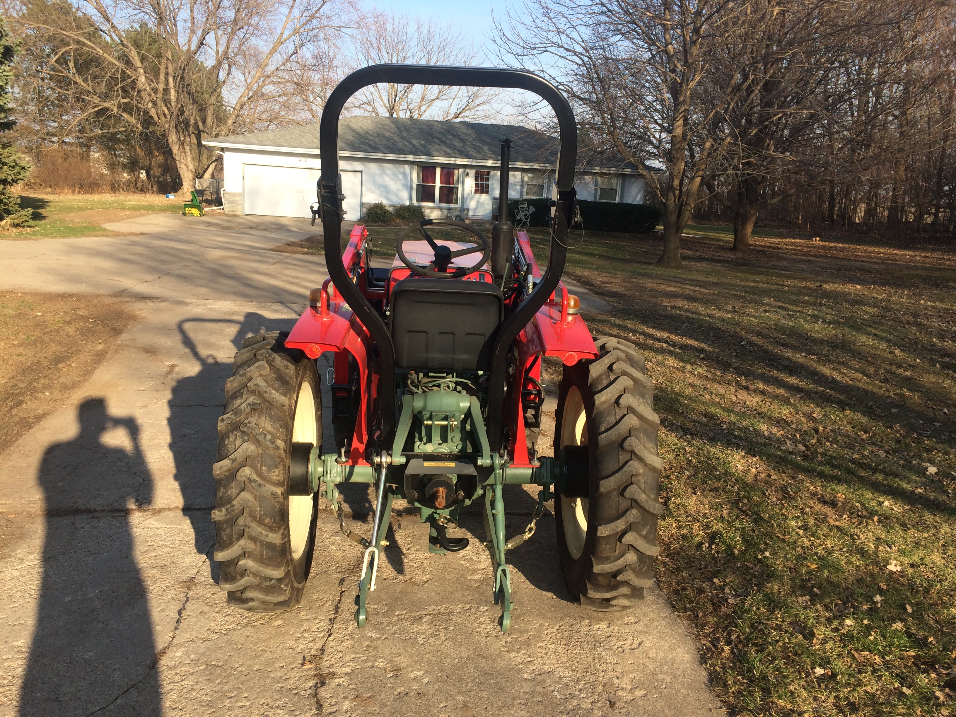

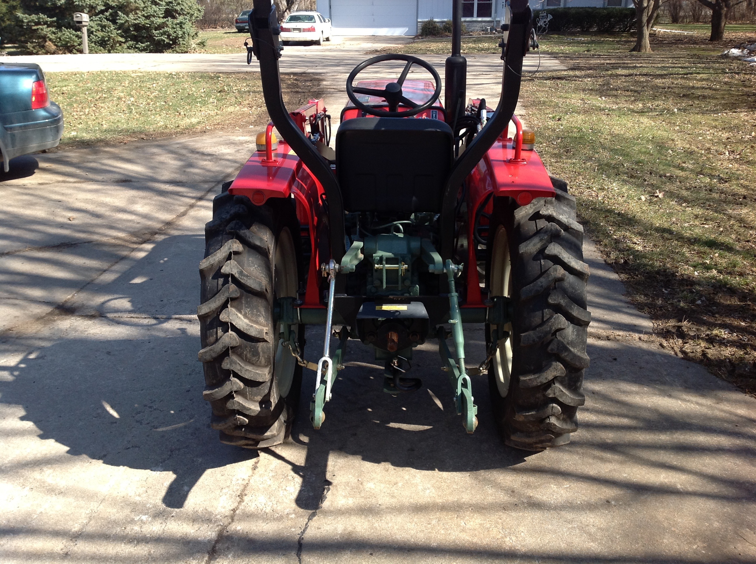

You might be interested to look into Hoye tractors spacers. They have them custom designed and machined. They will add 8"s to the stance of the tractors. Which will do way more than filled ng the tires ever will. A few members here have them . JTullis is one, I don't remember the others. I am going to order a set myself soon.
I did purchase the wheel spacers from Hoye for my 2210d, and it made a huge difference in stability. If you are mowing over any uneven terrain they are well worth it. I now have turf tires on mine, but have put on my R1s here and there depending on what I am doing. I will post a few pics of the spacers on the tractor.
As for filling your tires, I know a lot of guys that use anything from windshield washer fluid to antifreeze. They might be able to tell you how much weight it adds. I have RimGuard in my R1s and my Turfs, that added 182 pounds per R1 tire and made a big difference for me when I am tilling and using my rear blade. I like RimGuard because it adds the most weight per volume, non-toxic and biodegradable.
you can compare the pictures of before and after wheel spacers, they add 4 inches per side. If you don't want to spend the money on them you can always flip your rears to give you a little more width.
View attachment 601531View attachment 601532

I really like the look of those spacers. I bet those go a long way to improve stability with the extra 8 inches of width they provide. I think I will go that route through Hoye and also order up a ROPS as an added safety in case I would ever flip it. Looks to be a very well made little tractor that will enable me to get into spots that I can't with my bigger tractor. I have everything now to do a complete fluid and filter change this weekend as well as flush the cooling system. Spring finally decided to show up here, so I need to have it ready now to do some playing....I mean work:dance1:
   / Just joined the grey market Yanmar club #26
They are a good little tractor. I have hesitated in the spacers for the reason you state. It's compact width allows you to access areas easier than a larger tractor. The spacers now make the tractor wider increasing the area needed for clearance. But if that 8"s does not make a difference they won't matter. To me, the added benefit of being wider will probably outweigh any benefit that I am probably just making up in my head that I need the current narrower width for.
