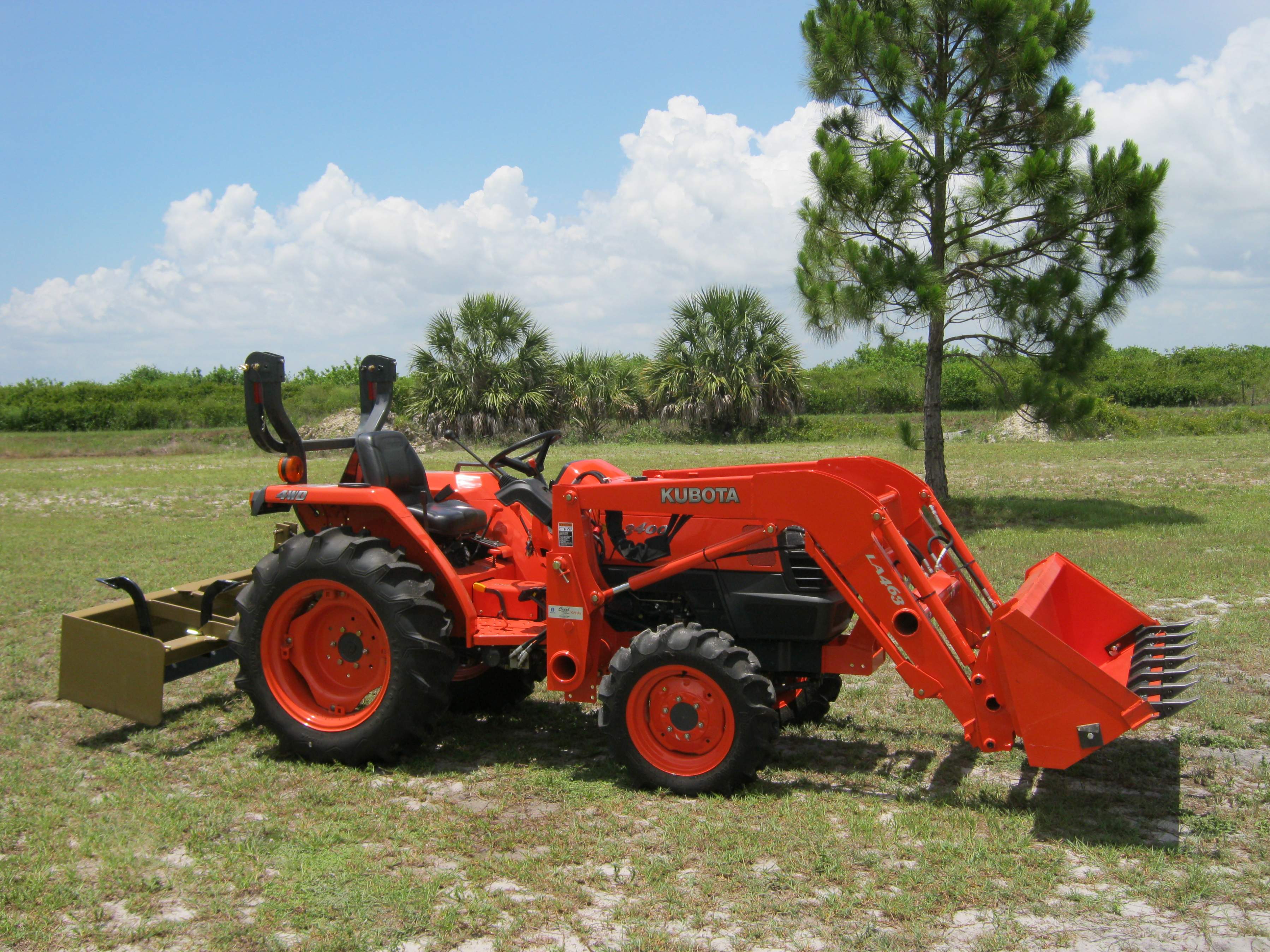

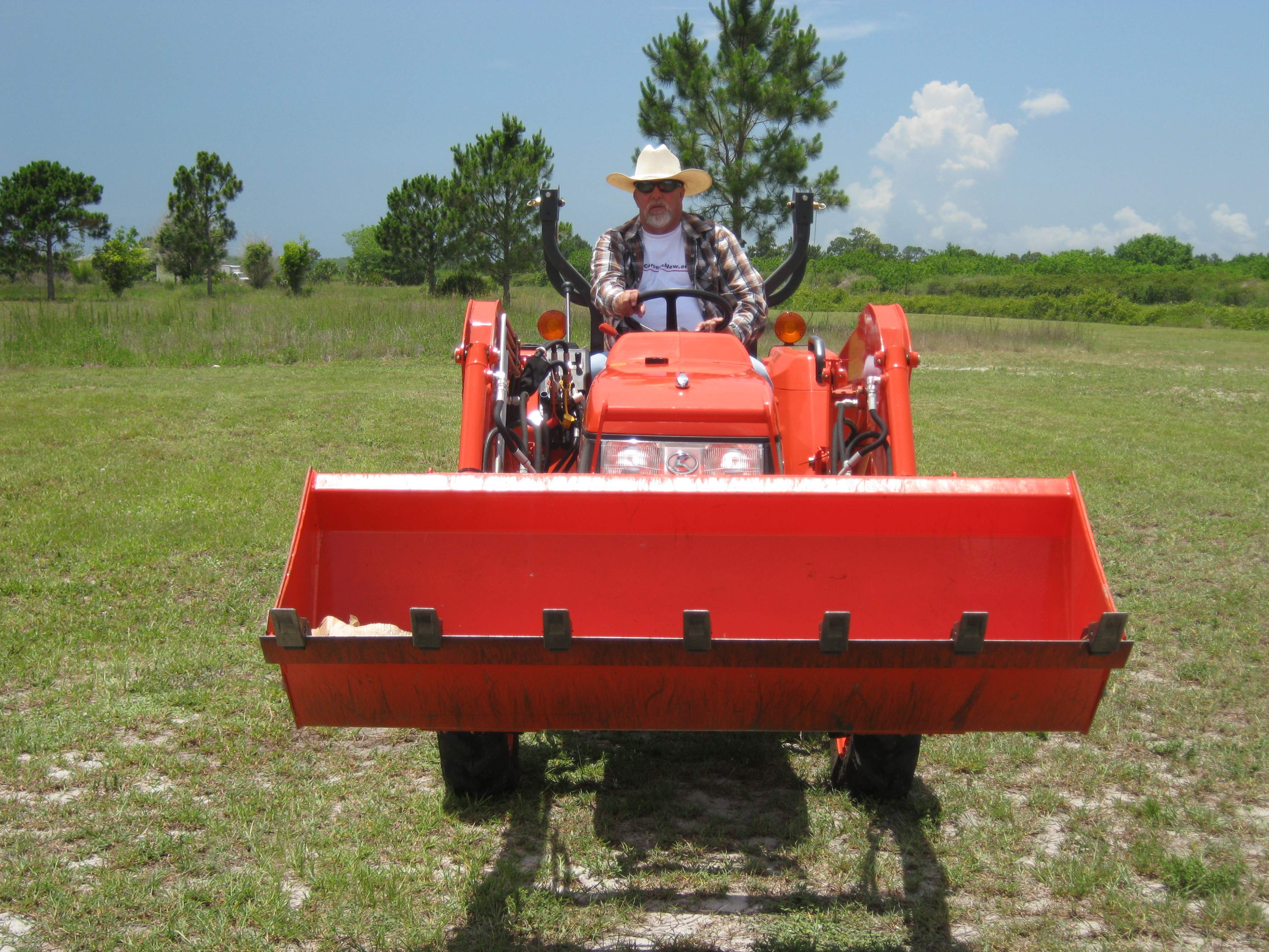

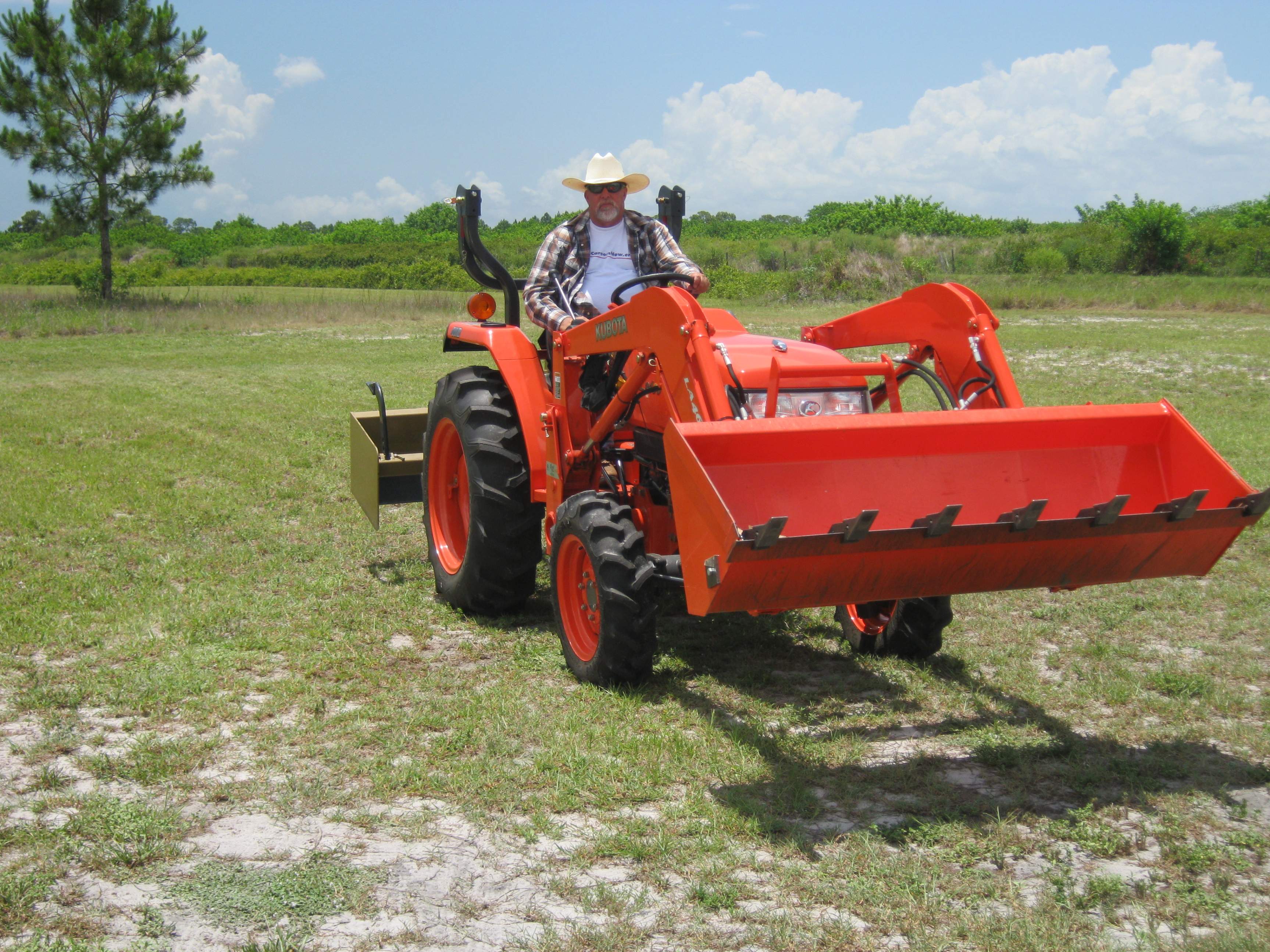

:thumbsup:Congrats, heres a couple pics of my original MKHM toothbar.(some taken from far away) 2007 L3400DT Bota

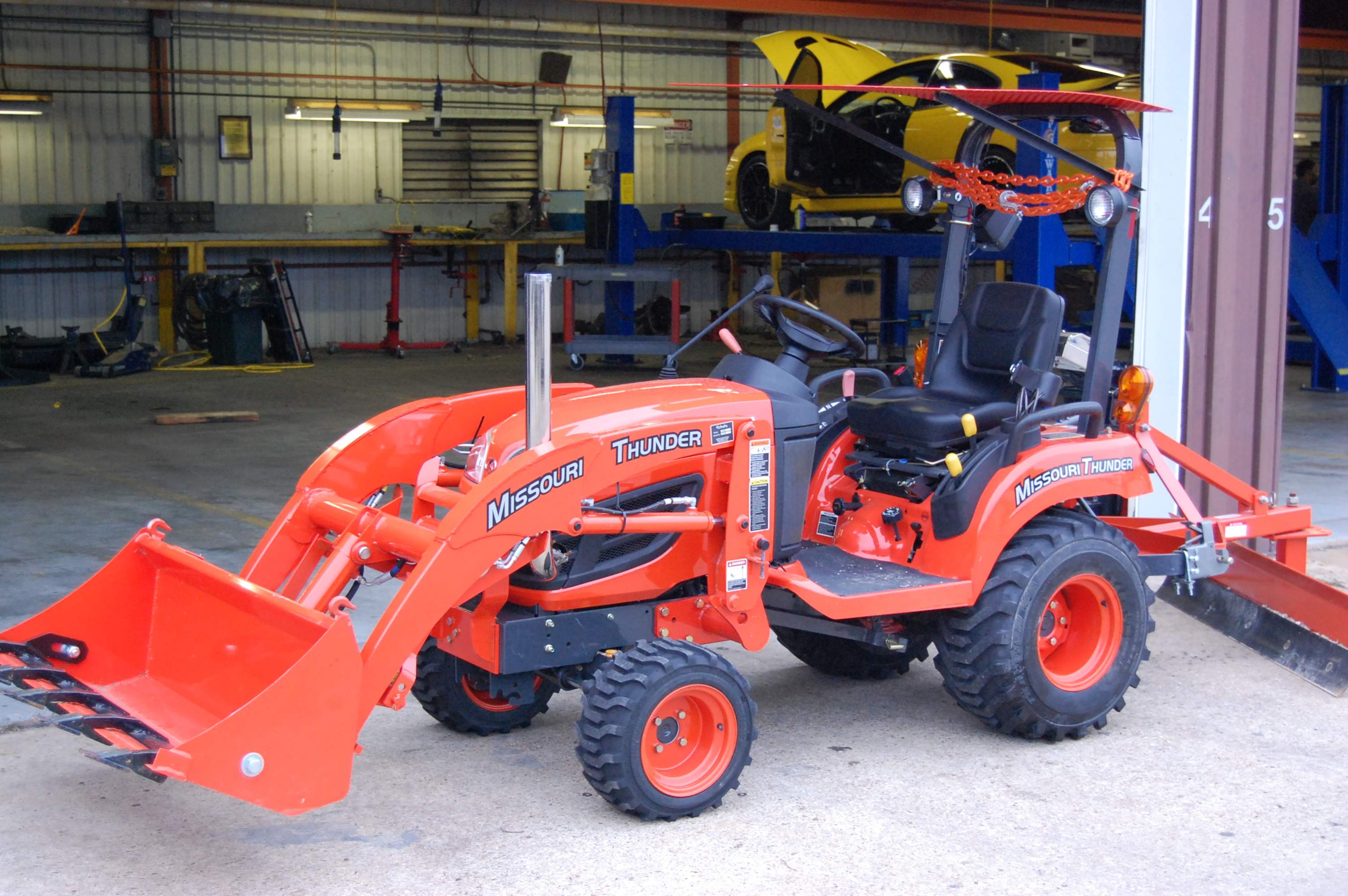

MT
/ Just ordered my first attachment......
MT:
I don't know how I missed hearing about Kubota's special and limited-time MOUNTAIN THUNDER edition tractor/loader package! Those are fantastic graphics. Nicely done.
