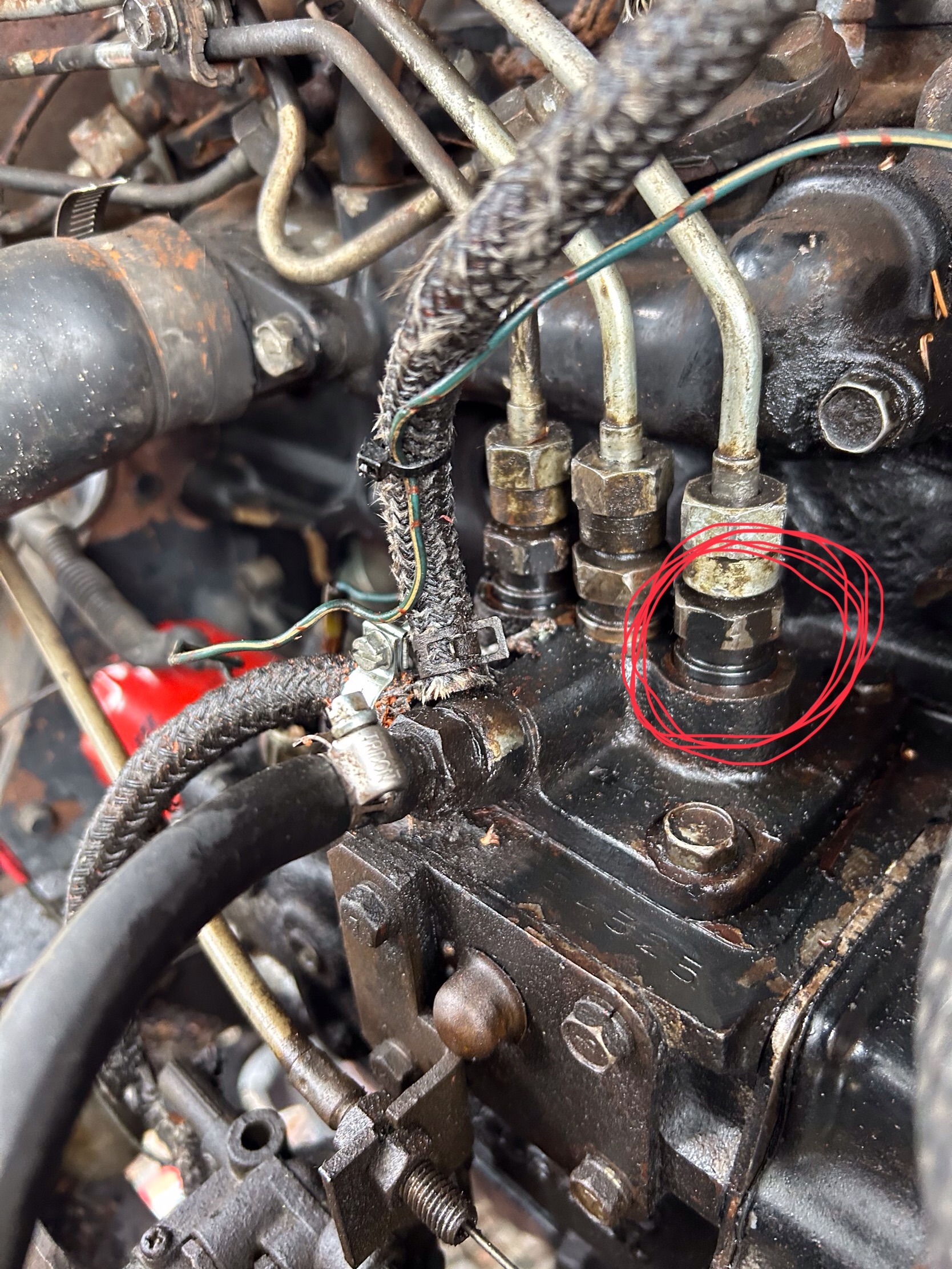

Im tring to find a place to buy some parts this engine it’s a K3B I believe . I live in ontario canada . Any leads in which this engine was in so i can find a dealer and give them a part number would be great .
Im missing a couple parts from within this pump. There is a spring a small what looked like brass cap on top of the spring .
Also i assume its just a thread in to installed them and connect the fuel line and bleed ?

I’m confused..
Your title says PUMP but your description says INJECTORS..
The injectors are in the head, at the other end of the steel lines from the pump..
If your asking about the guts in the pump.?? You’ll have a better chance in buying a whole unit..

Thank u, it makes much more sense now..
Look to the left side of the inlet bolt, down towards the bottom mounting flange..
There might be a set of 5 numbers.. post them.
If they aren’t there, look at the left SIDE of the pump mounting flange.. there might be a name plate..
DO NOT SCRAPE IT.!!
& most cleaners will wipe the numbers clean off..
Take a good pic and post it.
All your missing is the delivery valve spring and dv gasket..I’m most certain there is an oring that goes on the dv holder..(threaded piece)

Hi, I have a ih 234 with the K3B engine in it. I have the same problem. mine was leaking externally from the same fitting, it's for # 1 cylinder. I bought the 3 Orings from messicks tractor,online. I installed em, now it won't run and is dumping loads of fuel into #1 & # 2 and NONE comes out of # 3 now. I don't recommend replacing them yourself. mine also had all 3 copper gaskets missing that goes under the springs, I bought those, they call them gaskets. plz PM me if you find the cure for yours. looks like I may have to get mine repaired or rebuilt
