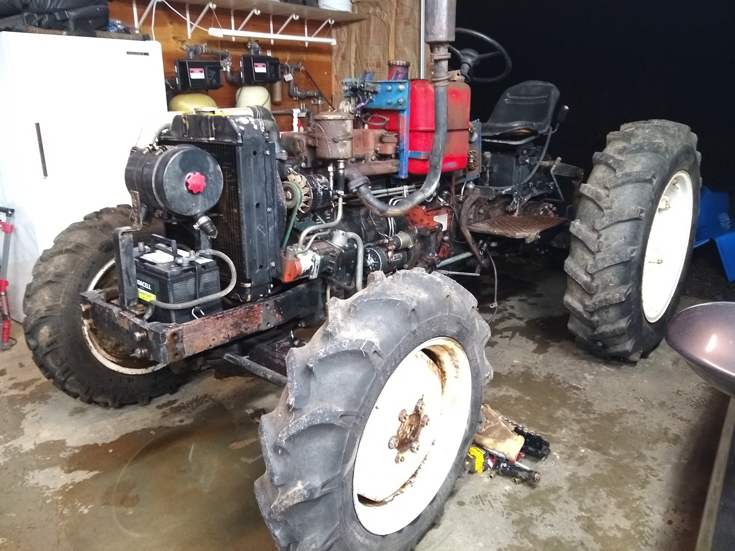

Here it is stripped of cosmetic and safety parts.
Not sure what to do next. It's still in running driving order.
Is there anything that would be better to do now before removing wheels and hydraulics?

What I would do is relocate that air cleaner. One of the Chinese tractor dealers makes a battery relocation kit. All of that stuff in front of the radiator doesn't help it. Another thing is to make a mounting in front of the radiator for a furnace filter, or furnace filter media.

Yeah, sounds like yours was pretty rough. I'm surprised how easy everything is coming apart. Being chinese made, you'd expect minimal rust protection, But there is only surface rust and all bolts are still good, minimal rust. No stripped or broken bolts yet.
The FEL is Canadian made with US made hoses. They still look good. Cylinders are good with no leaks. Not sure if it makes sense to replace the hoses as preventative maintenance or not.
All the chinese made hoses need replaced.
Where do they get relocated to?
   / Kama KM554 rebuild and upgrades #18
I don't remember. In fact I don't remember which dealer it was (geez!) It was one of these two. Contact them.
   / Kama KM554 rebuild and upgrades #19
While it's still running take it outside and do another washdown - maybe some simple green spray first then wash / scrub the remaining dirt and oil residue off before you disconnect any hydraulic lines or wire terminations - you want it clean as possible then ziplock bag and tie the loose parts bolts/o-rings to the ends of the hyd lines to keep them sorted and clean.
Why do you need to remove the Hyd lines - do you intend on painting the frame/engine red? It might be easier painting the red parts black and touching up the rest of the frame.
If the hyd hoses on the loader are not cracked or aged leave them as is - but get some caps to thread on the connections before sanding and painting. Take lots of pics and mark or number the lines LH Lift, RH Lift etc.
On the wheel's and tires, are the rear's loaded with calcium? Are you changing the color of the wheels? Maybe leave the wheels last to be done so you can roll it around. I did the wheels last and had the new tires put on the newly painted rims and after painting the frame bits.
I like the suggestion for a sliding pre-screen filter for the radiator like this or make your own, but I would think the air filter location is not a huge deal where it is, especially if it runs cool now. Radiator Screen | All Equipment Accessories | Equipment Accessories | Genuine Parts | John Deere products | JohnDeereStore
