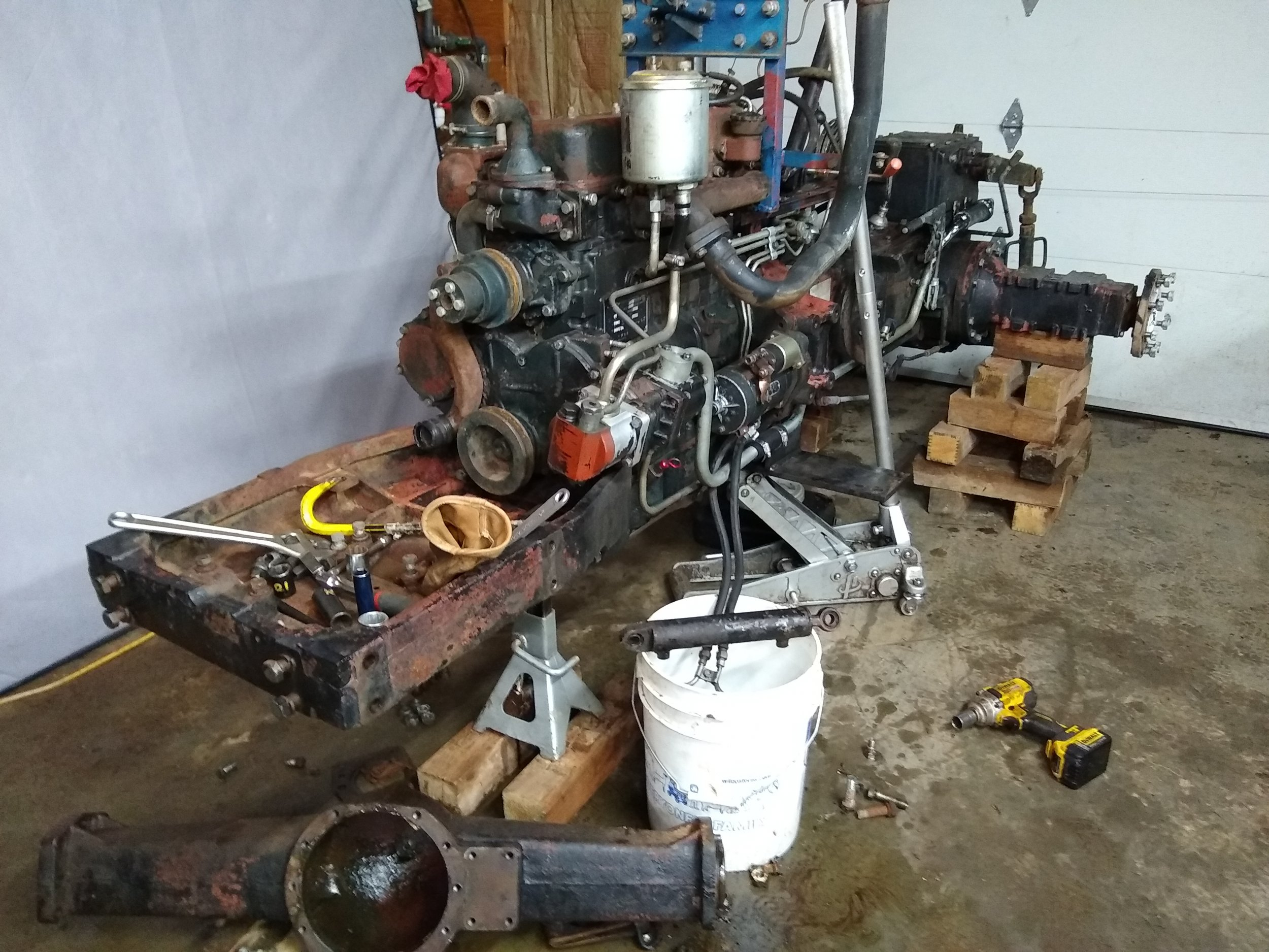

#27
Neked
Working now.

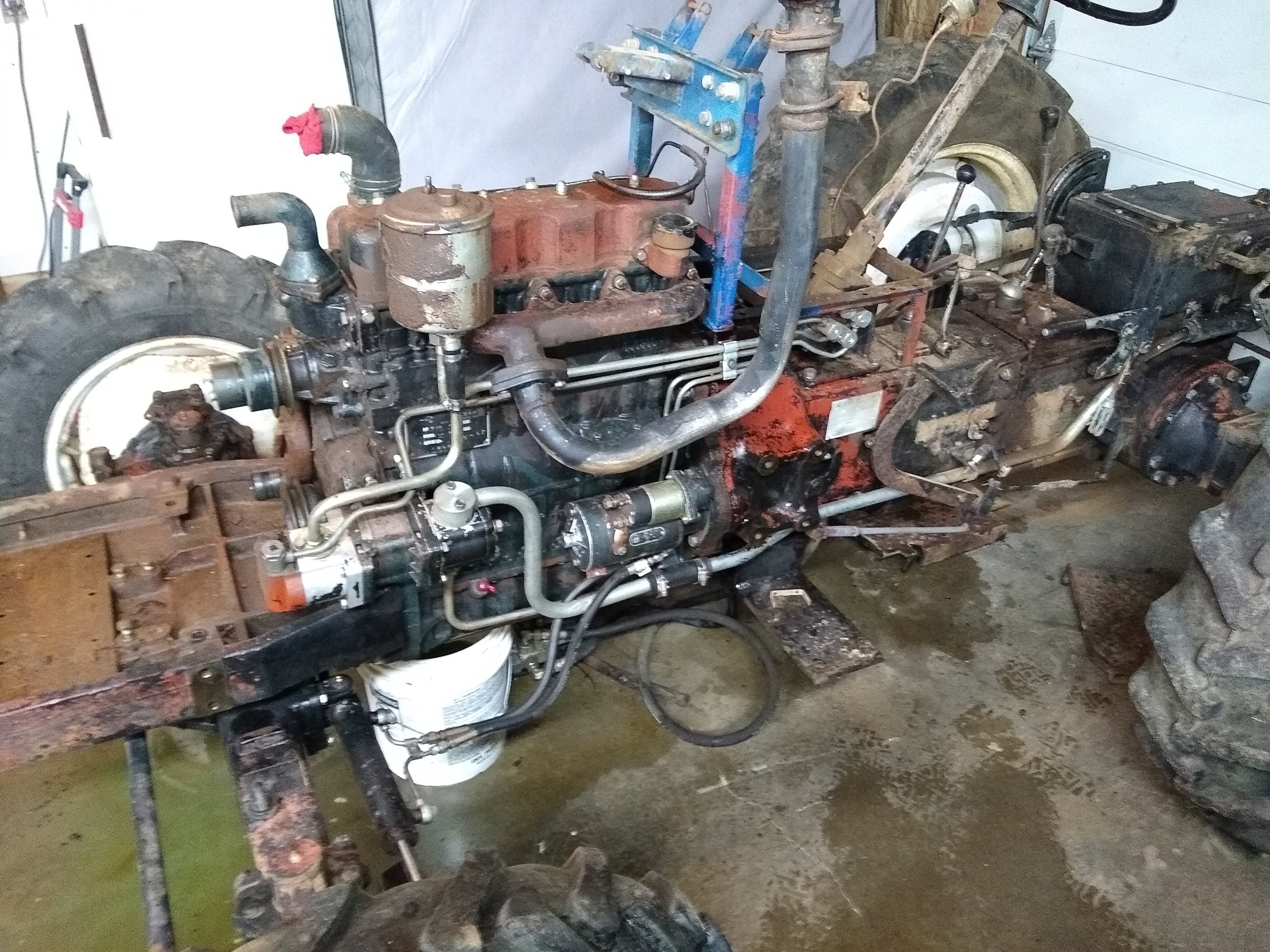

Stripped all the way down and ready for bath.
I jacked the front up to swap tires around and found right front hub has about a 1/2 inch play. Can't be good.
   / Kama KM554 rebuild and upgrades #28
You've been busy - right at it! Sorry about that, sounds like a R&R of the RF axle/pinion gear - was it leaking oil?

Yes, it was leaking. I have the next couple days off so I will tear into it tomorrow.

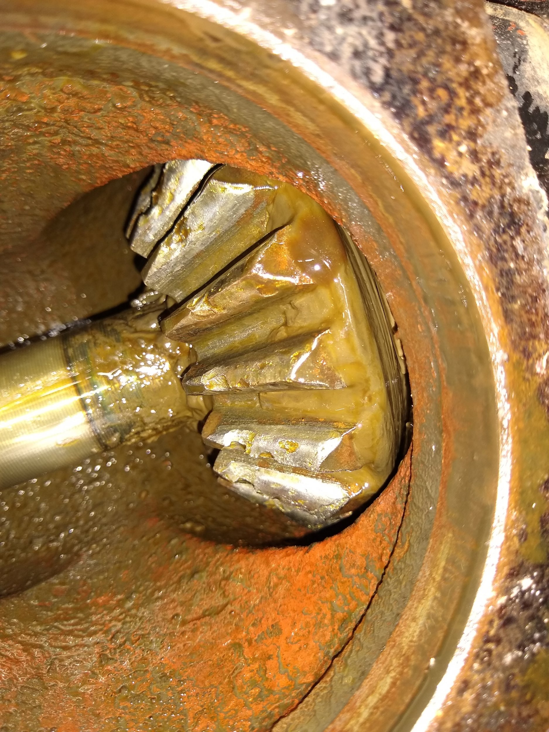

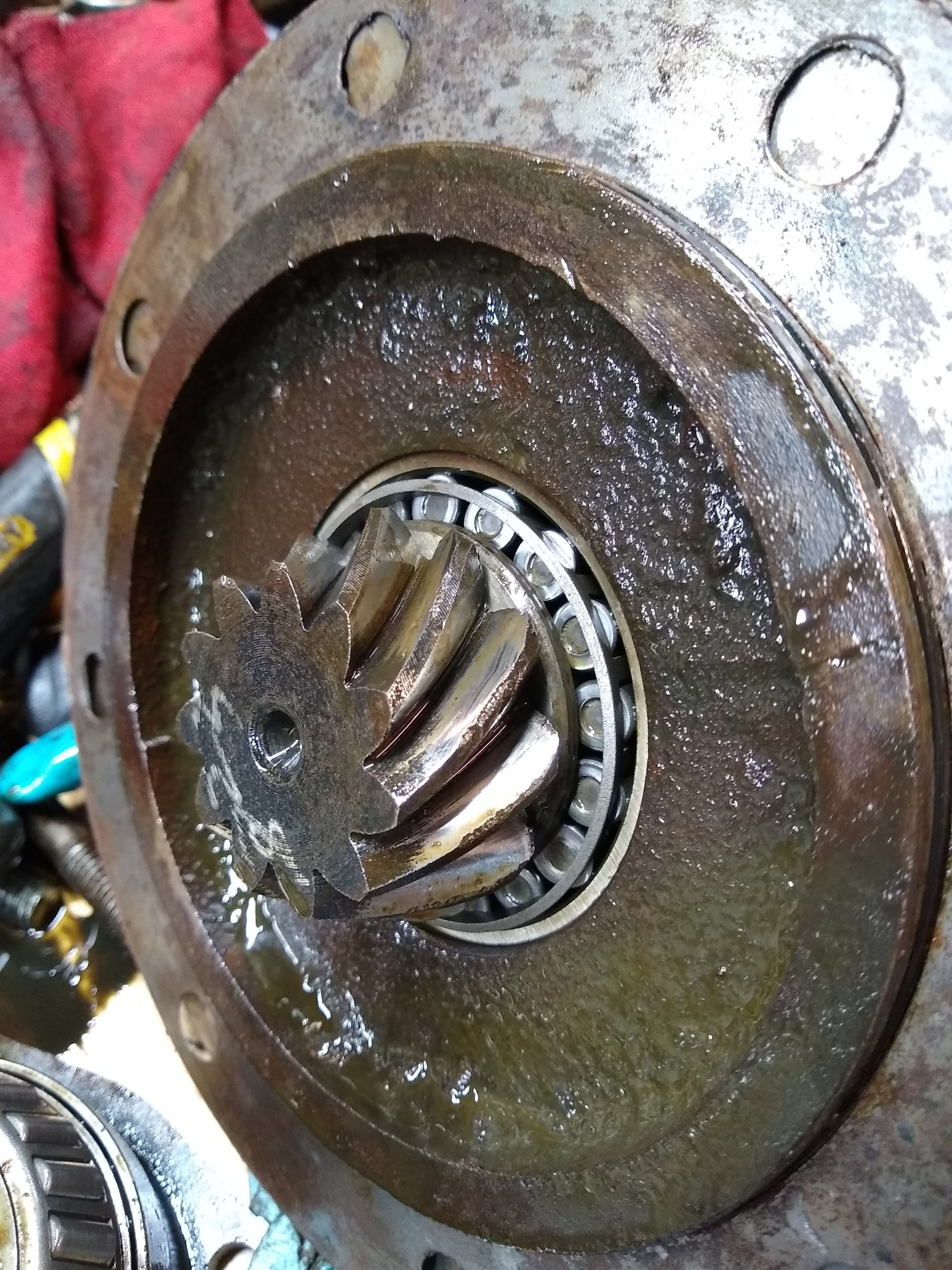

#30
Stripped down
R&R front diff and hubs etc,

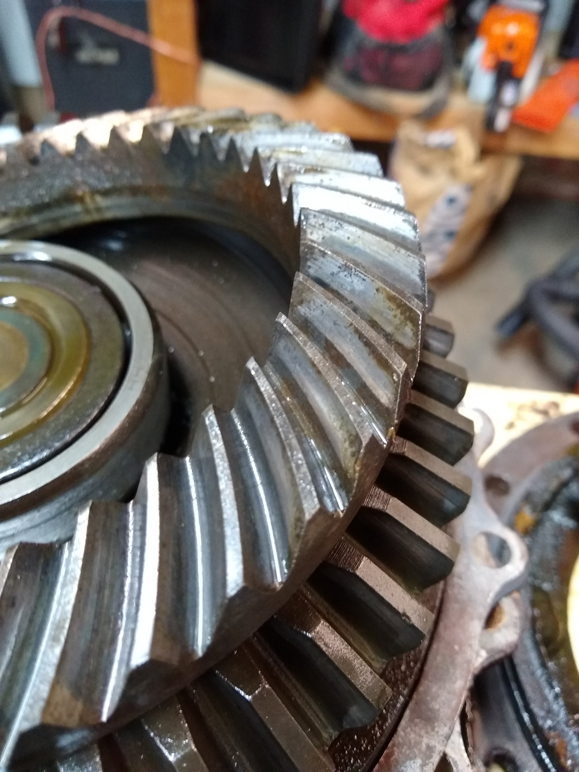

Front diff is good except a thrust washer that is worn and split.
Diff is super sloppy but I guess this is normal for tractors. Gear wear is minimal except the pinion has some wear. I had worked on a couple truck and car diffs but never a tractor, so maybe the backlash is normal for a chinese tractor?

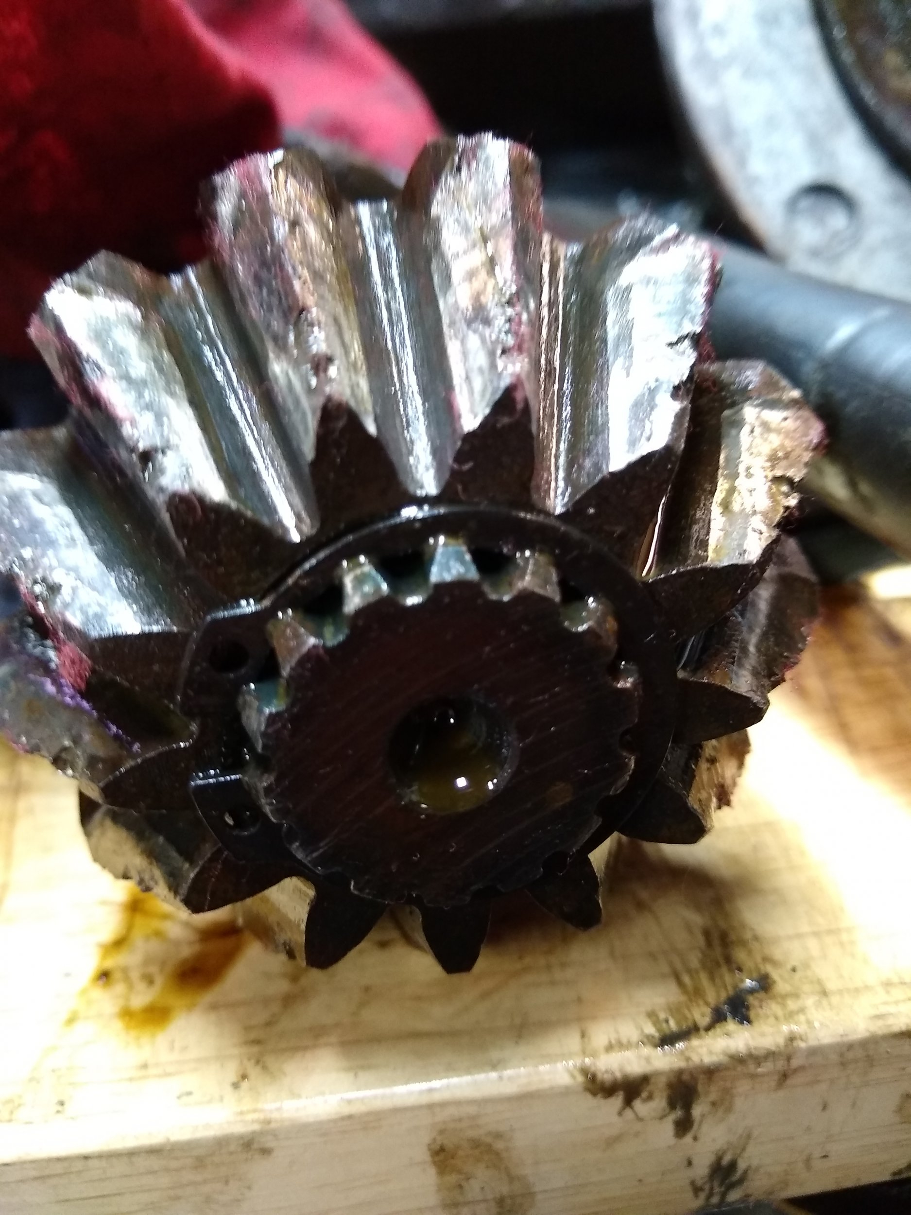

And carnage. Upper bevel gears in both hubs are trashed. Probably my fault for not keeping the oil level high enough to lube. The lowers look fine.
