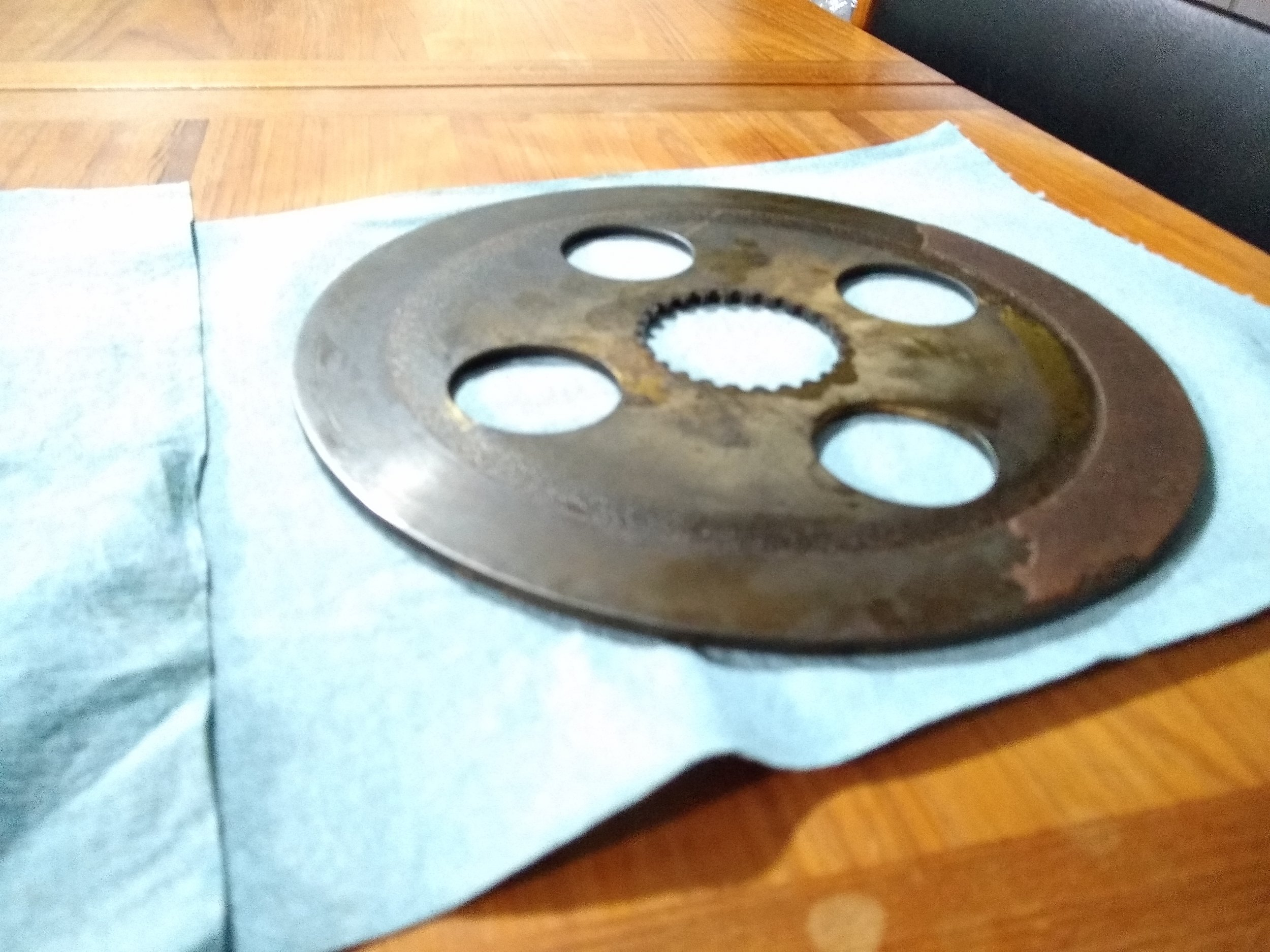

I think it needs some new brakes!
I knew this going in, as this is one of the main reasons to tear down. Brakes were always poor. Previous owner wore them out I guess.
I can order them, but wondering if they are same as other tractor. Any idea?

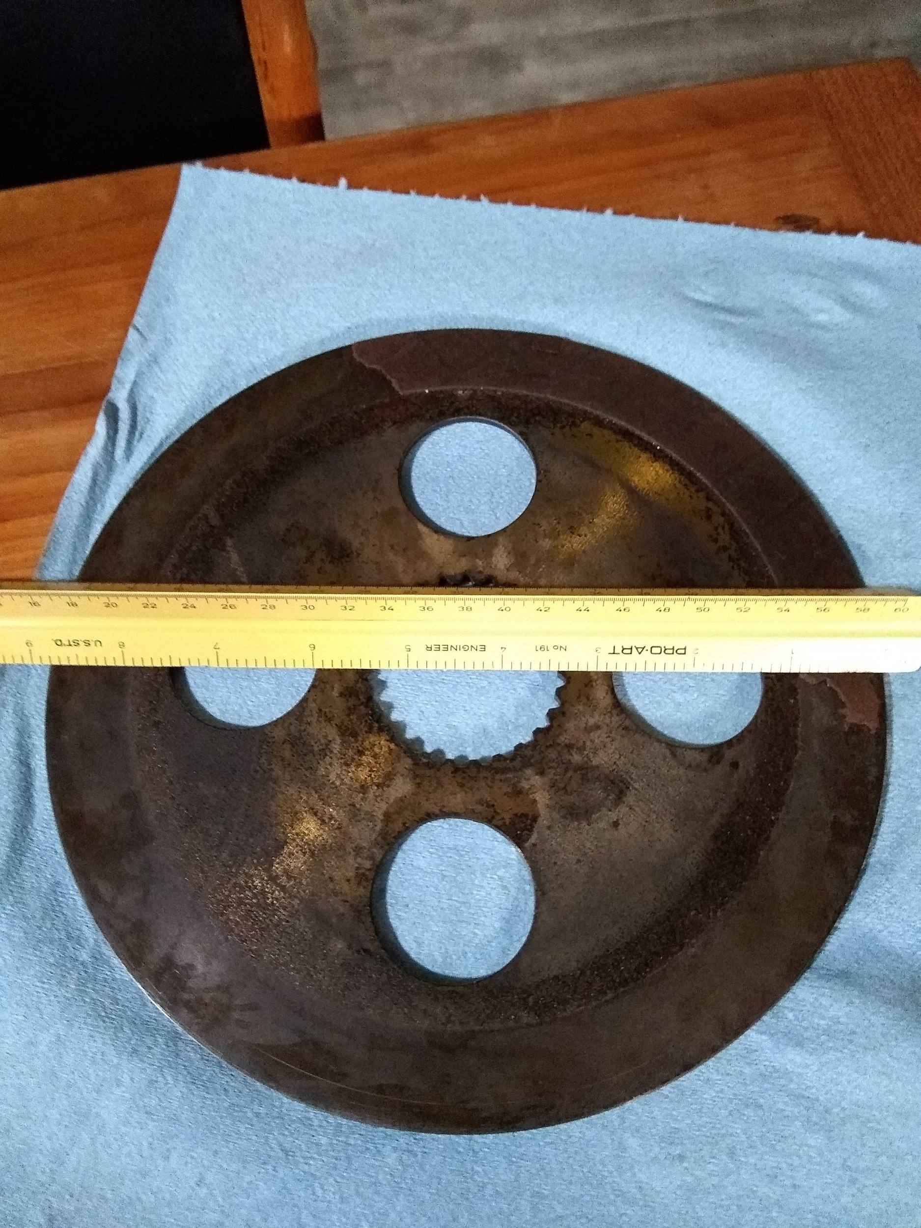

#35
8.8- 8.825" OD
26 spline
.875" friction width

Tractor Supply has replacement disks but none appear to be 26 spline, then yesterday's tractors has some too Ford Brake Disc for Ford 3550,4000,4200,4500 - C5NN2A097B This is the closest spline wise.. Oliver Brake Disc for Oliver Super 55,66,Super 66,550,660,White 2-44 - 106690A
IMO if you can get the Kama disc for a reasonable cost ($60-80 ea) that would be the best, as most discs are going to be at least $30-40 ea and may or may not fit exactly.
Thanks for looking Carl.
The place I normally get parts is not responding. Probably taking some holiday time off.
I also emailed Artrac. Asked if they still carry Kama parts. They haven't responded yet.
I emailed a relining place to see if that's an option.

Yea - relining is what I thought too might be the best bet - are these wet brakes in oil? Probably makes a difference in relining adhesive/approach.
   / Kama KM554 rebuild and upgrades
#39
Yes. Wet.
   / Kama KM554 rebuild and upgrades #40
Here are several articles on relining brakes: Yes you can bond on new pads with epoxy and pressure and or rivets (the most common) if you don't mind drilling your rotors for the rivets. Brakes in HST tractors don't get much use, but in gear tractors and farming applications the brakes are used for stopping and "brake turning" stopping one wheel to swivel the tractor into the next row. I did this a lot on the farm when plowing.
IMO, if seems like any material will work, even leather!, so sum and substance you can probably find brake pad materials, cut it to fit, then bond and rivet this on your tractor for less than $30-40 total.
